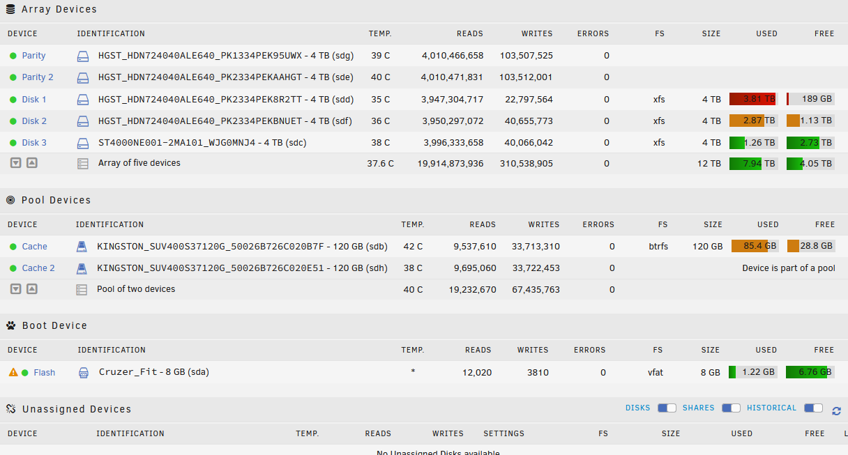

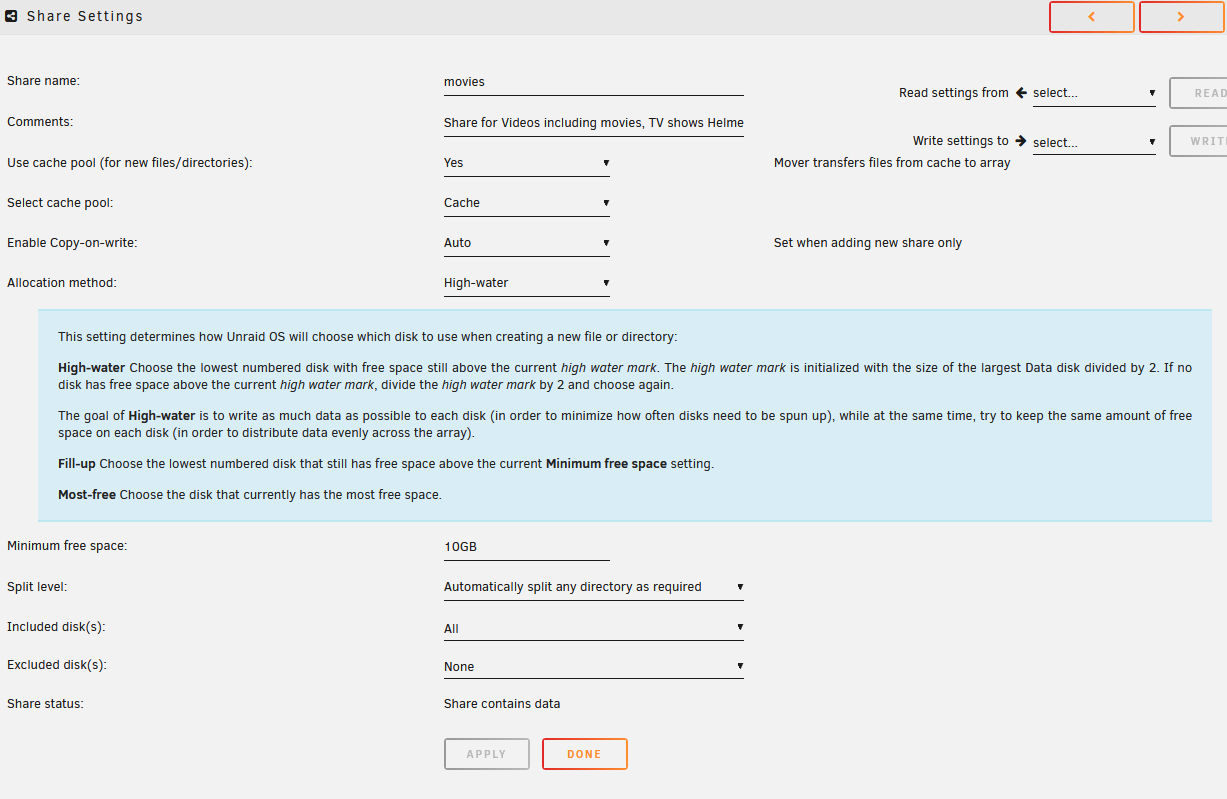

  1. Hi everyone, I did some searching the forums and reading the help files on the UI and can't find a reason for this behaviour on my array. Basically, Disk 1 is going to fill up while there is a lot of room left on the other two disks. See below for how my array is set up: Now I have had this array going since 2017, so I haven't been in an fiddled share settings for five or six years, but from my reading of the share settings the data should be getting written to disk 3 in preference to disk 1 and 2 (Disk 3 is the only one with space above the high water mark). All of my shares are set up along these lines: I have double checked and no shares are forcing the use of Disk 1. Thanks very much, Tom
