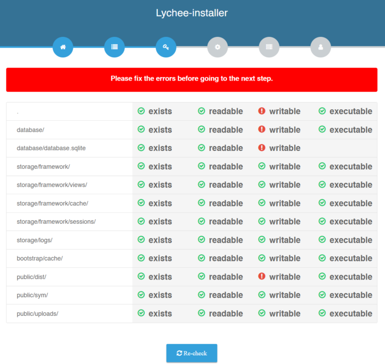

  • Hey i got problems with permissions with lychee installer.   i stuck on part 3 and i dont know where the folders are.
  • I went back to 4.8.1.
  • shpitz461
    shpitz461
    Bingo, 4.8.1 works for me as well, thanks!

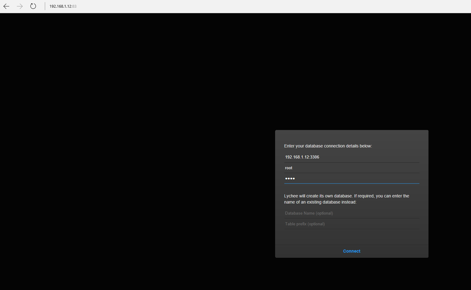

Having the same issue as montery...can't connect Lychee to MariaDB.
Steps taken:
1. Installed MariaDB docker. Set port to 3306
2. Install Lychee docker. Set port to 83
3. Navigated to lan ip :83 and entered in the info found in Img_1 (attached)
All I see though is an error message saying Lychee can't connect (see Img_2 attached).
I clicked on the logs on each, and they both don't seem to show any errors. I've attached both of the log files.
What am I missing? User permissions?
LOGS:
lychee_logs.txt
mariadb_logs.txt
Edit: After thinking about this, I'm feeling that Lychee the docker doesn't have access to MariaDB the docker. I'm new to all this, but that would make sense to me because I didn't set any permissions up between the two. I'm not sure how to add those permissions, but is that a valid thought? I need to add permission for Lychee to talk to MariaDB?
Edit 2: After a couple restarts, it finally starting working. Not sure what the issue was.
