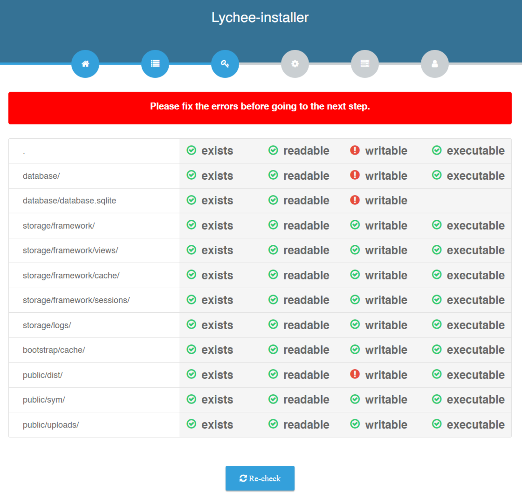

  • Hey i got problems with permissions with lychee installer.   i stuck on part 3 and i dont know where the folders are.

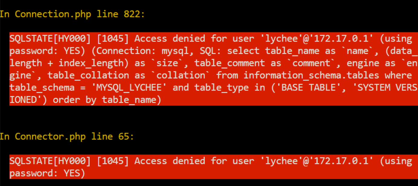

Hi. I try to install Lychee. Bu I have some problems.
On the WebUI I see the following error:
and thats the log file:
my user lychee has not the necessary rights. But how to solve the problem. Can someone help?
Are you using an external sql db?
172.17.0.1 is your mysql/mariadb container?
Did you create a db and user for lychee in mysql/mariadb?
If not, open a console to mariadb from the docker tab and then issue the following commands:
mysql -u root -p
CREATE USER '<USR>' IDENTIFIED by '<PWD>';
CREATE DATABASE IF NOT EXISTS <DB>;
GRANT ALL PRIVILEGES ON <DB>.* TO '<USR>' IDENTIFIED BY '<PWD>';
You can use adminer container to connect to mariadb and check the db and user.

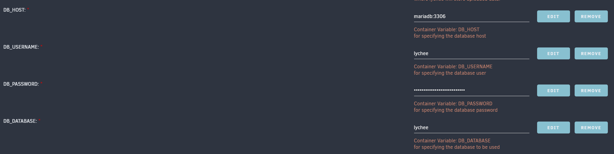

Here's my db config for the container:
Edited by shpitz461

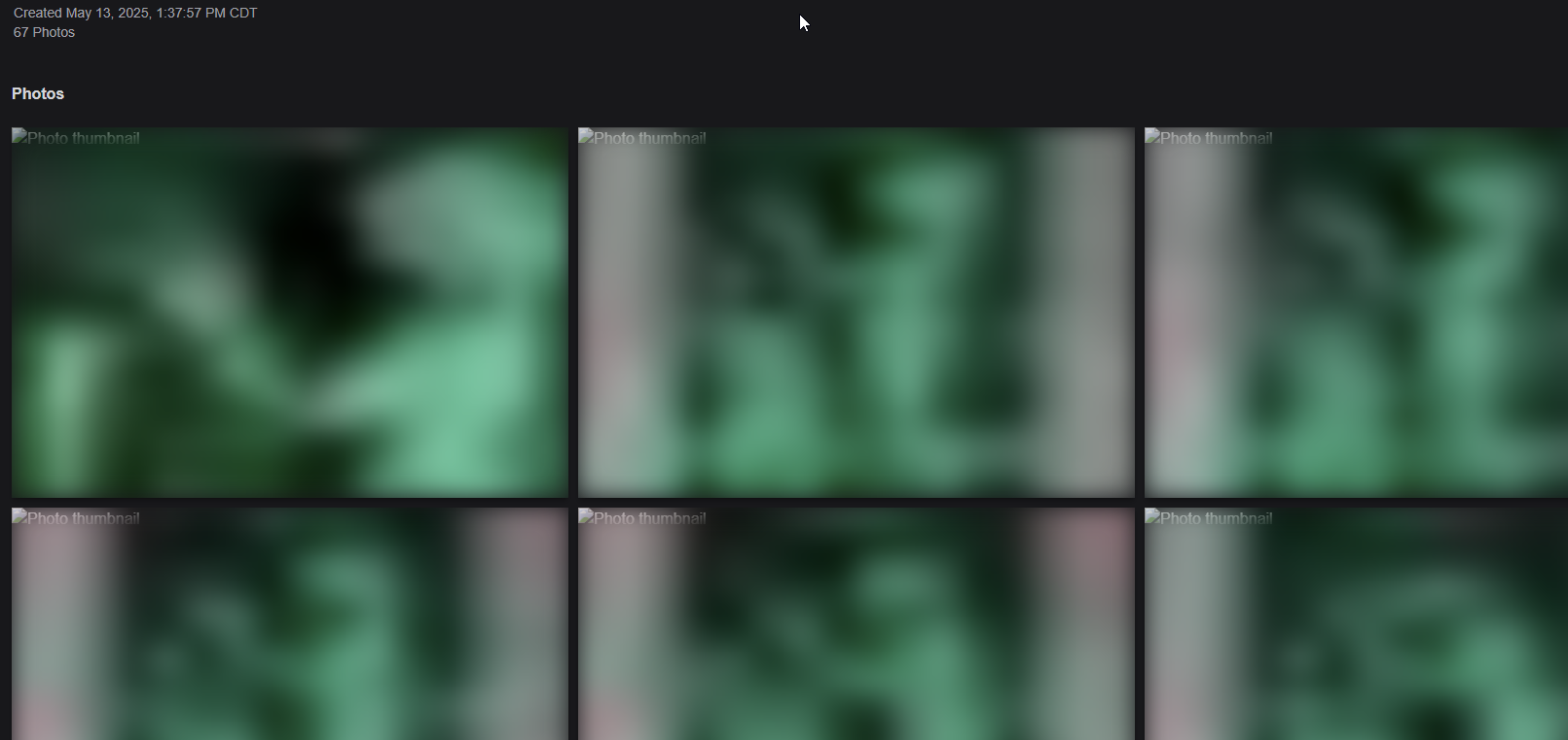

I've had a weird issue where updating the docker has broken all of the links to the images, they just show a blurred background and the universal broken IMG icon.
Has anyone experienced this or know of a way to resolve this? I installed a fresh version that im keeping version locked while I try to figure this out, i dont necessairly a year down the line want to be running out of date code but I can't have it breaking every other update either, any ideas?
