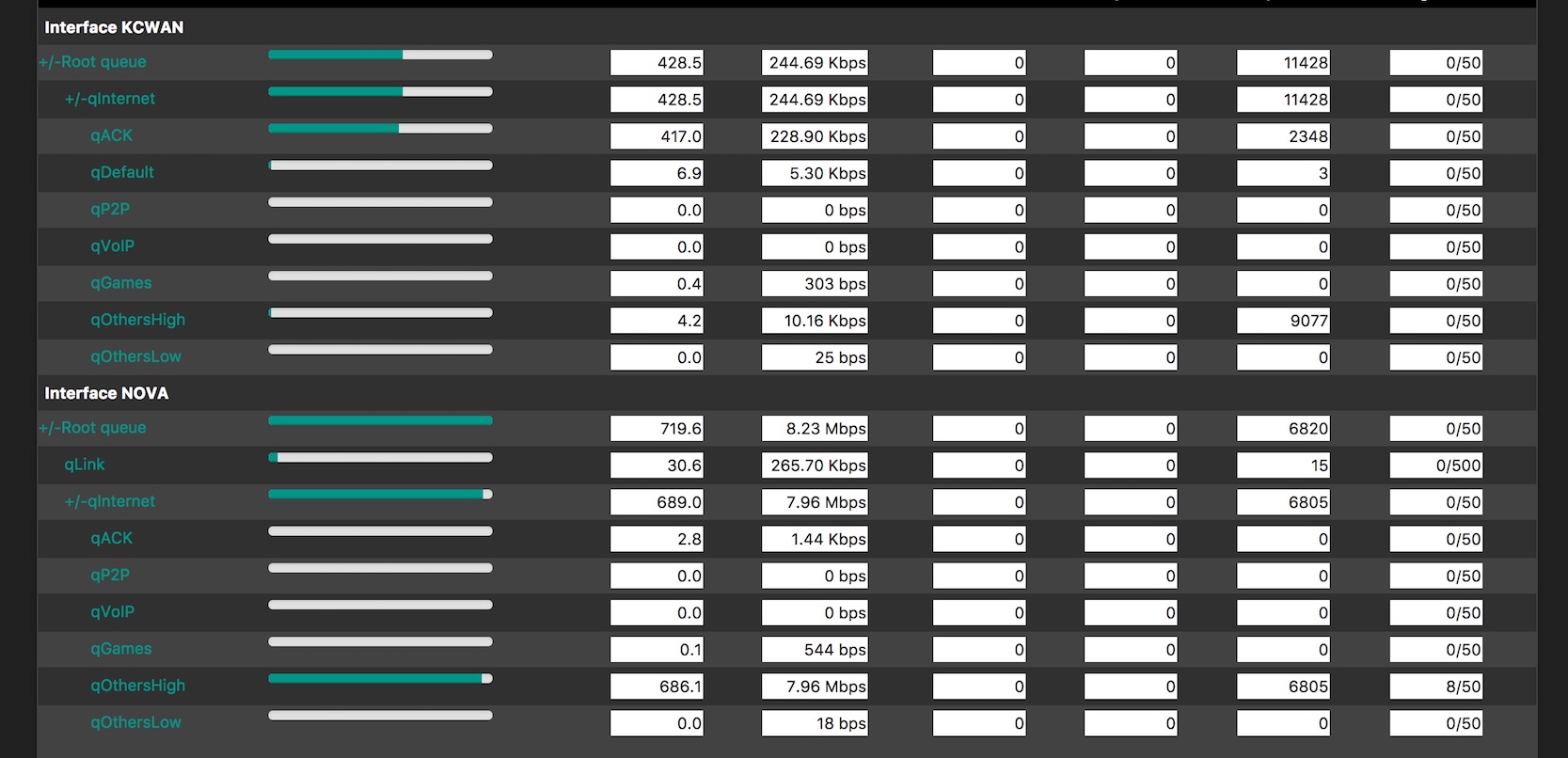

  6. Hey, I have a couple of questions Can you explain what you meant by "Changing the speed for my LAN to match the speed of my network - 1Gbps". I don't see where you would of set the Lan speed? I can see that everything is getting dumped into High at the moment, I will need to work on some rules but currently looking at getting DCSP working from windows. Not much progress though. Based on this screenshot does that show that the Q is full and this believes its capping out my internet connection? The limit is set at 14Mbps. I'll do some more reading later, as some values I don't understand yet. Worth adding that even in it's current state, I was able to set a download going and then start up streams on other laptops without issues and seeing the download slow down. It worked better than the limiters.
