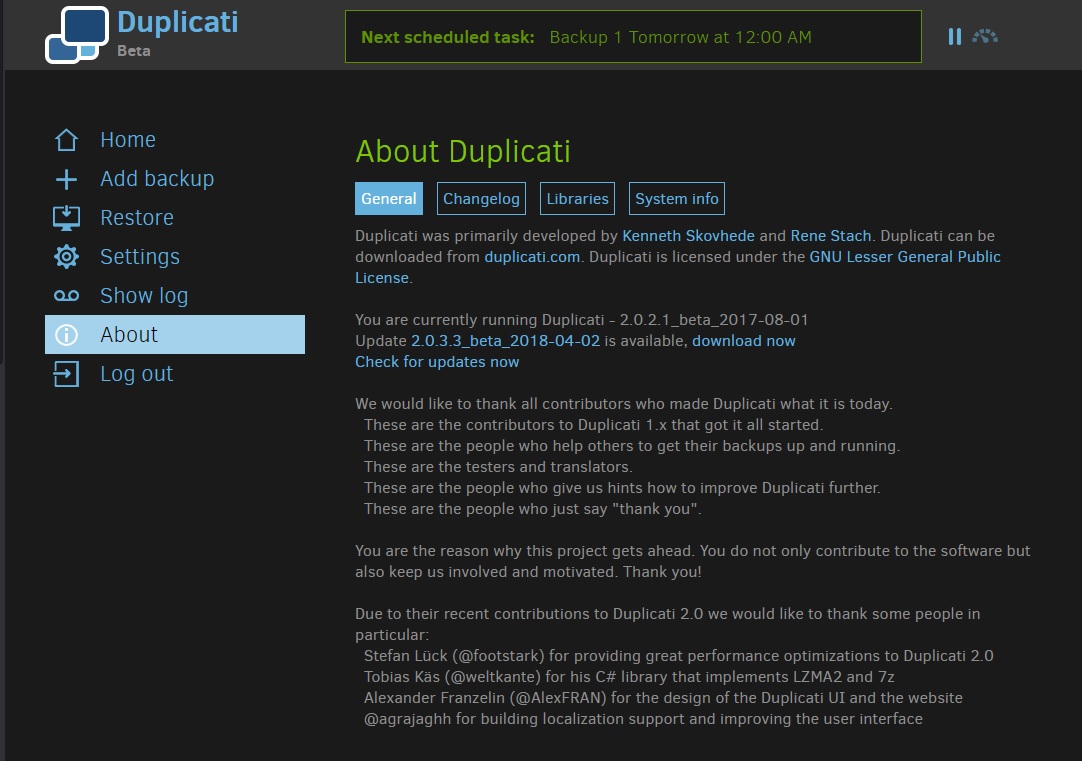

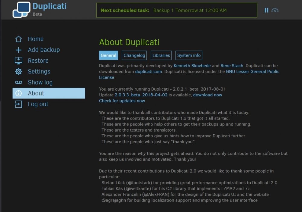

  22. I'm confused on which version of Duplicati the container is running. From what I understand, they have made a lot of improvements in performance a few months ago as far as browsing your backups goes, but I am still having terrible results that seem to go back and forth with each update of the container. On average, after hitting "restore files," it takes about 8-10 minutes to finally be presented with a directory structure I can browse. It then takes 2-3 minutes for it to think on every folder I drill down in that structure. On some updates it gets better, as in it only takes a couple minutes to present the directories and then about thirty seconds to drill down each folder. But then, like in the latest update, it's back to taking several minutes again. Throughout the course of this, the actual version of Duplicati in the container has not changed and is reporting that it is 2.0.3.3_beta_2018-04-02.
  23. How far back is the version of Duplicati in the container? Looking under "About", I'm seeing that the version is one dating back to last August. Is this accurate? If so, what kind of time window are we looking at for the docker container to be on the version that was released today? There's been some huge performance improvements to the latest version that I have been waiting for months on--namely the speed at which you can browse directories within your backups. Currently I am getting backups, but I wouldn't be able to use them if I were to need them since it literally takes like 15 minutes to drill down each individual directory. Getting this update will give me some peace of mind. Using the "check for updates" function within Duplicati itself detects the newest version that was released today. Is it possible use the in-app update function, or would that break the container? Edit: It's occurred to me that hitting "download now" may not be a self updater, but instead take you to a download page to get an installer, which I know would be useless in this case. I haven't tried it yet in case it actually is a self updater and would break the container.
