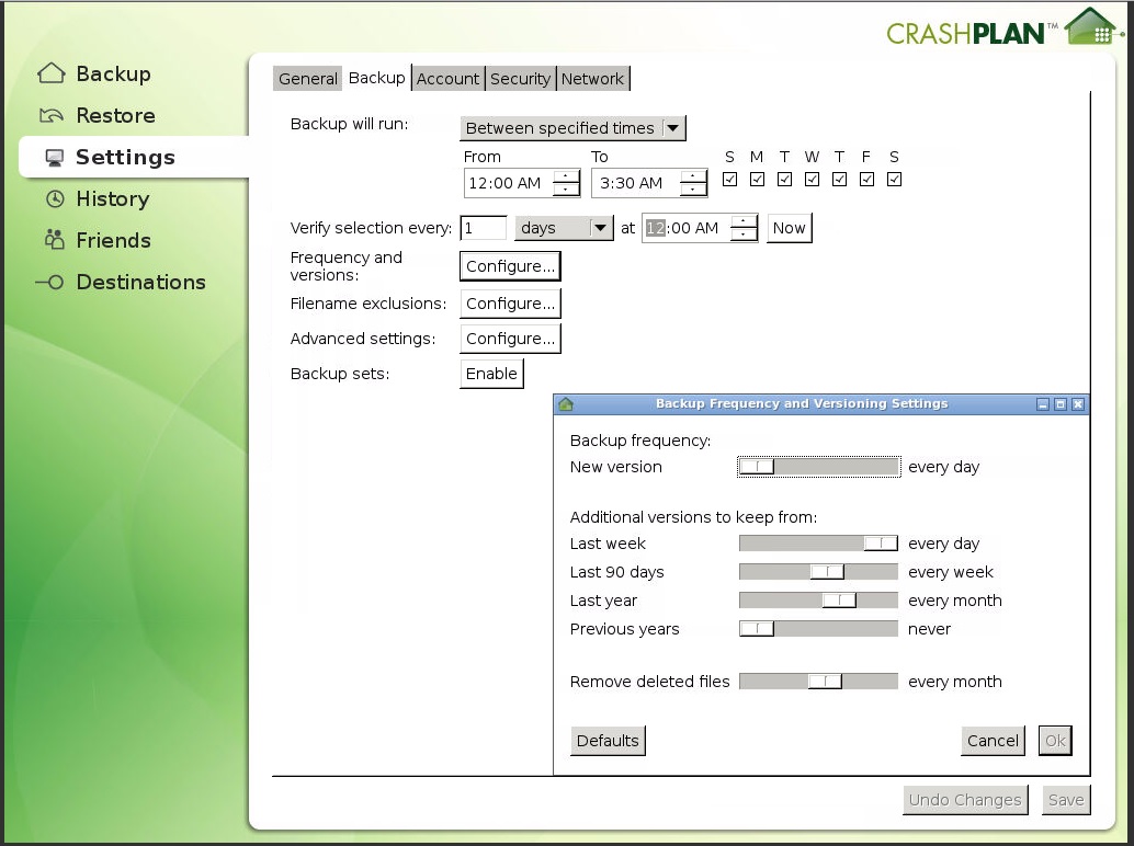

  20. For some reason, Crashplan isn't backing up on the schedule I've given it. I'm aware that there isn't a way to tell it to run a backup "at this exact time," but I wanted it to run a backup at around midnight. I've set the "Backup will run" setting between 12:00AM and 3:30AM. I've noticed so far it has not backed up during this window at all. It's backed up one time outside of that window and now there hasn't been a backup at all within the last 24 hours. Under the summary it does say that backup is scheduled to begin at 12:00 AM. It also says that a backup was done in the last 11 hours, but I find that hard to believe since I don't see any files in the backup that I've uploaded to my shares before that time. I've included a shot of my schedule and frequency/retention policy. Am I missing something?
