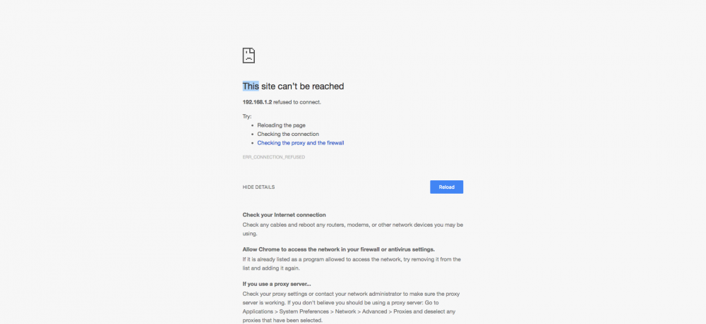

thanks for posting this. I just installed and when I go to WebUI it opens serverip:8124 and says This site can’t be reached
