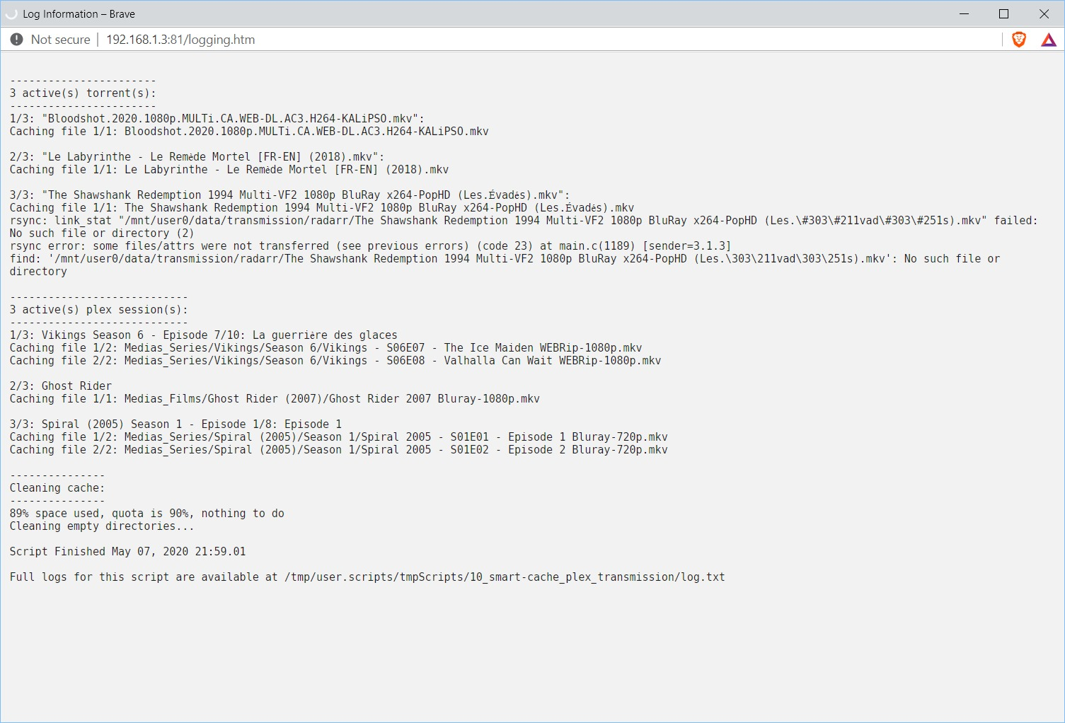

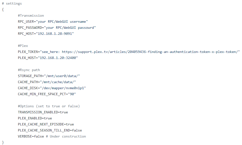

  21. Hello, Thank you for your interest and warm words @hugenbdd ! This script takes me quiet some hours of thinking/scripting. I was not aware of mover binary. If I'm not mistaken the /usr/local/sbin/mover.old script where you find your piece of script for your example was invoking rsync in the past. I recall having picked rsync options (-aH) from this mover.old script My strategy is not to move, but to archive-sync in both direction (same as mover), and to delete from cache depending on disk usage, not deleting on array. Some benefits: - File is not overwritten if identical, latest copy is on cache if it exists on cache. --> Moving from cache to array and vice-versa will take more time than duplicating data (mover will also not move, but sync and delete). --> Copying from array to cache let the data secured by parity --> Having control on deletion allows to handle hardlinks (a torrent seeded by transmission from cache is also available for plex). Mover will preserve them also as it move a whole directory, but I'm moving files. --> I can bypass cache "prefer/yes/no/only" directives, and set mover so it won't touch my "data" share until I'm short on space on cache(i.e if this smart-cache script is killed). --> Using rsync with -P parameters while debugging/testing give some status/progress info Drawbacks: - data is duplicated - deletion and modification from array using /mnt/user0 or /mnt/diskN is not synced to /mnt/cache. This is not possibble if we use /mnt/user for the 'data' share. But thanks to your suggestion (with the filelist idea), I have an idea about how to sync cache only files (i.e fresh transmission downloads during quiet hours) to array. Also, mover may do some extra checks from array to cache. From cache to array, I use unraid shfs mechanism as I sync to /mnt/user0 (and not to /mnt/diskN), same for hardlink that are well handled by shfs. If you want to use this script for plex only, you can: - set $TRANSMISSION_ENABLED to false or if you want to clean the script: - remove #Transmission parameters, transmission_cache fonction and its call ('$TRANSMISSION_ENABLED && transmission_cache') at the bottom of the script. I may extend to other torrent client later.
  22. Updated: v0/5/14: - Improvement on verbosity (new settings) - Added parameter CACHE_MAX_FREE_SPACE_PCT="85" in addition to CACHE_MIN_FREE_SPACE_PCT="90" => When cache usage exceed CACHE_MIN_FREE_SPACE_PCT (here 90%), it is freed until CACHE_MAX_FREE_SPACE_PCT is achieved, here 85%
  23. Hello all, I updated the script 2 days ago, it's holding tight ! I have very very few spinup now, because 1.4To of most recent data are duplicated on SSD. It's on my github: https://bit.ly/Ro11u5-GH_smart-cache Shall I make this a plugin?
