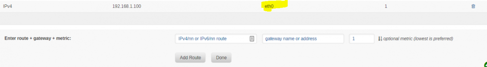

Thanks for your help! I was able to get it working by doing the following, thanks to a tip in the Plex forums here. https://forums.plex.tv/discussion/284890/remote-access-is-still-not-working In short, in unraid under Settings>Network Settings I added an additional route to the NIC i was using, like this, and it did the trick. Thankfully, as I was at wit's end!

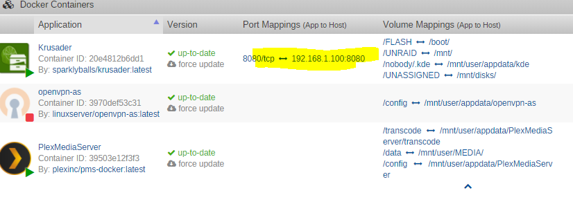

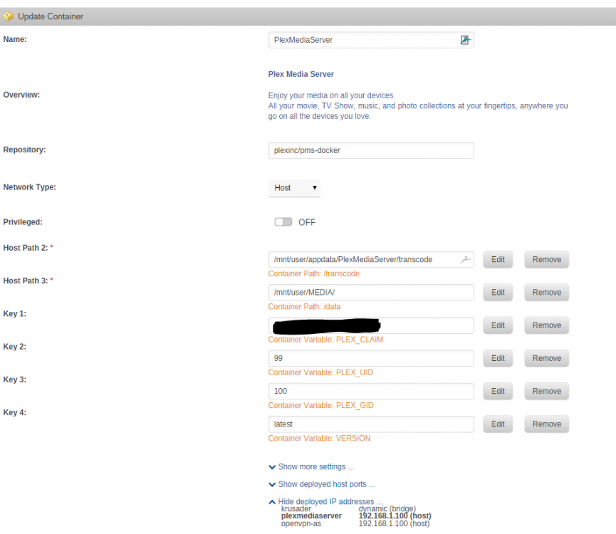

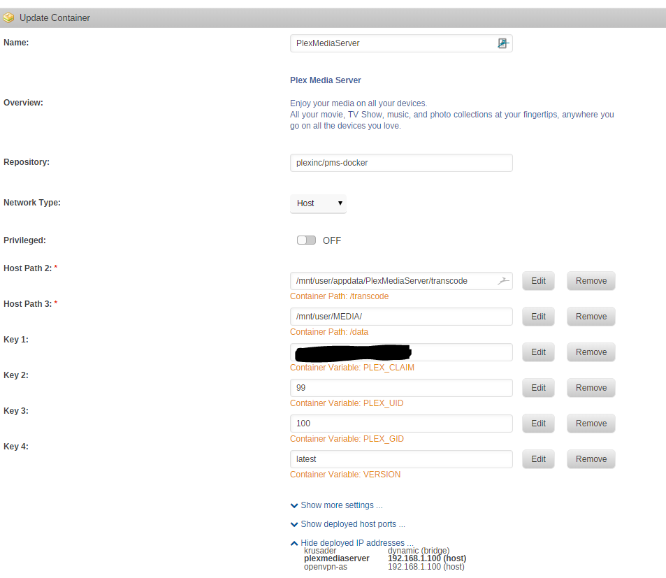

thanks again for your response. i have cable. i have a modem. my own, a motorola surfboard i purchased. ipv6 is currently disabled. i know this is silly. i've set up countless of plex instances but having difficulty w/ this unraid version. the docker i have now is the offiicial plex one, but i had tried limetech's version first with the same outcome.

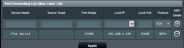

its an asus rt-ac68p and port forwarding has always worked before to my windows machine. new to unraid though. i'll change to tcp only then. thanks!

Thanks for your response Zonediver. I included a screenshot of my port forwarding configuration. Looks right, no? Shows 32400 going to 32400. The 192.168.1.100 is the IP of my Unraid box.

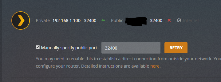

Can't for the life of me figure out why my Dockered Plex is having such difficulty having port 32400 made open to the open internet. It doesn't appear i am double NAT-ed. I ran the test suggested by Plex to see and found out my WAN address as reported on my router matched the one on whatsmyip.host. Is there an additional port i must forward. I'm lost aand have searched the web but found nothing. Openvpn was off when trying this. Any help appreciated! Thanks!
