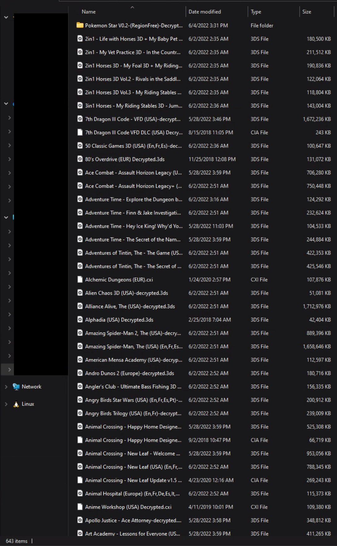

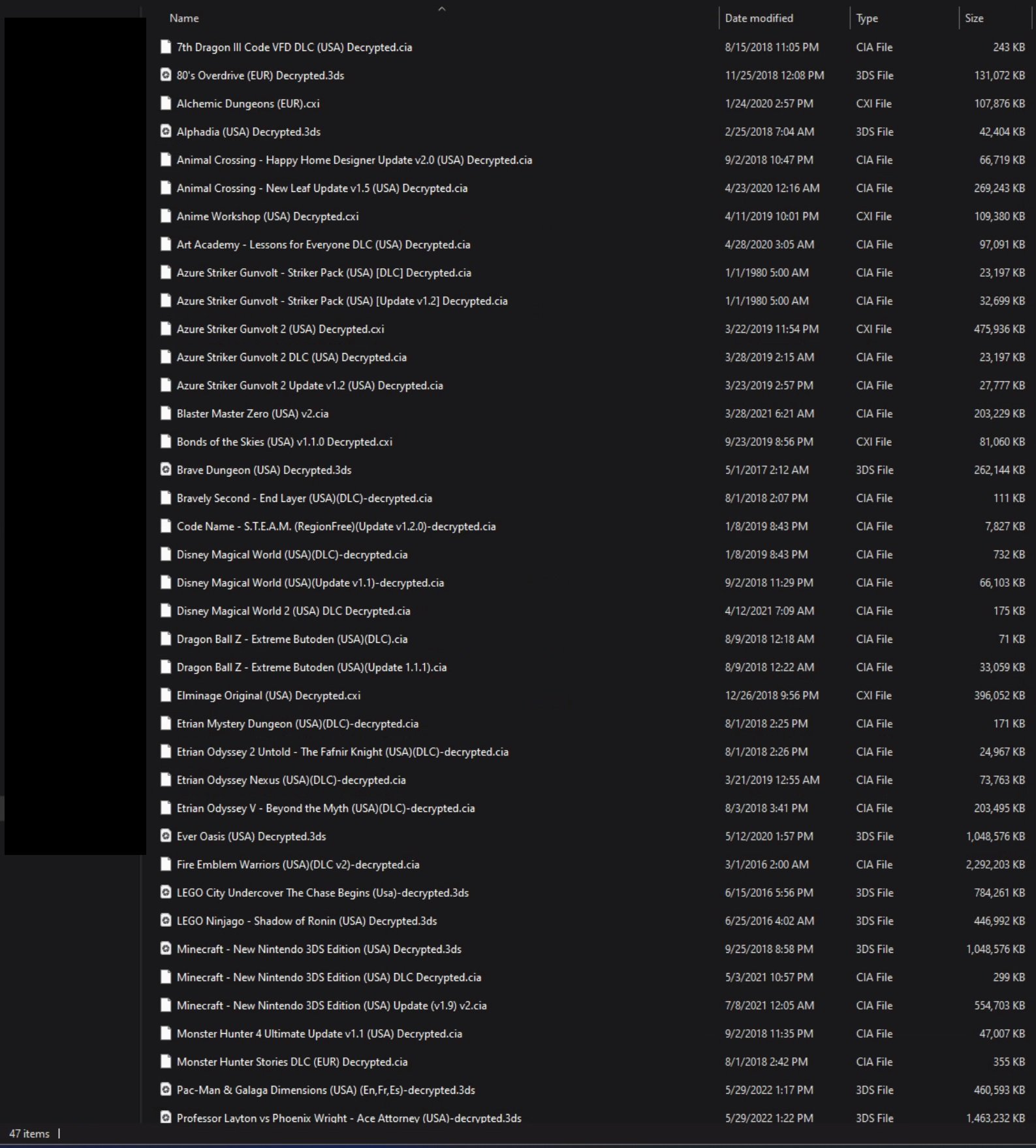

wth, and now, out of nowhere, the SMB is reading 637 files out of the 643. This is so odd. Still copying the 400 GB of data to my PC and then I'll delete the folders, and re add via SMB and see how its behaving. -

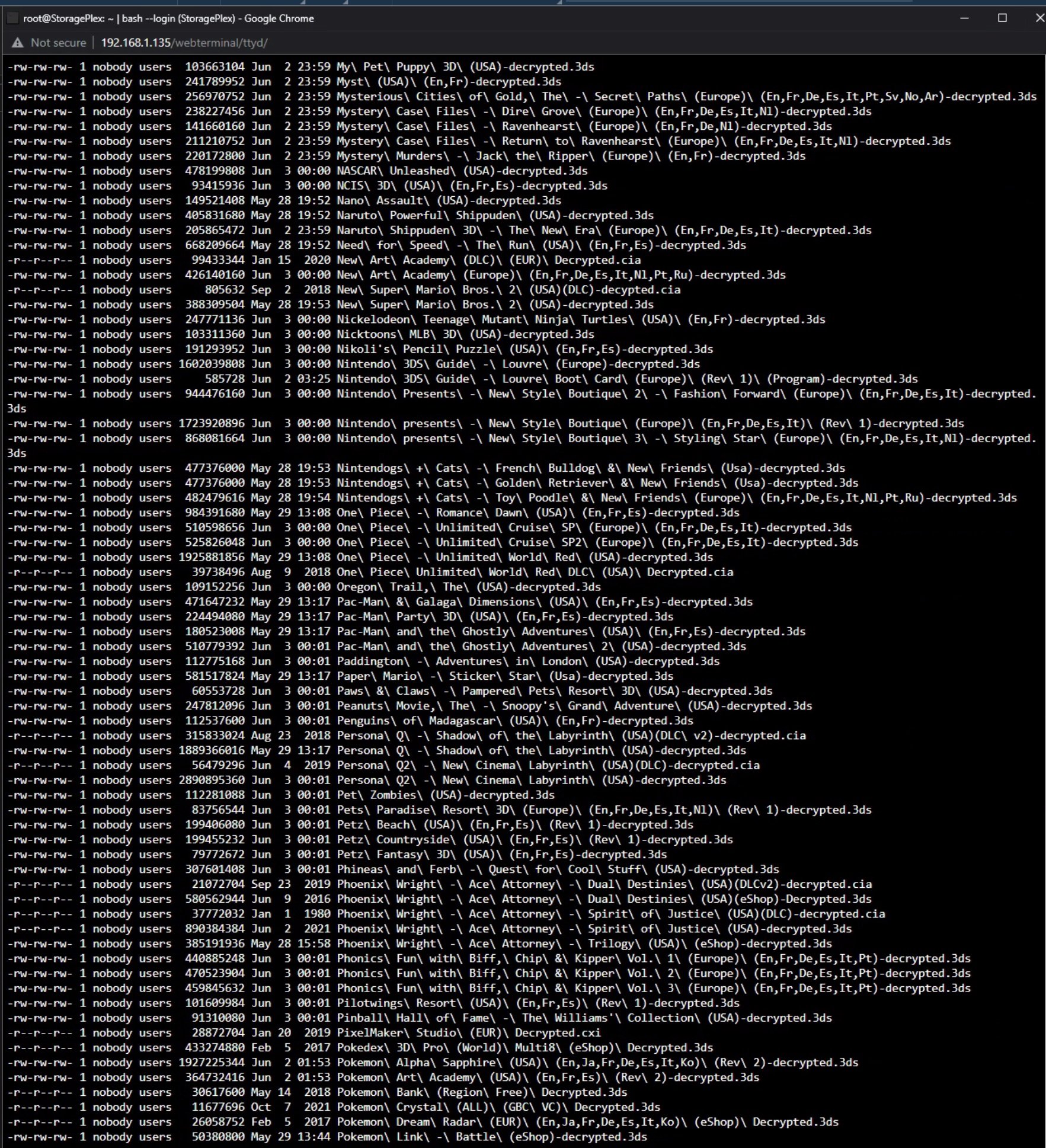

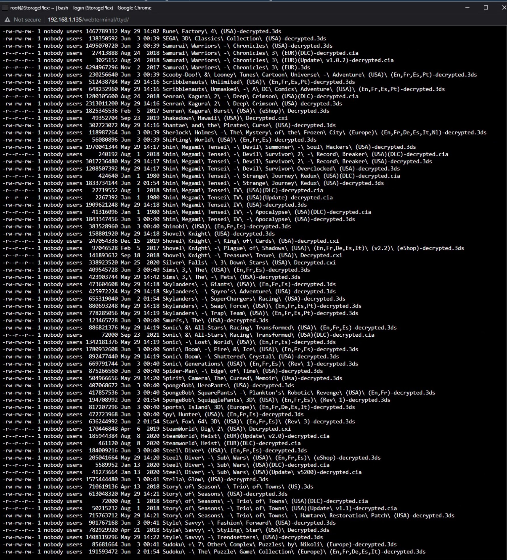

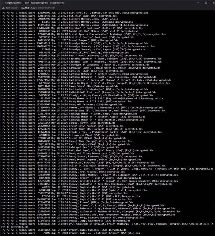

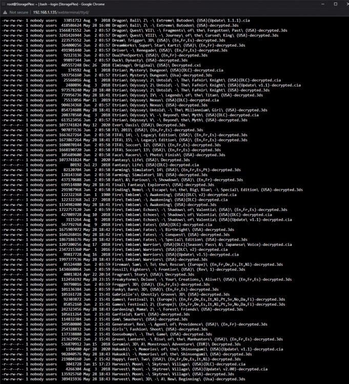

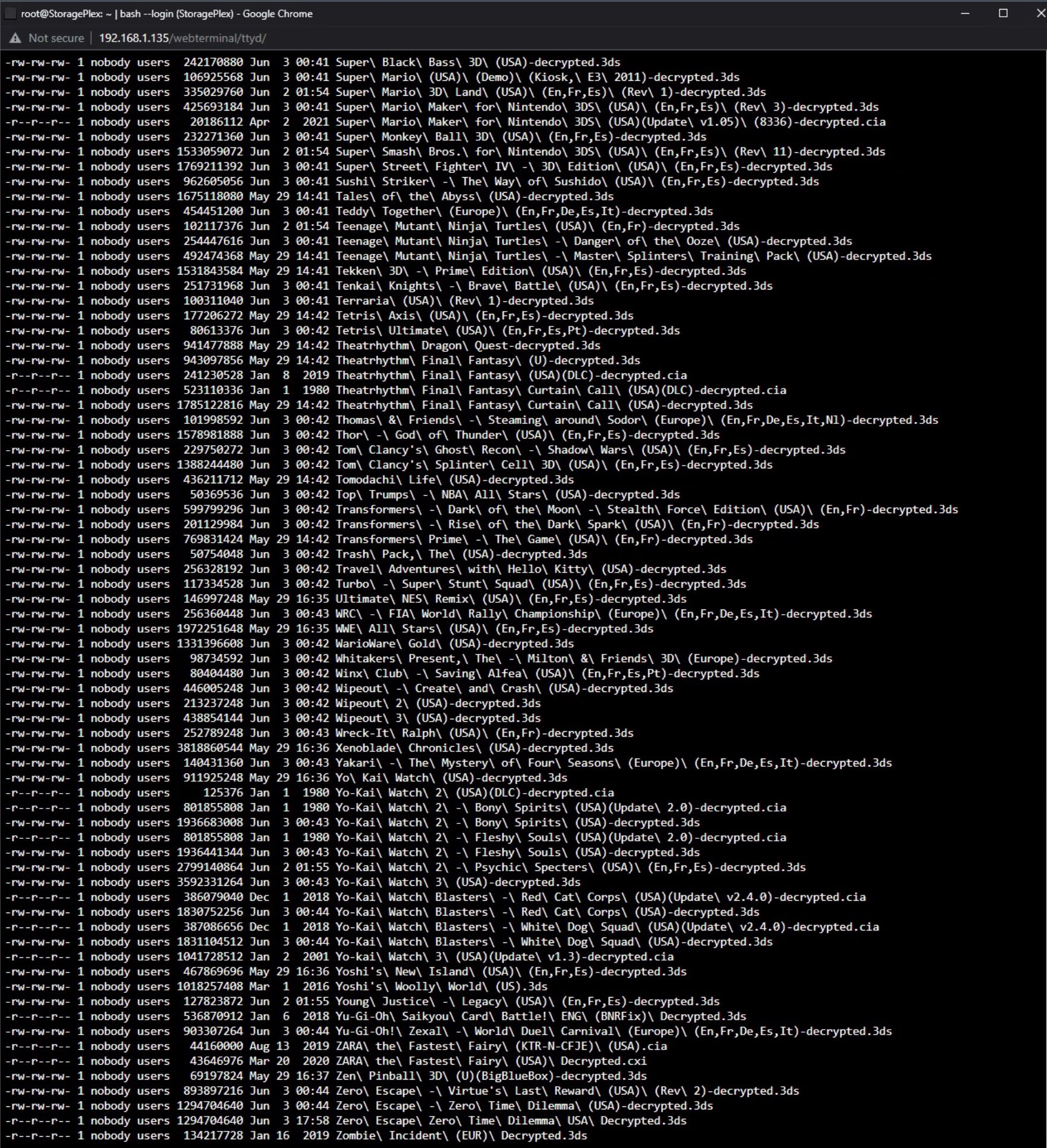

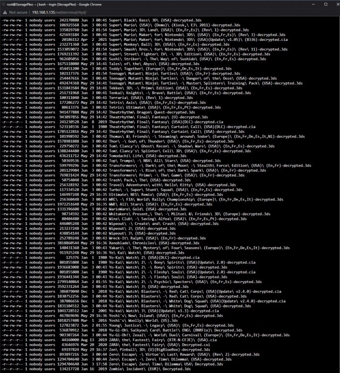

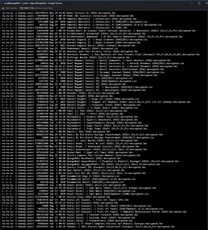

OK, as the earlier test, I had moved it from the initial location, so all this other info gatherings is from the new location. All the permission seem legit. I piped everything into a txt file for each disk and will upload them here. Everything seems fine as far as I can tell, so I got nothing if I'm being honest. I think at this point, Im gonna try your copying to my computer and and remove NFS and reupload it via SMB and see what happens. permission_disk4.txt permission_disk5.txt permission_disk6.txt permission_disk7.txt permission_disk12.txt permission_disk13.txt -

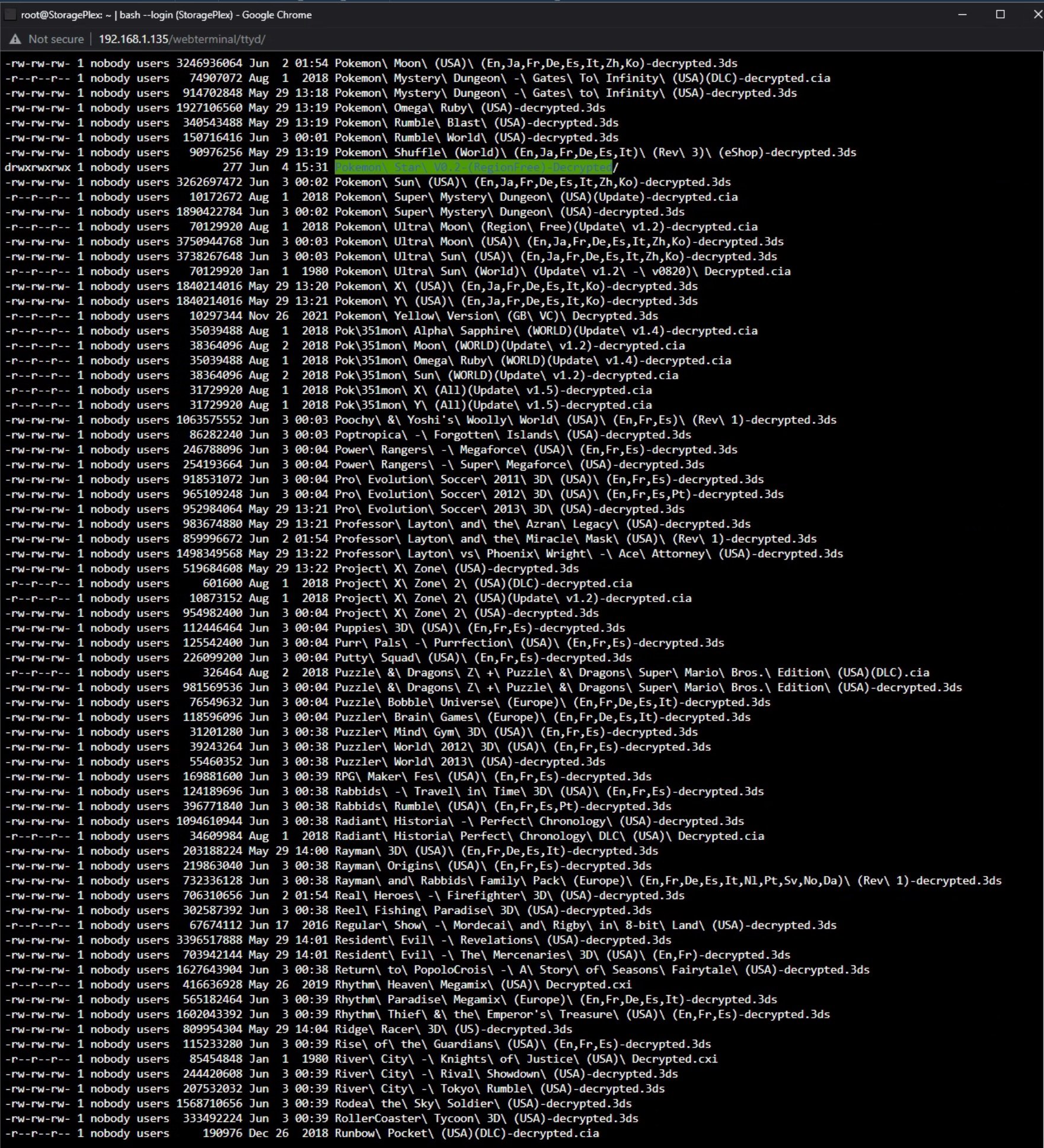

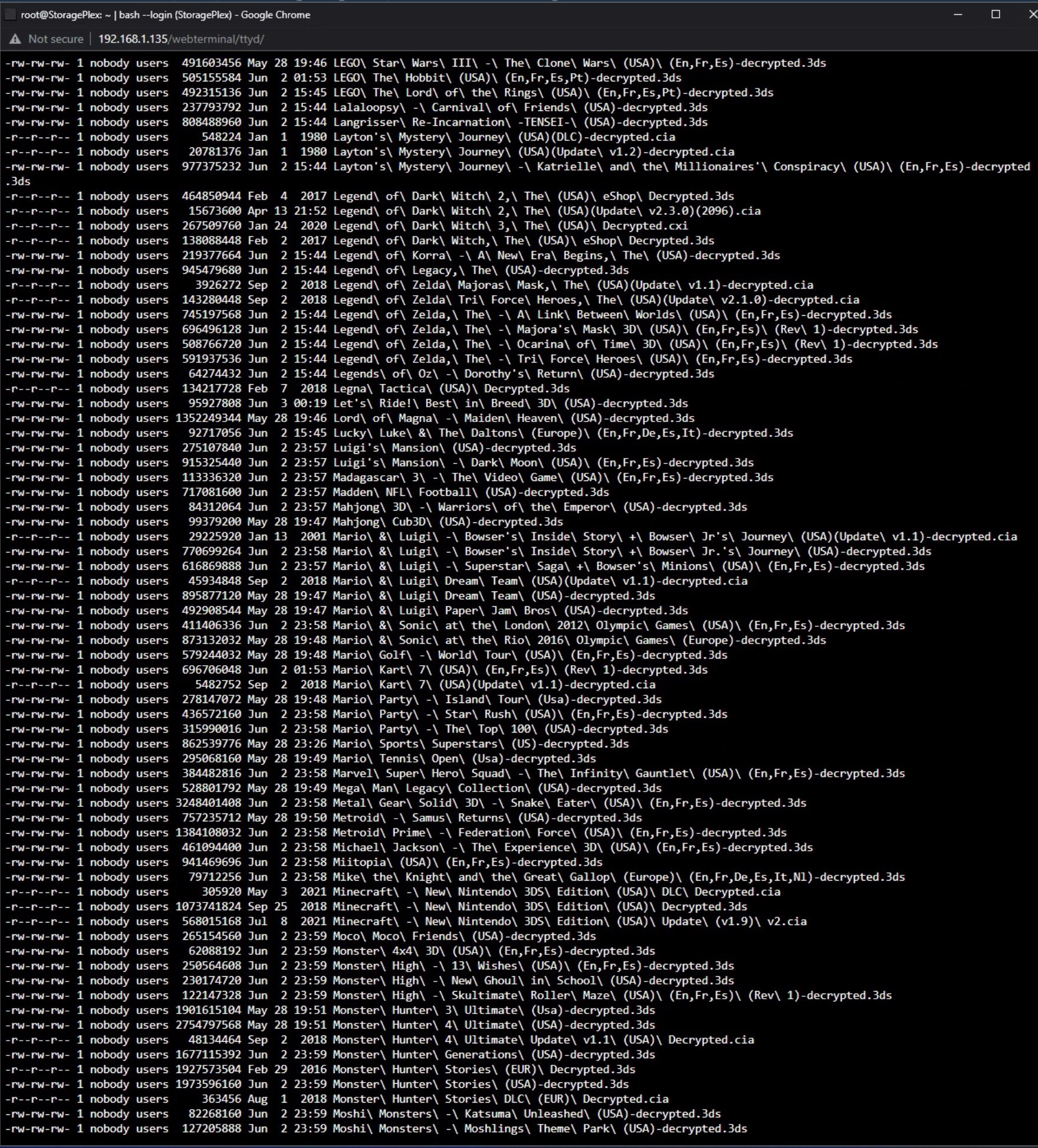

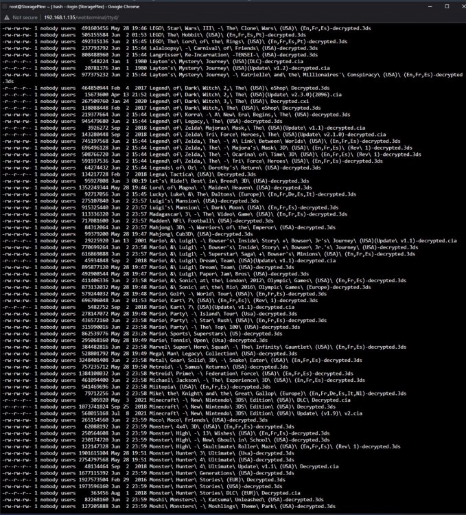

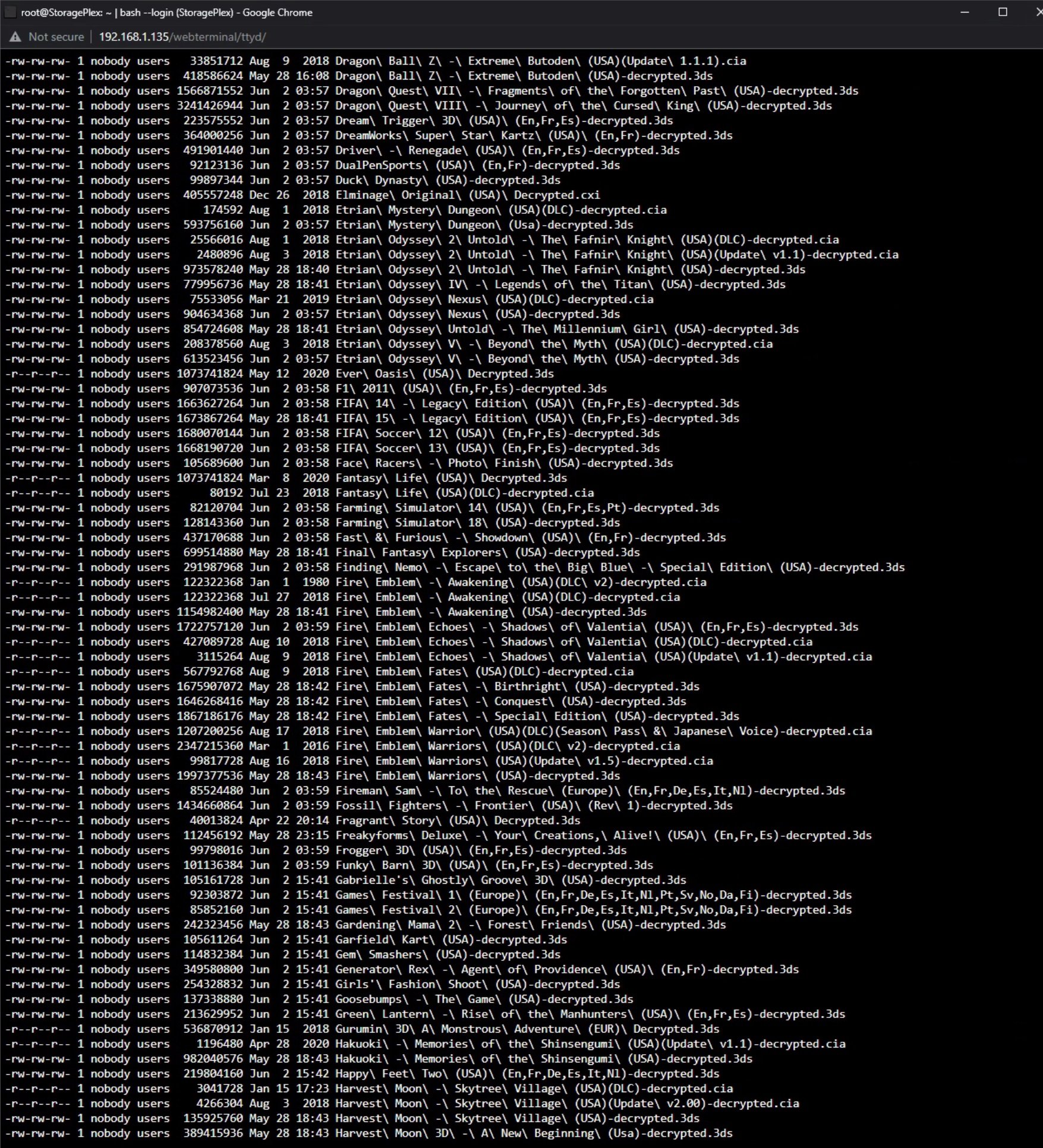

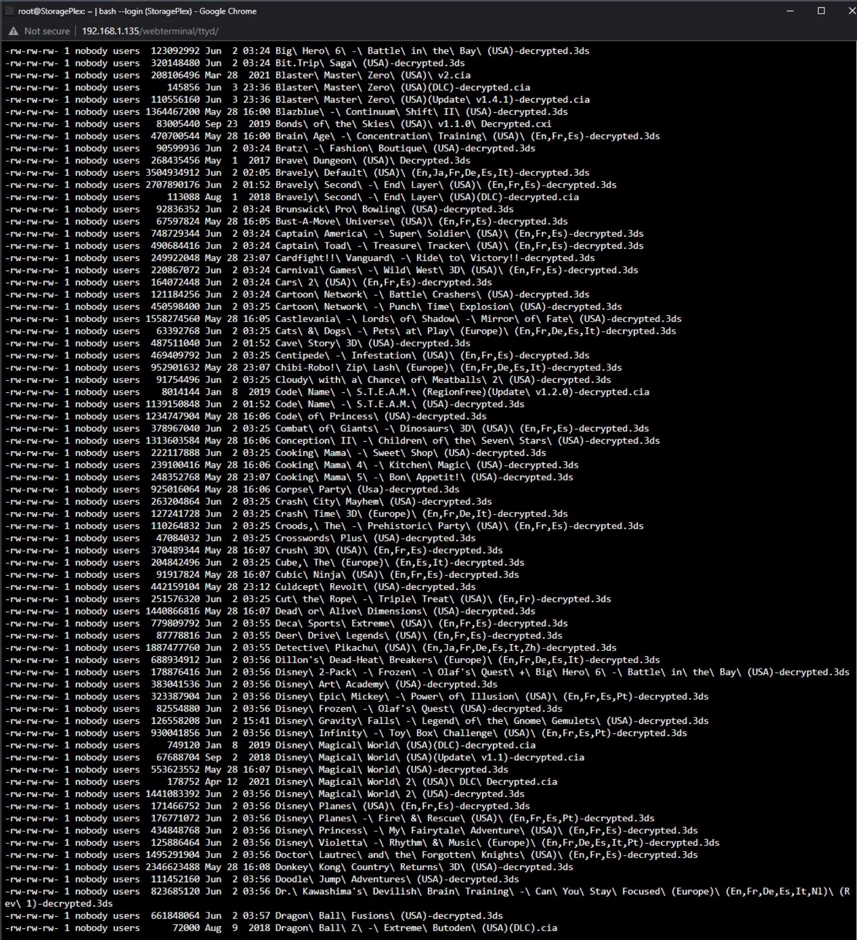

instead of posting 9 screenshots, I just piped the command to a txt folder if that would help. lscommand.txt -

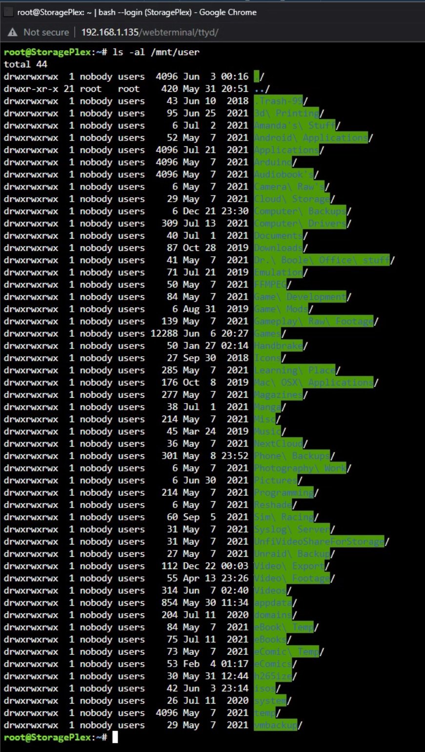

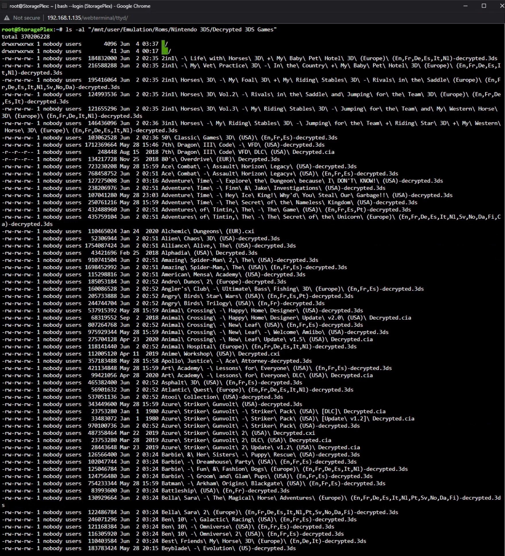

sorry, im bouncing between searching and looking at stuff. Sorry, I didn't realize all the users was the group when I ran the ls -al /mnt/user/Emulation/temp cmd, they all belong to the users group, like the should. -

ok, all the files are in the group users -

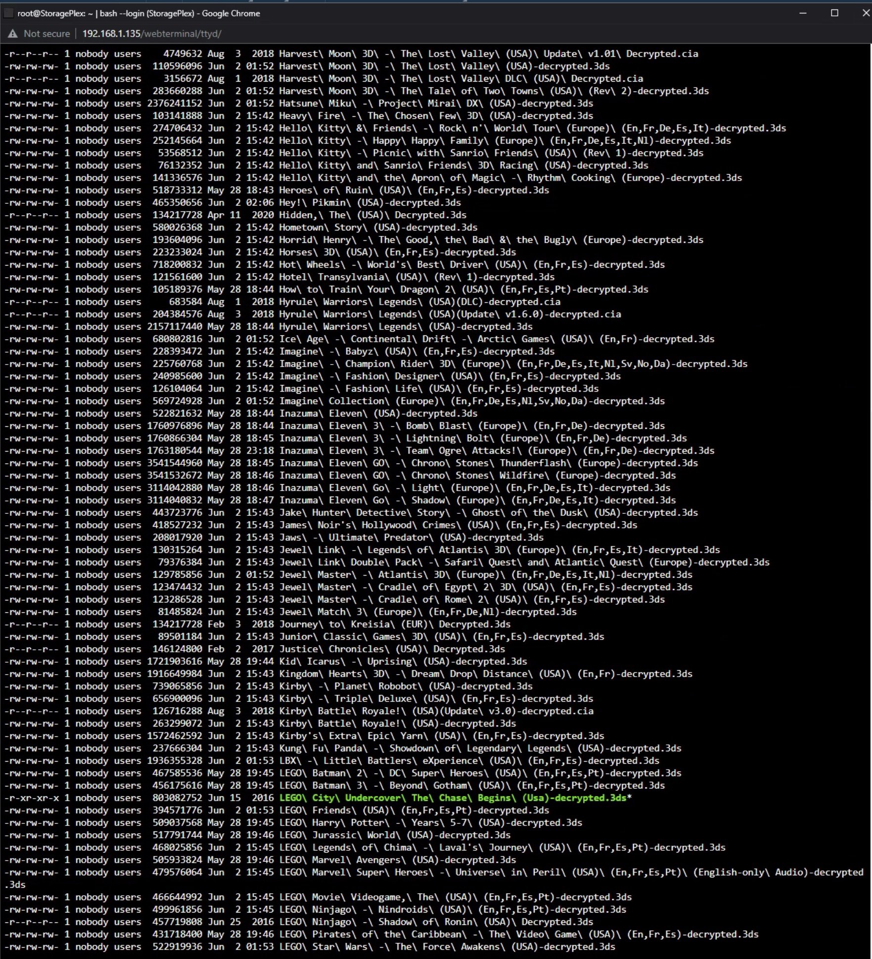

I was simply looking through the GUI in Unraid, it never shows the group name. I'll post a screenshot of what I was seeing. Is there a cmd or way I can find out? I'm sure there is, I'm just unfamiliar. Now regarding the cmd. I can simply open up the folder and \\192.168.1.135\mnt\user, but what I found online about setting this up was to create a batch script and use this. mount -o anon \\192.168.1.135\mnt\user\ Z: .... I just would have thought if a permission issue running the New Permission tool and the New Docker Perms tool would have resolved, or doing them manually through the GUI, but I'm a total Linux noob, so who knows. -

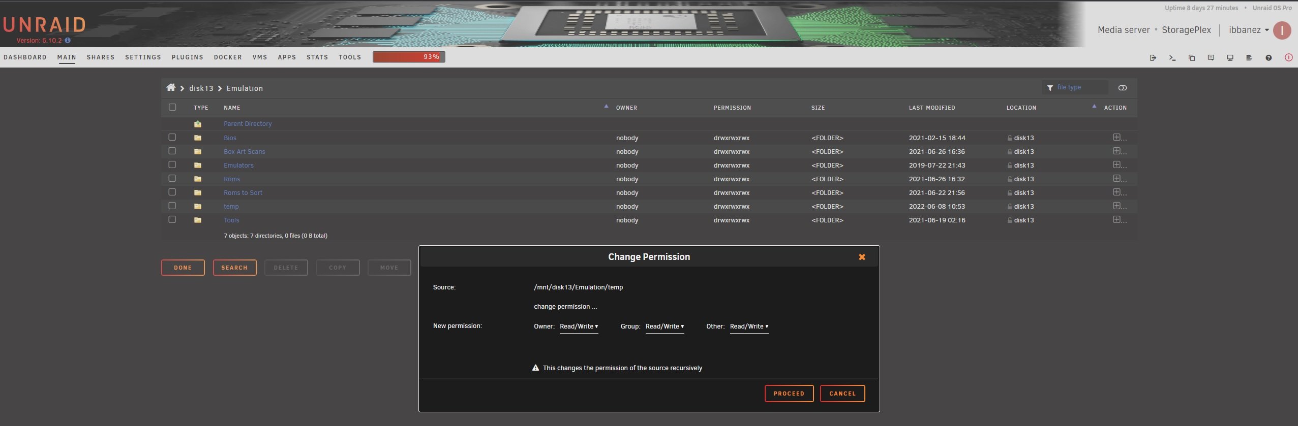

OK, I may need some help here. I went through each disk and found the new temp folder I created, and which one housed all the roms. Interesting, every folder I normally have shows the owner and permissions as "nobody drwxrwxrwx" Full read/write on Owner, Group, Other.... However, all of these specific folders were showing "nobody drwxr-xr-x" and then read as Owner: Read/Write Group: Read-Only Other: Read-Only. So I selected the folder in question that was messed up, and then edited the permissions to all be Read/Write like the others. The folder then showed as "nobody drwxrwxrwx", but the files inside show as "nobody -rw-rw-rw-", which is how all my other folders show up, that are fine. What is odd is even creating a new folder and moving the files to it, while about twice as many showed up, still a fraction. So now 96 show up, versus 643 or whatever the whole number is. And that was from creating a new folder. After changing the permissions on the files/folders on each disk individually, nothing changed. I am so confused as this has never happened in the many years I've used UnRaid, and I'm just lost as to why and how to fix it. If the permissions all match what all my other files/folders now say, I don't get why they don't show up now. -

OK, so I tried making a new folder under Emulation called Temp, and copied them into there from Unraid, not the SMB connection, and now shows 97 files, but not the full 643, wth. I don't understand why SMB is only showing certain drives files'. This is frustrating. I don't understand how a brand new folder I just created is now experiencing this. Any thoughts? -

OK, so I ran the New Permissions tool as well as the Docker Safe Perms again, and neither worked. For some reason, any SMB connection to this one folder, is only showing the files found on drive 4, but viewing the share from NFS, or even inside a file manager from UnRaid, shows all the files, its only this SMB connection from this one folder as far as I can tell. Im stumped. I almost want to just create another folder, move everything to it, delete the folder, recreate it, move everything back, and check again, but at the same time, I want to find the cause and a solution for this, because stuff like this bugs me and not knowing why.... -

OK I just found something interesting, and maybe can point smarter people than me in the right direction. It appears the SMB share is only showing the roms from Disk4, instead of all of them, in this folder only. Because the other folders display fine under SMB. Does that help? -
