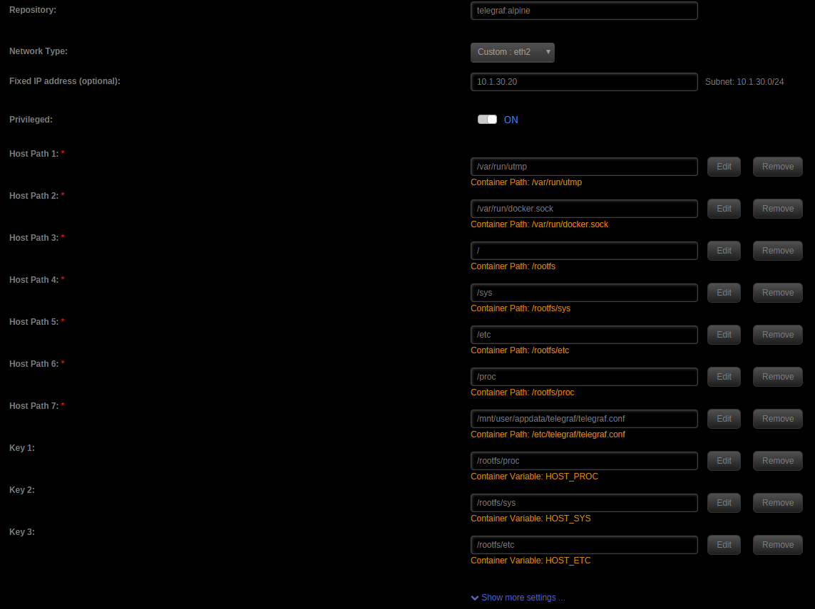

  4. I'm back to answer my own question. Seems like I'm a boob and forgot what I did when I first setup this docker way back. I guess I updated this docker and looks like anything that is installed into the docker is lost :( apk add --no-cache ipmitool This is what is needed to install the ipmitool into the docker. To the maintainer of this docker, is it possible to include this program in the base install?
  5. Hi all, I'm having a little issue with my telegraf docker. All was running nice and smooth with all types of data being stored in influxdb. After a restart of the telegraf docker it stopped getting temps/fans from my motherboard. I have a supermicro board and I can get the stats using ipmitool. Now in the telegraf log i get: 2018-09-10T05:11:00Z E! Error in plugin [inputs.ipmi_sensor]: ipmitool not found: verify that ipmitool is installed and that ipmitool is in your PATH I checked and ipmitool is still in /usr/bin/ and is executable. My google-fu suggested that the docker needs root access and I think it does. Like I said this all was working before.
