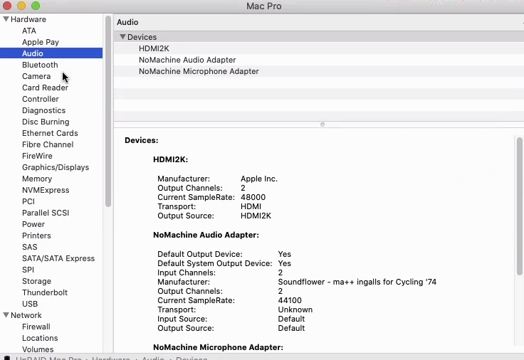

  23. First I want to thank everyone here for their work and contributions. I was FINALLY able to get my Catalina up and running stable. Everything works, including passed through GPU, except the audio. I have Lilu and WhateverGreen kexts installed, which helped with passing through the GPU. I have also set the code correctly, i think to allow multifuction to work, and changed the bus for the GPU/Audio to be on the same bus: <hostdev mode='subsystem' type='pci' managed='yes'> <driver name='vfio'/> <source> <address domain='0x0000' bus='0x04' slot='0x00' function='0x0'/> </source> <alias name='hostdev0'/> <address type='pci' domain='0x0000' bus='0x04' slot='0x00' function='0x0' multifunction='on'/> </hostdev> <hostdev mode='subsystem' type='pci' managed='yes'> <driver name='vfio'/> <source> <address domain='0x0000' bus='0x04' slot='0x00' function='0x1'/> </source> <alias name='hostdev1'/> <address type='pci' domain='0x0000' bus='0x04' slot='0x00' function='0x1'/> </hostdev> I also installed the AppleALC kext, but it seemed to have no effect. I am seeing the HDMI audio out in the sound preferences, but I am not getting any sound coming through the VM via NoMachine. The server running the VM is headless, so there is no monitor or HDMI hookup directly. I'm using a headless ghost HDMI device to initiate the graphics adapter to work. The GPU I'm using is an AMD WX 4100 4 GB, and is correctly seen by the system. No matter which audio output choice I select, HDMI2K, or NoMachine Audio, I do not get any audio.

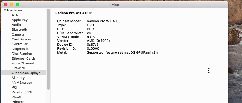

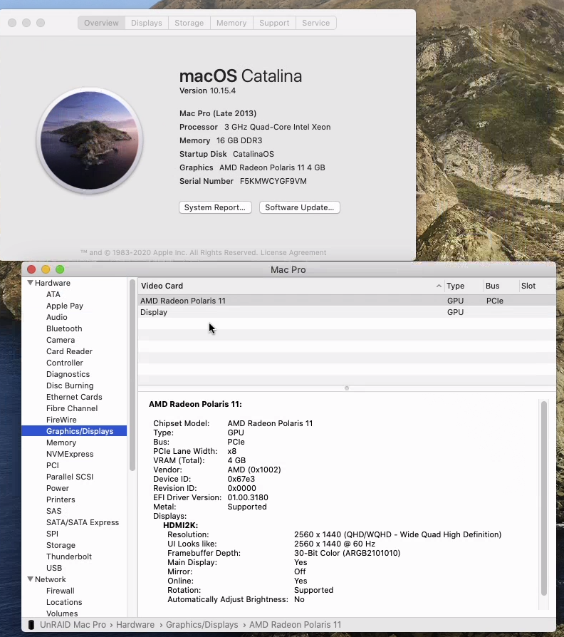

  24. Update: I'm able to see my Radeon Pro WX 4100 in system information. But it doesn't show in the "About this Mac" page, and I'm not able to change the graphics to anything other than 1280x1024. Any Suggestions?
