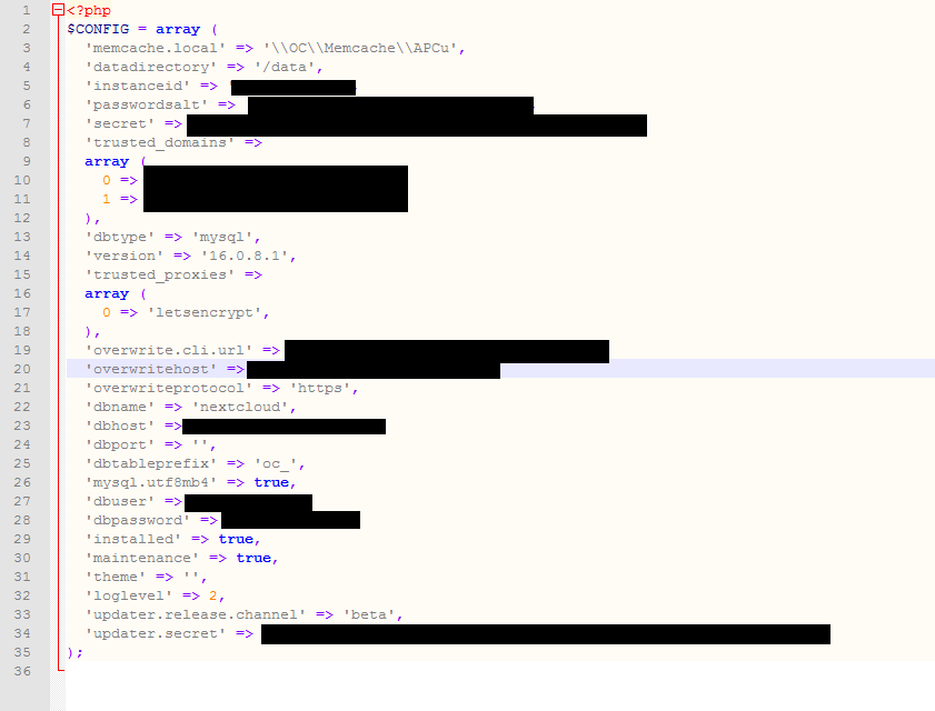

  11. Great advise @Kewjoe Updating manually to each version might have been annoying, but it definitely worked. Thank you so much for the help!!!
  12. Per the config.php file I'm on 16.0.8.1. I was trying to go to the next available, which was 17-something. Can't see now as I cannot open the web gui to see. My end goal is to update to newest stable release. Thanks again for you help.
  13. Thanks Kewjoe, Having difficulties understanding this comment by Nick: So what you could do is: Remove the version from the config.php you copy all the time Copy the config.php to others.config.php instead of config.php Do I remove the entire version line, or just remove the version value in place? Also, I don't have an others.config.php file that I can locate. Are these steps or different options as well. I did respond to Nick as well on the Nextcloud forum for clarification. To add now, when trying to launch the NextCloud docker I get an Internal Server Error and cannot access the web gui at all. Sorry to sound bothersome.
  14. Thank you Kewjoe. I followed the step, but when getting to the "Perform the Upgrade" step, I got the following error: Set log level to debug Exception: Updates between multiple major versions and downgrades are unsupported. Update failed Maintenance mode is kept active Reset log level Any thoughts? I appreciate all the help.
