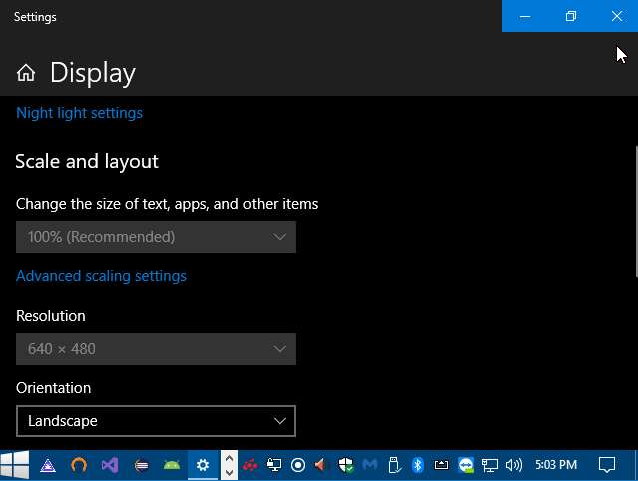

  4. Sorry to revive old thread, but was this fixed? We are up to version 6.6.1 now, wondering if it's fixed. I had an HD 6450 and everything was working fine. I decided to upgrade to an RX 460 and now my video is 640 x 480 and it won't let me change it. It even detects it as RX 460, but won't let me switch resolutions. I found it kinda odd... and it might be a whole different problem, but just wondering, because I have 2 SuperMicro AOC-SASLP-MV8 sata controllers on the other PICe slots and can't take them out to put a video card on there. Thanks!
