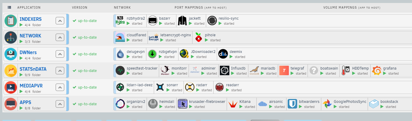

  19. Hey @GuildDarts would it be possible to add a "Expand all" and "Hide all" button on the docker page for all the folders? side note the advanced context menu is fuckin sweeeeet! thank you @hernandito and @GuildDarts
  20. fuckin right the new hover feature and larger bold folder names is beautiful touch 👍👍

  22. fuckin right just when I thought how could this plugin get any better. Love the new preview feature!! The new style is also very nice and clean on the eyes. Thank you!
