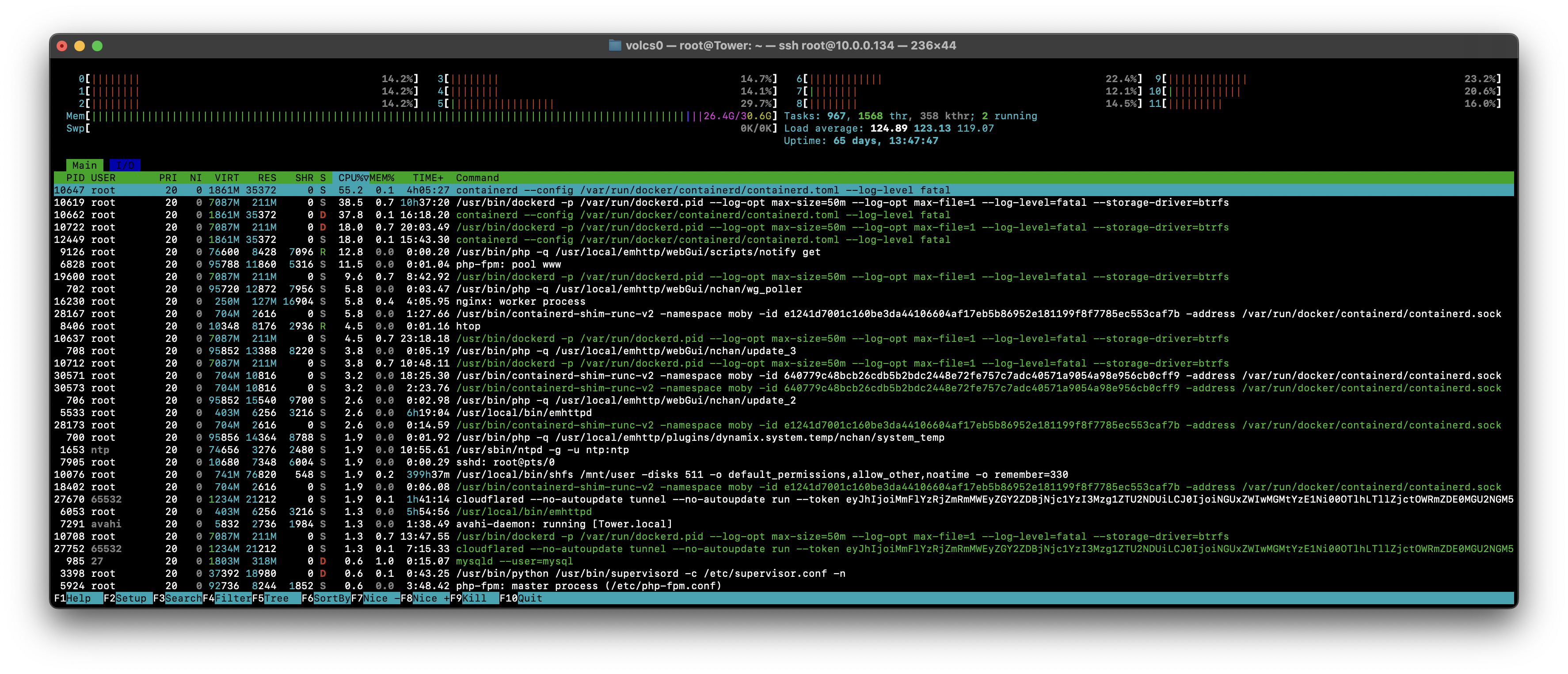

Troubleshooting these errors (nginx?) - system is pretty unusable and won't let me output diagnostics (pics included)
System is pretty unusable right now. Before I restart, what can I troubleshoot to diagnose? My Dashboard page shows no activity (it is not updating, see pic), and my "Main" page doesn't show anything (see pic). Docker page does not load, though I can access running dockers (e.g., Jellyfin). Under Tools --> Error log I took the attached screenshot. I tried to output diagnostics, but it hangs and doesn't output anything. I can SSH in and do htop - screenshot attached. This happened a few weeks ago, and I restarted, and it was OK until now. What I was doing when this happened was moving a large number of files from my Downloads folder on cache to a share on the array. This has happened before when moving lots of files around. I'd love to sort it out. I just updated to 6.12.15 three days ago, but this happened before the update as well (was on 6.12.4). Before I reboot, anything else to check or test? Thanks.

Server mostly non-responsive, seeing lots of dockerd and containerd at 100% with -log-level=fatal
Server became mostly non-responsive. CPUs all 100% in the GUI (once it finally loaded) htop command shows high usage of containderd and /usr/bin/dockerd with -log-level=fatal. I noticed Navidrome using a lot of CPU at one point, so I killed it, and now the system is back to being responsive. Screenshot and logs attached. Navidrome was running fine for weeks. Advice appreciated for finding the root cause and how to fix. Thanks. tower-diagnostics-20240425-0609.zip
