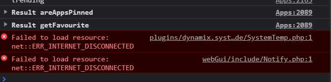

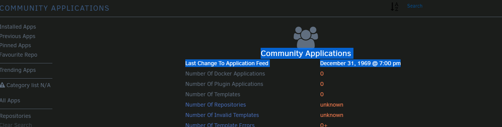

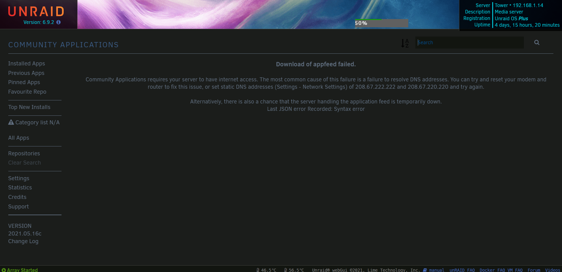

  24. Hey there my friend! @CyaOnDaNet I’m back with another request: I started using forms Auth to login to on my Sonarr instance and now the bot can not connect it’s getting stopped by Sonarr for not authorizing. Any idea how to circumvent this? I thought that was what the API key was doing but I guess not 2021-10-23 18:21:46.1|Info|Auth|Auth-Unauthorized ip xxx.xxx.x.xxx url
