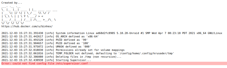

  6. Hey guys. Ran into some trouble with the krusader docker. Had it running just fine a few weeks ago, but now it doesn't start up properly. When the krusader docker is started, the docker tab in the unraid GUI shows the docker as running. But attempting to connect to the webUI gives an unable to connect error, and trying to get into the docker console throws up an error response from the docker daemon that the container is not running. At this point, refreshing the docker tab in the unraid GUI will show the container as stopped. The log for the container shows an error that the /etc/supervisor.conf file could not be found: I have tried removing and rebuilding the container a few times with no luck. No recent changes to the krusader docker, but the docker settings recently changed from btrfs image to docker folder to try to limit cache write amplification. Also, some code was added to the /boot/config/go file per the comment from @mgutt in this thread, also to try to limit cache write amplification. I reverted the changes to the /boot/cofig/go file with no change in behavior. I could move docker back to an image file, but its kind of a pain and not sure that will help. Any ideas what is going on? I can use the terminal to move files around, or a double commander docker from the linuxserver folks for now, but really prefer the binhex krusader docker for the interface and the password feature. Thanks!

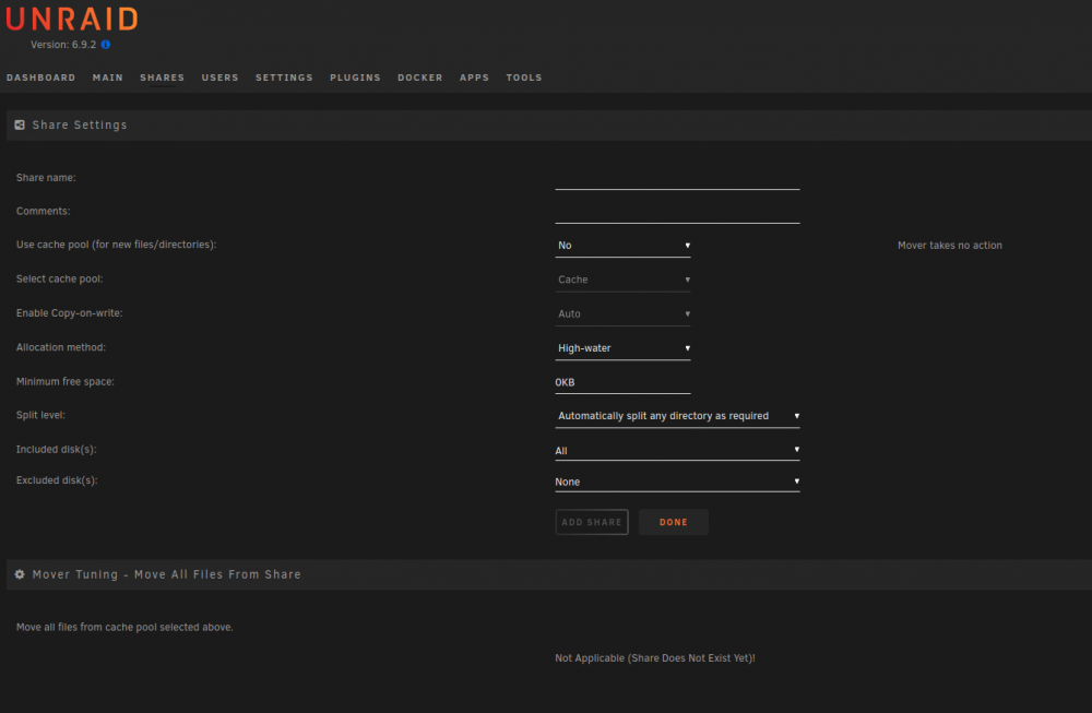

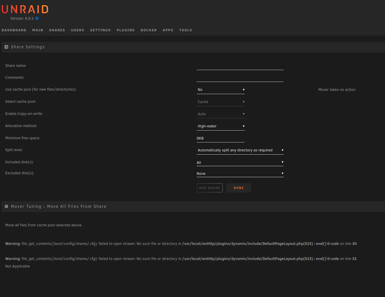

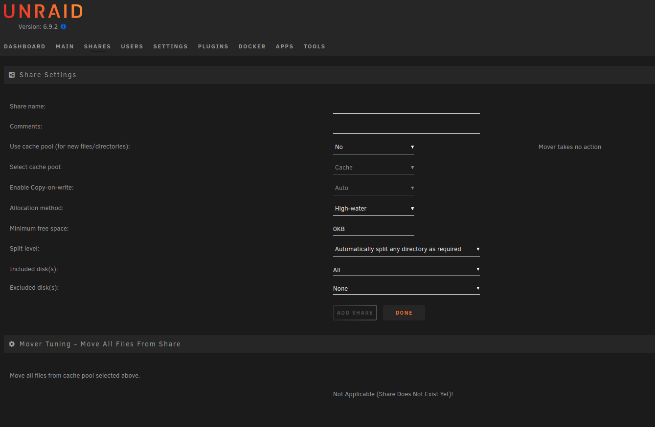

  10. Agreed, great feature. Just happened to be adding a new share today, and noticed that the new feature causes some warning messages on the add share page b/c the new share being created does not exist yet (lol):
