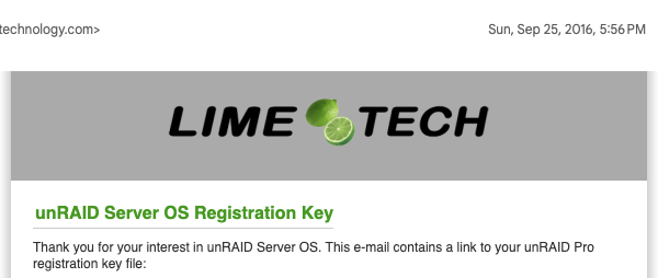

  1. 8 Years in for me. The one thing that almost pulled me away was ZFS. Now that we have that, I'll be here for much longer. Even if I move away from the traditional array pool completely, the OS still ticks a lot of the boxes that are important to me. Immutability, app discovery, quick updates relative to the kernel and of course the community that serves as a support base. You can still go off script and do advances things if you have a use case that calls for it. Want compose files? There's a plugin. Want kubernetes? Install k3s/d in an LXC container etc. Here's to 19 more.
