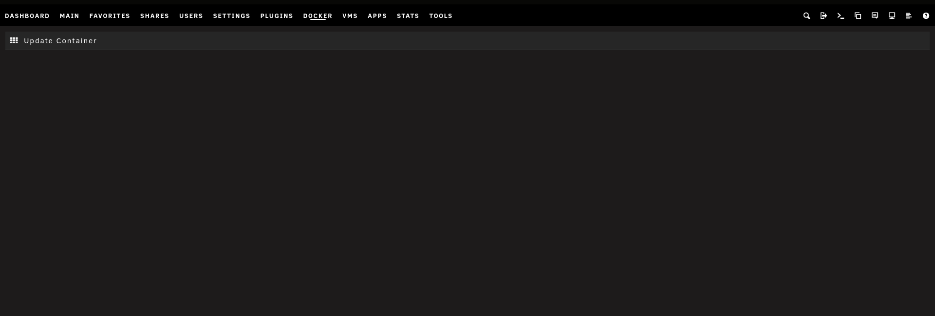

Container update screen blank
I went into Safe Mode, started the array, then edited one of the containers(DuckDNS). I just put a space in the Overview field, then deleted it just to have some sort of change to cause the Apply button to activate. I get the same problem. It shows only "Update Container" , then shows the rest after the update is completed. It used to show the interim steps previously(Stopping container, Removing container, Command execution).
I haven't tried safe mode yet since I'm waiting for a container to have an update available. To update the container, I'm going into the config and changing the Repository field.
Sorry for the long delay. I tried Firefox and still got the same results. It's only when I update the template with a new container version that this happens.
I notice that when I update a Docker container manually, I get a blank status while it's updating but then shows what it was doing when it completes the task. It just says "Update Container". I just wait for it to show the Done button, but it doesn't show progress like it did before. flores-diagnostics-20251207-1008.zip
