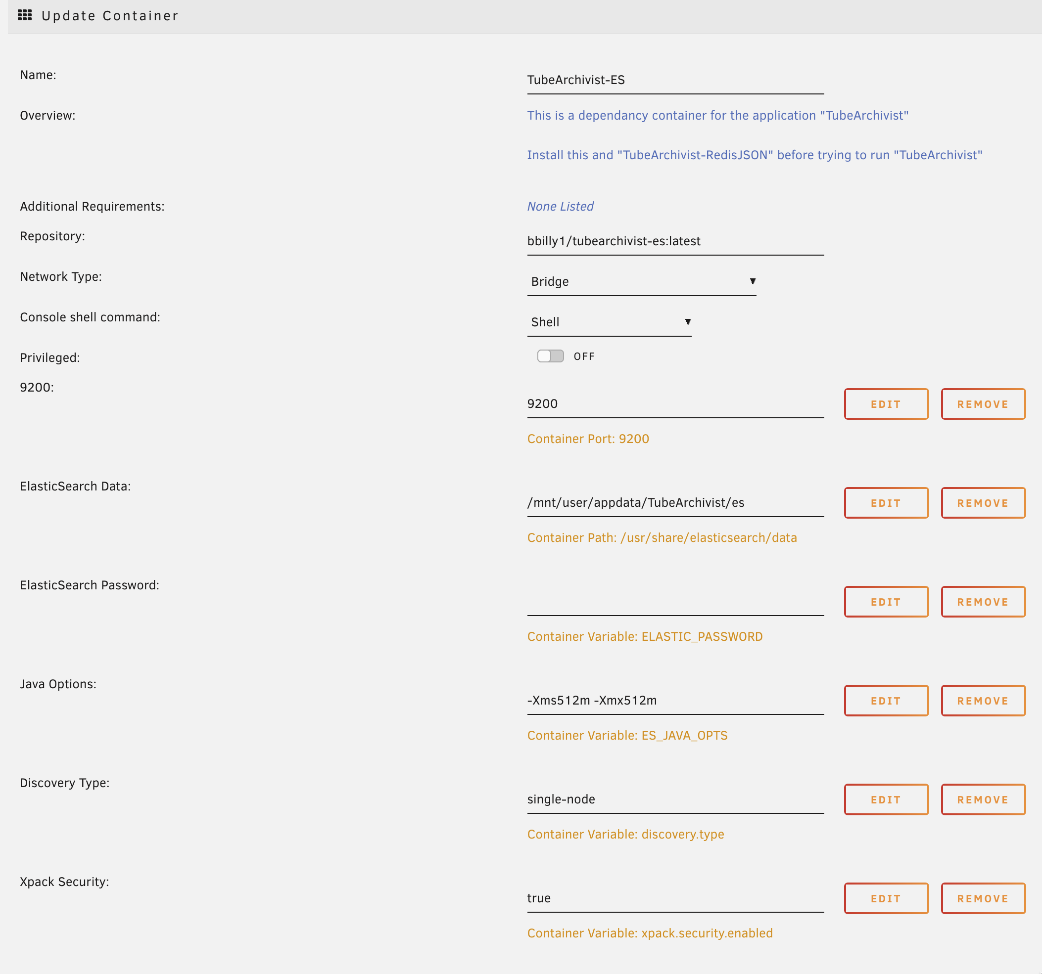

**VIDEO GUIDE** - How to set up Tube Archivist
Going to follow this video to see if I can get it working on unraid. Currently getting this error with the ElasticSearch container. ERROR.txt
[Support] Crocs - Tube Archivist
My ES container has this error message: ERROR.txt I'm not entirely sure what to do next. Going to try and start fresh.
