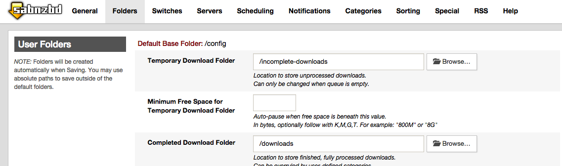

  1. Ok...I renamed the directory to be downloads vs Downloads (Though that should make no difference.) Then I just did redo SABnzbd by deleting the container and running it again without downloading the files. So I also did Sonarr, did not delete the container, but just changed the path for /downloads to make the "D" in downloads to be "d". I will now try to download a file. (It will be some time but I am not hopeful at all. I think download is not right or something and does not use the right path. AS also mentioned, I also think it is looking at /config when it should be looking at /downloads when it gives Sonorr the info. This is something I think whoever made the package, or whatever it is called, need to look at. Is anyone using these Linuxserver version?)

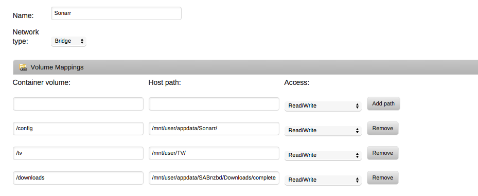

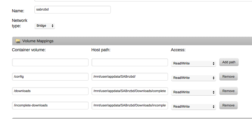

  2. Hi... Their is a completed file sitting in " /mnt/user/appdata/SABnzbd/Downloads/complete/" and it was put there by SABnzbd. He mapping for SABnzdb is... /config ---> /mnt/user/appdata/SABnzbd/ /downloads ---> /mnt/user/appdata/SABnzbd/Downloads/complete/ /incomplete-downloads ---> /mnt/user/appdata/SABnzbd/Downloads/incomplete/ And according to this...Sonarr should already know where the downloads are... /config ---> /mnt/user/appdata/Sonarr/ /tv ---> /mnt/user/TV/ /downloads ---> /mnt/user/appdata/SABnzbd/Downloads/complete/ However it seems that Sonarr pings SABnzbd and it hands the directory it should look in. So guess that last line is for something else. So then assuming Sonarr is working...as it seems to be...I will need to start over with SABnzbd.

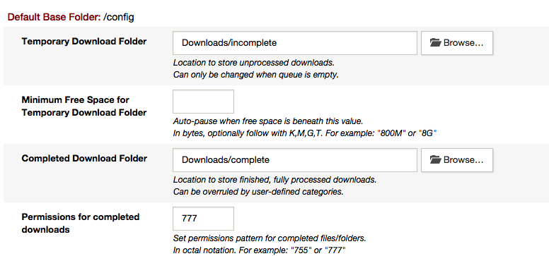

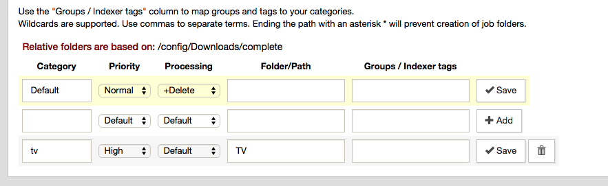

  4. Same error all the time. No matter what I change inside the Folders page of SABnzbd, I get the same... Import failed, path does not exist or is not accessible by Sonarr: /config/Downloads/complete/TV/The.Middle.S07E09.HDTV.x264-LOL-Obfuscated Nothing is moving even with the error and Sonarr still listed it in the activity tab. (As it is not done.) It really makes no sense. Thanks for trying. I am surprised that no one else has chimed in. I would have to think others are using the current install from Linuxserver.

  6. The only place I can see to change the /config is in the "Volume Mappings" for "Container volume:" inside the docker file itself. Right now, from what I understand, /config is remapped to /mnt/user/appdata/SABnzbd/ . So do I need to change the docker settings? For I can not find anywhere inside SABnzbd to change /config to something else. (I have nothing in the queue.)
  7. Ok, did not know you were not using it....So telling me to put in /downloads and not knowing where kind of makes it hard. After all, for all I know you mean I need to change it in the docker config. I did the change here and it did not have any affect. Same error. (YA, I know, I must seem like a nut ball not to be able to do it. I would not think this would be such an issue.)
  8. "Switching it to an absolute path of /downloads will solve the issue" Where? Where should I set that? Do I need to rename the actual directory or something? Or where should the change be made? I can not seem to get away from the /config thing. Thank you for your continued help.
  9. Thank you kindly for the reply. I am sorry to say I am kind of, well not "kind of" more like "am", confused on the paths and how they would need to be set. Here are two more screenshots of the two areas. One that you mentioned and the other from the post link provided. I really am not sure what to change where I am sorry to say. The TV shows did end up in the right folder after it was downloaded. (Well, at least to where I expected it would go when all done.) I also did see it go into incomplete and then when done move to complete so I know all that is working. I am not sure why I am so lost with this or why it would be so weird. A path is a path...but it then does not seem to be so. Thank you.
  10. Hi All... Ok, new to Docker and I have just today installed Sonarr and sabnzbd and can not see to get past.... "Import failed, path does not exist or is not accessible by Sonarr: /config/Downloads/complete/TV/The.Middle.S07E09.HDTV.x264-LOL-Obfuscated" Attached are screen grabs of the paths. Looking for some help. The directories are 777. I have no idea where /config/ is coming from vs what is actually set. Thank all.
