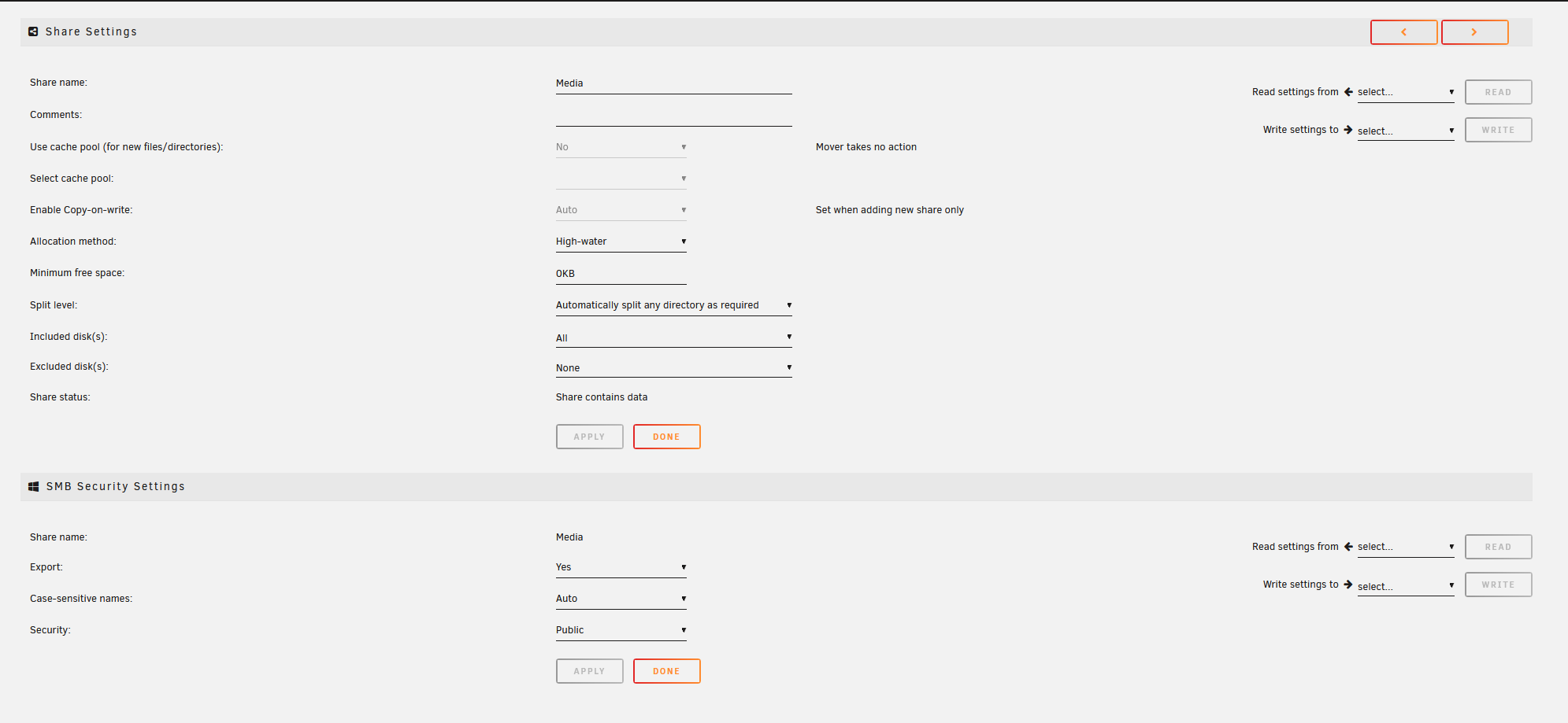

  2. Hi there I was wondering how high water should work? I thought it would fill up all disks equally. I did activate it when all 3 disks had 2 TB free space but it seems to only fill up the first disk. I have set the split level to "automatically split any directory as required". From what I could find in the forum this should work, but it doesn't. Why is that?

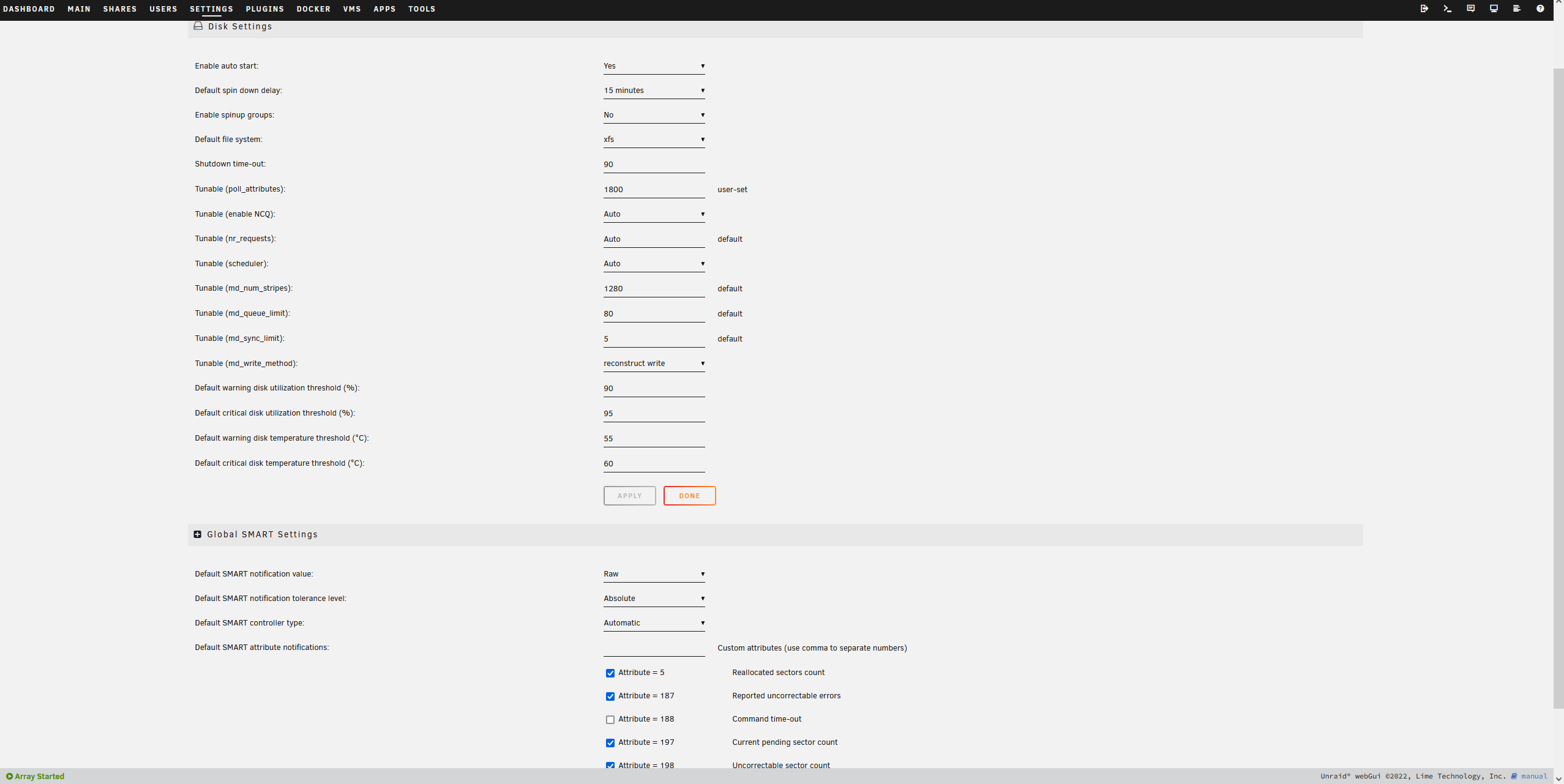

  4. I did turn off both but I still had write speeds around 10 MB/s. Then I did shutdown the server and after a while boot it back up. Now my write speeds are back at 110 MB/s. I have no idea what caused the slowdown but it works again. Thank you for your help.
  5. diagnostics-20221225-2132.zip

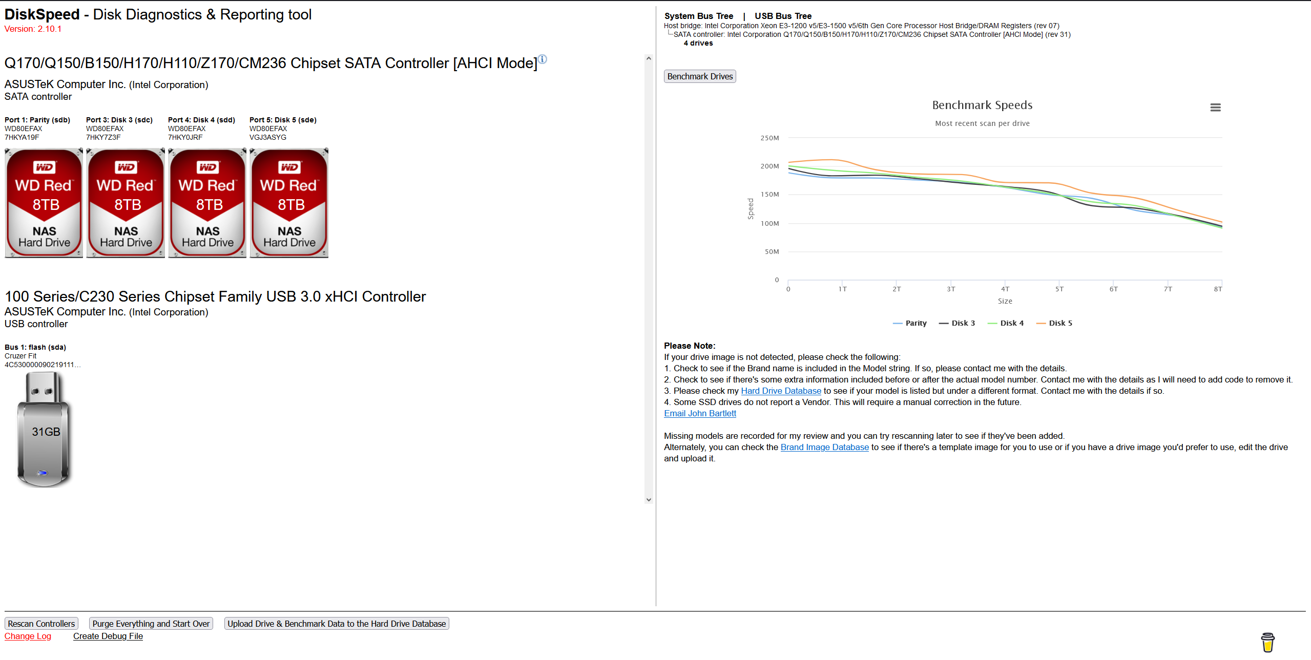

  6. Today I did transfer two movies with over 100 MB/s from my windows PC to my unraid server. But now any other File will be around 10 MB/s. I did check for unraid updates and restarte the server and my PC several times. I did test my HDD speeds with the "disk speeds" plugin but nothing abnormal could be found and nothing works. It seems that it will write on one of my disks and on the parity disk at the same time. It seems like it uses "read/modify/write" mode. The shares are all set to "High-Water" so as far as I could find this should work, and did work just hours before. Where should I go from here? What could I check? Does anyone have any idea what is going on?
