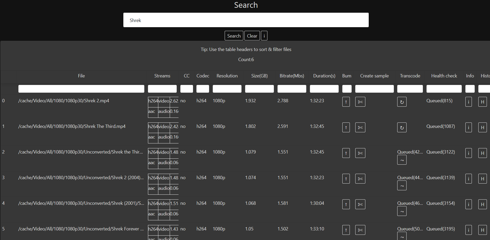

Tdarr Application: Tdarr - https://github.com/HaveAGitGat/Tdarr Docker Hub: https://hub.docker.com/r/haveagitgat/tdarr GitHub: https://github.com/HaveAGitGat/Tdarr Documentation: https://github.com/HaveAGitGat/Tdarr/wiki Discord:https://discord.gg/GF8X8cq Reddit:https://www.reddit.com/r/Tdarr/ GitHub Summary: Tdarr is a self-hosted web-app for automating media library transcode management and making sure your content is in your preferred codecs. Designed to work alongside Sonarr/Radarr and built with the aim of modularisation, parallelisation and scalability, each library you add has its own transcode settings, filters and schedule. Workers can be fired up and closed down as necessary, and are split into 3 types - 'general', 'transcode' and 'health check'. Worker limits can be managed by the scheduler as well as manually. For a desktop application with similar functionality please see HBBatchBeast. - FFmpeg/HandBrake + video health checking (Windows, macOS, Linux & Docker) - Use/create Tdarr Plugins for infinite control on how your files are processed:https://github.com/HaveAGitGat/Tdarr_Plugins - Audio and video library management - 7 day, 24-hour scheduler - Folder watcher - Worker stall detector - Load balancing between libraries/drives - Tested on a 180,000 file dummy library with 60 workers - Search for files based on hundreds of properties - Expanding stats page Currently in Alpha but looking for feedback/suggestions. unRAID setup screenshots below: Usage examples: https://gfycat.com/cooperativetestyjaguarundi https://gfycat.com/uneveninconsequentialguernseycow For unRAID please see the following screenshots for the MongoDB and Tdarr container configs: 2019-12-16: Please note I'm on a 2 week break. Sorry for the inconvenience.
