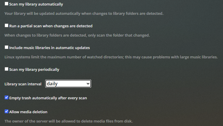

Have you ruled out Plex doing a scan of the media?

Should turbo write be disabled then?  I've just double checked Plex and _NOTHING_ is being scanned:
Just trying to get this resolved as I'm going to be adding in another drive (need to preclear it first).
