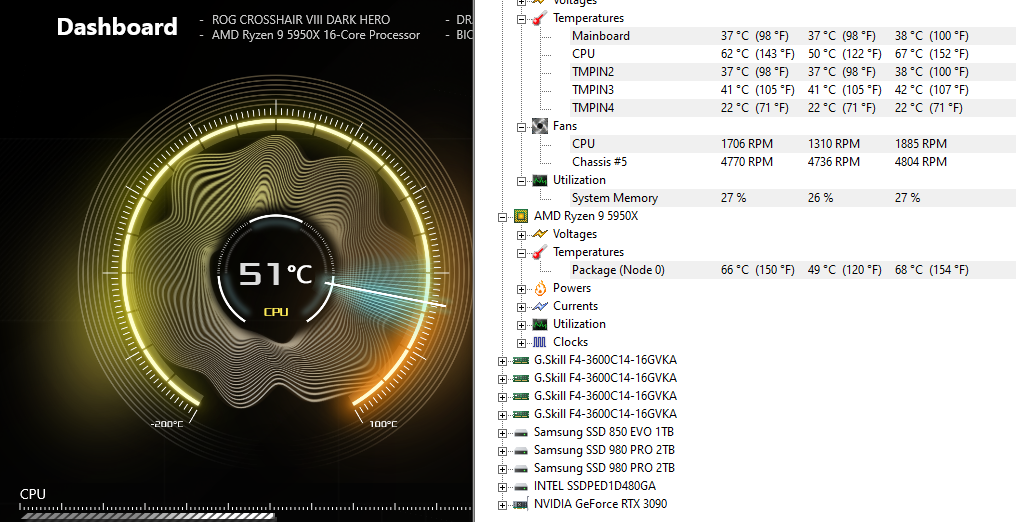

Reported temps probably have the wrong offsets in the driver, I see weird temp reporting variations in windows... which one of these 3 temps is the right one here ? haha
As long as you have appropriate cooling on there, I wouldn't worry too much unless it starts throttling a lot.
