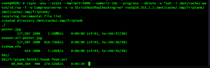

Here is my rsync call:
rsync -avu --stats --numeric-ids --progress --delete -e "ssh -i /mnt/cache/.watch/id_rsa -T -o Compression=no -x -o StrictHostKeyChecking=no" root@NODE:/mnt/user/TV/Popeye/ /mnt/user/TV/Popeye/
Here is a small sample of the rsync transfer log to illustrate the sudden and sharp  drop in speed:

     61,440,000  59%  757.02kB/s    0:00:56  ^C
rsync error: received SIGINT, SIGTERM, or SIGHUP (code 20) at rsync.c(701) [generator=3.2.3]

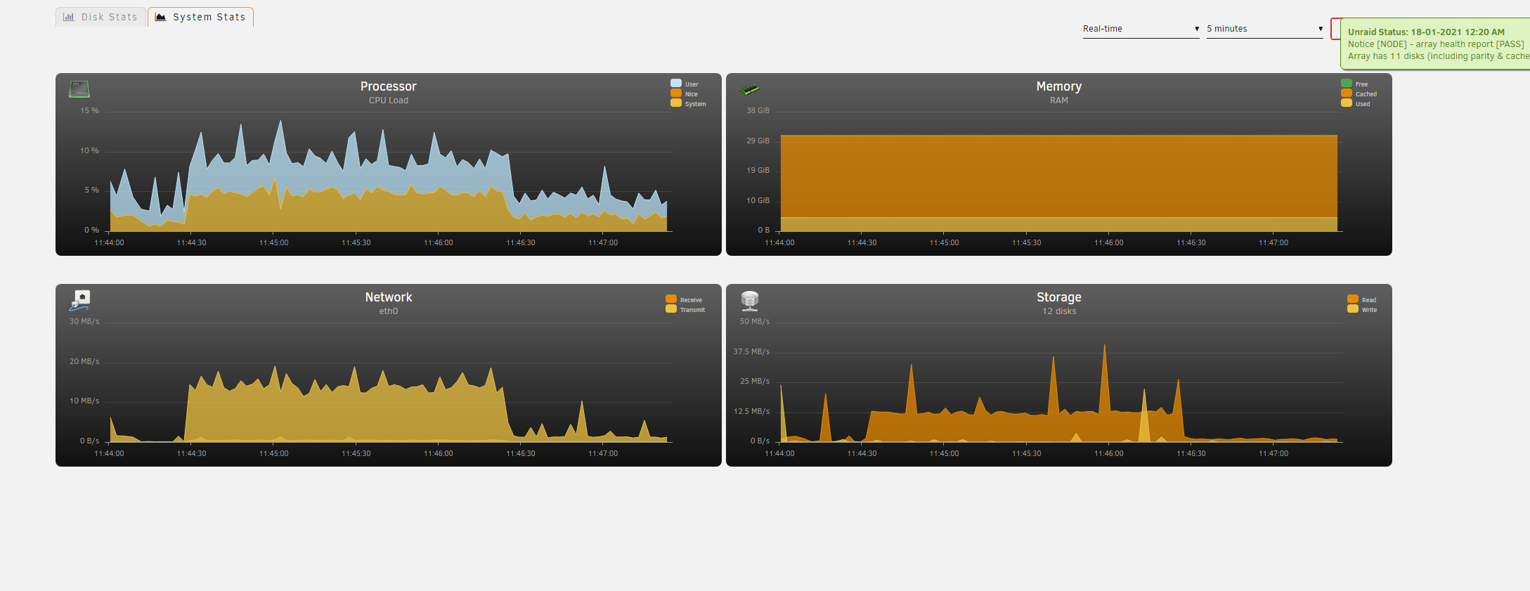

and my accompanying stats page during the same transfer. You can see the sudden decline around 11:46 which coincides with my sudden drop in transfer speed above:
I don't see anything telling in the system logs on either server when this speed drop happens. It almost seems like a buffer is filling up and not being emptied quick enough, causing the speed to tank.

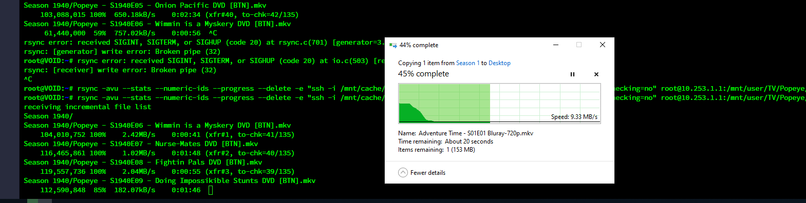

I've played with every rsync and SSH option I can think of (--whole-file, --inplace). It doesn't matter if the data goes straight into the array or all gets written to a cache disk first.
Copying outside of SSH (ie using Windows file explorer) saturates my bandwidth (full 10MB/s) as expected but SSH can barely manage to maintain 1MB/s
EDIT: Copying via rsync/SSH from other servers I have access to do not suffer form performance issues. I'm able to max out my home internet bandwidth.

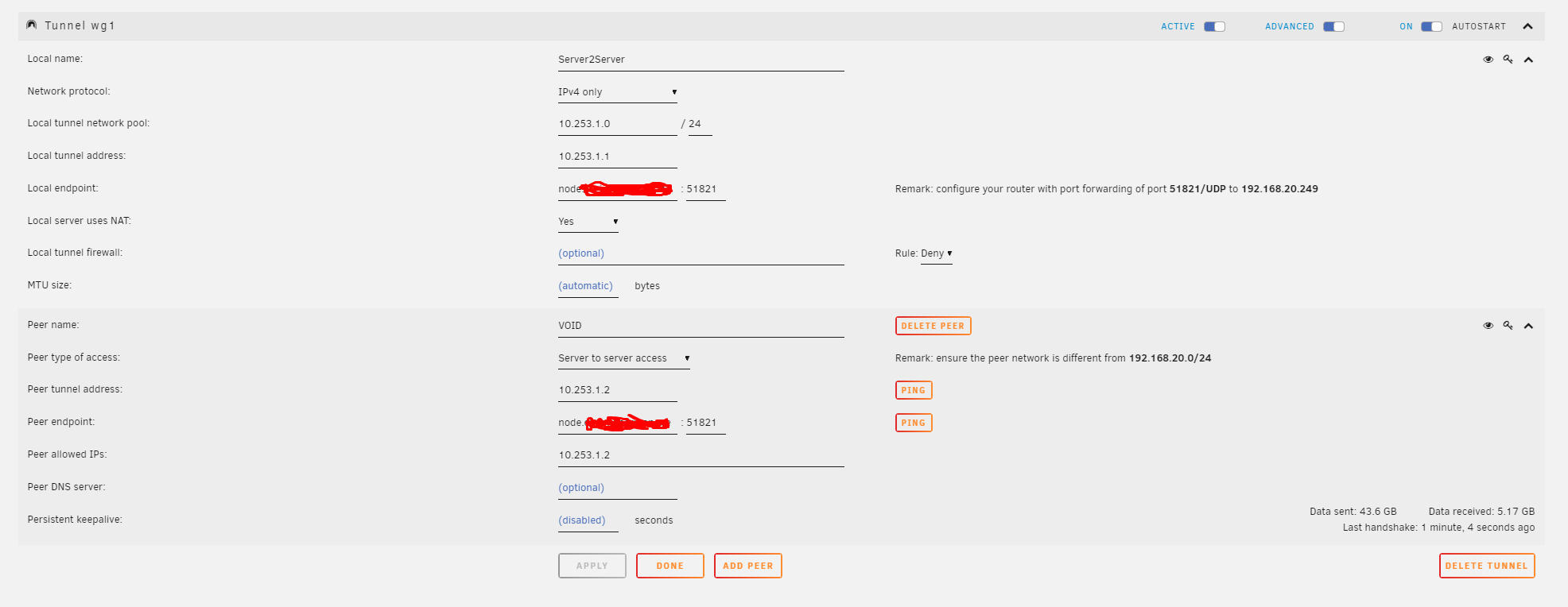

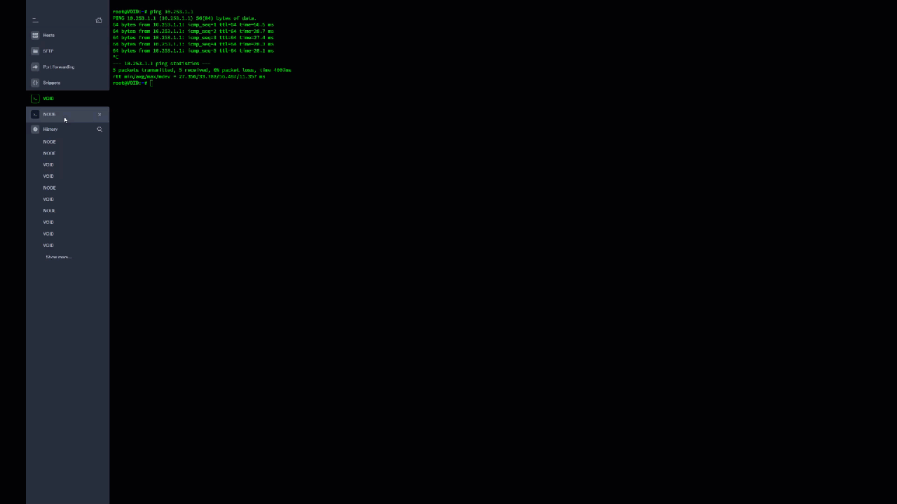

@ljm42 I'm noticing an odd behavior with my server to server wireguard tunnel...
When I'm signed into NODE, I can't ping VOID initially. Once I start a ping from VOID to NODE however, replies start flowing both ways...
This is not something I had noticed before. Should I enable keep alive to prevent this?
I'm going to snag a video of this behavior.
EDIT: So as you can see in the video, I start to ping VOID's WG IP on NODE and get no replies until I start a ping from VOID to NODE. Then like magic all of a sudden NODE realizes VOID is, in fact, available.
Setting a keep alive will mask the problem, but if it were me I would want either side to be able to start the connection.

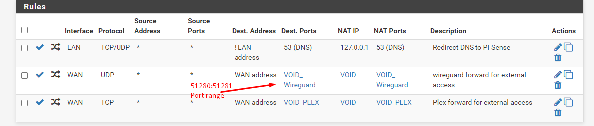

If the connection can only be started from one side, then you need to check the port forwarding and "peer endpoints" for the other side.
It sounds like VOID has the proper peer endpoint to be able to reach NODE, and port forwarding is setup on NODE's side to accept it. But there is a problem going the other way, likely the peer endpoint is wrong or there is a problem with the port forwarding. Connection problems are very difficult to troubleshoot as WireGuard fails silently and there are no logs, I've tried to consolidate a bunch of info in the first two posts here: https://forums.unraid.net/topic/84226-wireguard-quickstart/

When I first setup WireGuard I definitely tested this and both ends were able to start the connection so I'm not sure what changed there.
My router here with VOID is a pfsense router and from what I can tell my port forwards are setup correctly:
I'll look those threads over again as I'll admit my grasp of wireguard when i configured it was tentative at best and its all looking greek to me now looking back at it.
I think I see my problem though, on NODE I have the peer address set to the same thing as my local endpoint. The peer for VOID should be my dynamic DNS name for my home IP right?

Started a cache (NODE) to cache (VOID) transfer and barely made it into the first file before the speed tanked.
Meanwhile I've been uploading files from VOID to NODE for the last hour at full speed. 10GB files at 2.8MB/s (the max for my crappy comcast upload).
This is the part that drives me nuts, I can't seem to find a pattern to what transfers utilize their full potential speed while others just languish in the land of dial-up.
Yeah on NODE, the peer address for VOID should resolve to VOID's public WAN IP, which is then port-forwarded to VOID's internal IP. That peer address is what NODE will use to contact VOID to start the tunnel.
Well that is good really, it means parity calculations on the Unraid array are not the issue. But I'm struggling to think of what the issue could be.
Ok the WireGuard issue is fixed, now either server can restart the connection.

I also wonder why it only seems to affect SSH/RSYNC transfers for me. I can use Windows file explorer to copy data at full speed.

I've been playing with iPerf3 to see if I can saturate my wireguard tunnel with other programs/protocols. My hope is to determine if this is in fact an SSH/RSYNC issue or if this random speed issue is WireGuard itself.
With NODE running "iperf3 -s" and VOID acting as the client with "iperf3 -c 10.253.1.1 -t 30 -P 8" I can only seem to get about 20-25Mbps....
Cranking parallels up to 30 made no difference, I still maxed out at a meager 25Mbps. Is this indicative of a bigger problem or am I just not using iperf correctly? This is my first time messing with it so I'm inclined to think I'm doing something wrong with my test.
