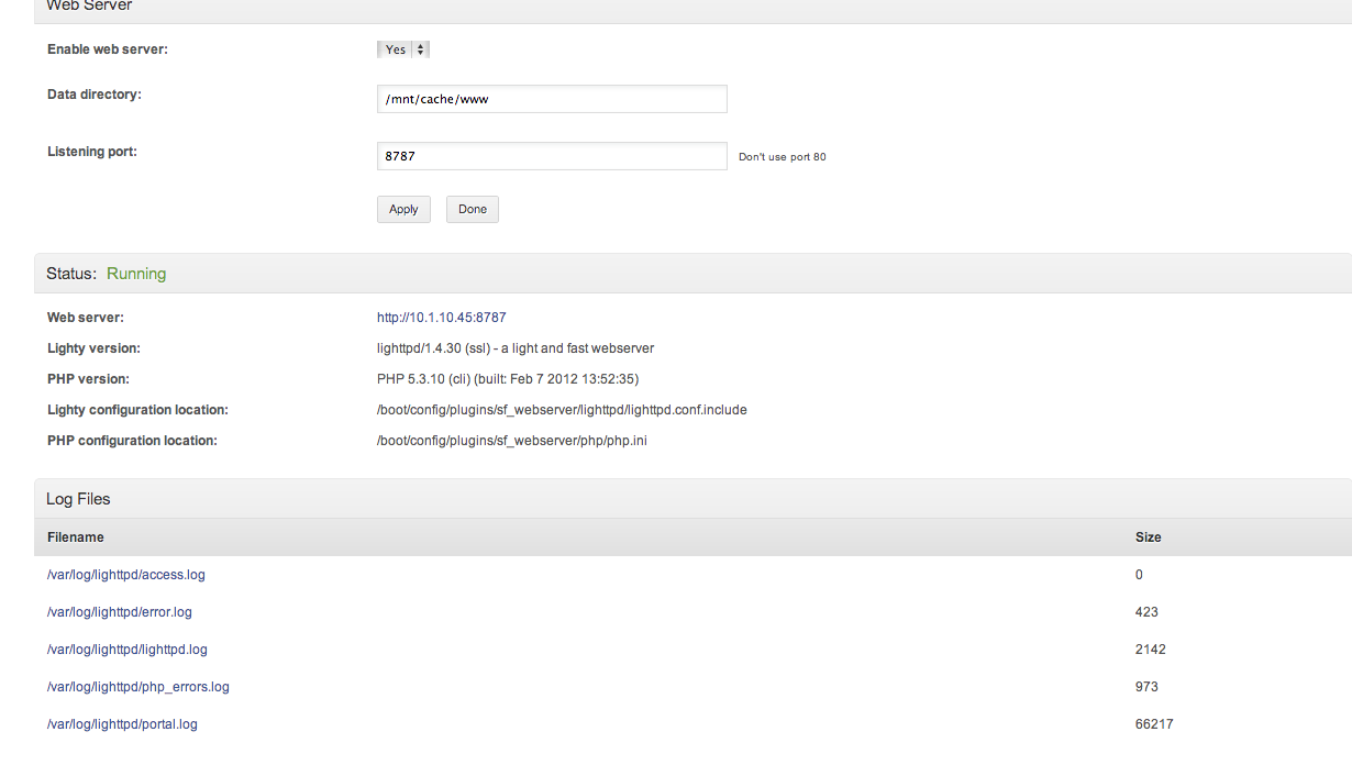

could it be the version of PHP installed?  i originally had unraid-web installed through unmenu.  i removed that and disabled php from installing automatically through unmenu, however, it still says php is installed but newer then the one available.  but i know that simple-features web server comes with php so im guessing thats why.
i did change the ip address of
vboxwebsrv -b -H [actual ip here] --logfile /dev/null >/dev/null
to my own settings.  but still nothing.
This is the error i get when logging into phpvirtualbox

this is a screen shot of my web page from simplefeature

Another thought. It has been awhile since I managed a web server for others in my job. When I use a web server, I create subdirectories for anything I download. Like in this case, my web directory contains a directory named phpvb. Inside phpvb, I have all the phpvirtualbox files. When I access phpvirtualbox, I use http://lament:8084/phpvb/ instead of having it installed in the root directory using just http://lament:8084/.
I mention this because I vaguely remember the default settings of some web servers that I managed in the past not displaying some php pages correctly. We tried & tried to use the root directory, but something prevented it from working (& I can't remember what it was). Ever since I have just used subdirectories if I am using files created by someone else. I will usually create my own basic html file that provides hyperlinks to the subdirectories & my html files worked.
Like I said this is just something I vaguely remember happening... but if the above changes do not work, well it is something else to try.
Thanks for all the replies.  i have copied everything that you posted into my php config file and saved it and im still getting the same error.
is there a way for me to confirm that the web interface portion of VB is running for virtualbox?  i know that the web portion of simplefeatures are working.
im at a loss of what to try next.  i am not sure i didnt screw something up with trying to install virtualbox the original way earlier in the post by trying to build the headers and linux.  but i have rebooted since then and everything else is working as it should.
