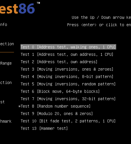

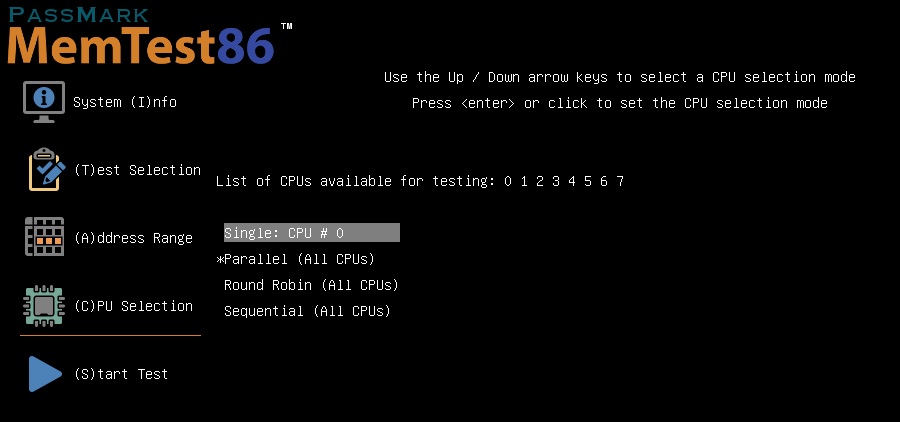

I would suggest you try new UEFI memtest86 ( I just try it yesterday ), some test will use all CPU core ( you need enable it ) which I doubt legacy memtest won't use all core ( may be wrong and I don't trust legacy memtest )

@Vr2Io hi Thank you for providing this bit of Memtest. I went about to running this mem test and I found many errors. I didnt see this error with unraid memtest running by default. I guess if im seeing errors running the multicore memtest but not seeing it running single core can it be possible that its a CPU problem? or do I still have a memory error? at the moment im running this memtest benchmark with my new pair of 16GBx2 sticks of ram. I will try again to remove the ram stick and replace with my previous stick of 32GBx1 ram stick
