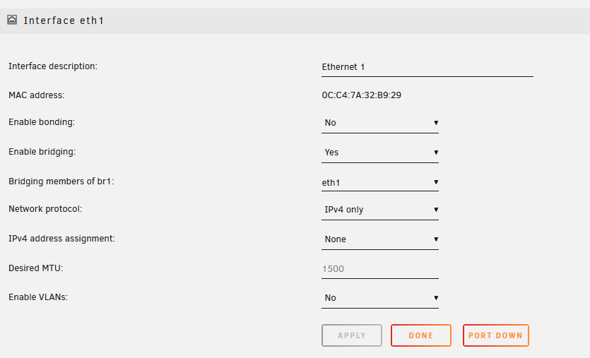

OK - I had the same error in FCP and was following @Moose808 kind instructions above but made a typo (I think) and now cannot get into the unRAID Web Interface.
Is there a way I can get back in perhaps by LAN cable directly into the unRAID box?  I cannot ssh in...
If not - I gues I can hook a monitor and keyboard up? Is there a way to reset the ethernet devices or edit them from the shell?
Thanks!
EDIT: Hooked up monitor and keyboard and booted in to safe mode.
Edited by TexasDave

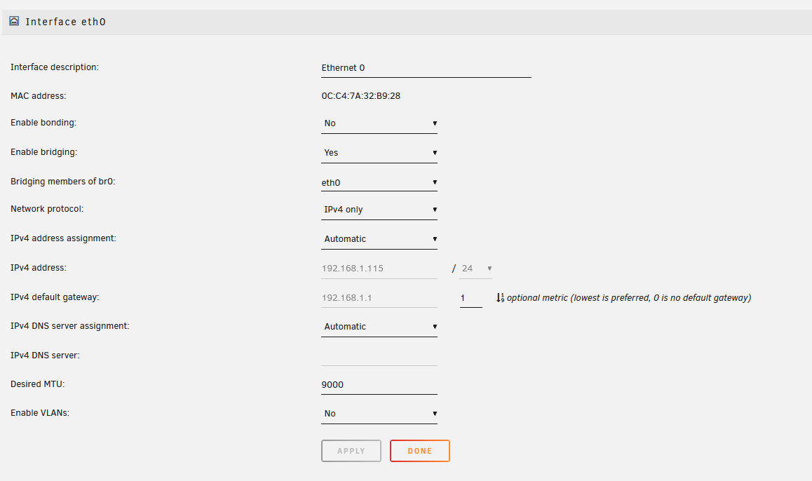

OK - back in by booting in safe mode turning off the second eth1.
Atatched are the two entries for eth0 and eth1.
If I wanted to get rid of the original Fix Common Problem error - how would I configure eth1 (along with eth0)?
Or just leave it off for now? My system is working again and no errors from FCP
Thanks
Edited by TexasDave
The key thing is you should not have two network interfaces connected to the same network unless they are bonded; TCP/IP networking isn't meant to work that way. Things will "mostly work" but then some day you'll have a weird problem that you can't explain, such as WireGuard responding on eth1 but not eth0:
 https://forums.unraid.net/topic/86021-wireguard-shows-data-inout-but-no-handshake/?tab=comments#comment-948325
(that is just an example, certainly not the only thing that could go wrong)
This site has good background on using multiple network interfaces: https://www.ni.com/en-us/support/documentation/supplemental/11/best-practices-for-using-multiple-network-interfaces--nics--with.html#section--1358462000
The key statement being "Avoid Assigning Multiple NICs in the Same Computer to the Same Subnet"
The simplest solution is to disable eth1 in the Unraid webgui, and physically unplug the network cable from eth1.
Or return to Unraid's default - a bonded connection with eth0 and eth1 in bonding mode "active backup". This allows you to plug a network cable into either eth0 or eth1 without having to know which port is which on the back of your computer. You could theoretically plug in both ports, but there isn't much point in that kind of redundancy in a home environment. There is no speed improvement.
Be sure to read the inline help and search the Internet if you want to try other bonding modes, most of them require you to have a managed switch specifically configured for the bond. A good starting point: https://wiki.linuxfoundation.org/networking/bonding#switch_configuration
One other thing to mention - a bonded network connection has a unique MAC address, different from either of your physical nics. So if you turn bonding on or off you will likely get a different IP address from DHCP.
P.S. There are some advanced configurations where multiple nics on the same network are fine. If you are sure your use case is valid then you can ignore this test. But if you haven't done anything special to allow both nics to coexist on the same network then you really should consider removing one or moving to a bond.
