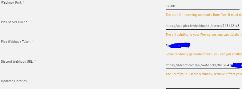

Heres my current config:
23 hours ago, Wizaro said:
I got that entry from the URL of the XML file of one of my movies but apparently that token changes cause I opened a movie today the same way and that token had changed to this:
I tried changing it to the token above and the behavior didn't change, still just shows the thumbnail in discord.

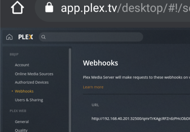

Ok, so the PLEX_WEBHOOK_TOKEN can literally be anything you want, just type some random value in here. This token is then used in the URL, where PlexAnnouncer is listening for incoming Webhooks from Plex. So in your case: http://localhost:32500/1fkD...
You then need to put this URL in your Plex settings, where you added the Webhook. From the behavior of your issue I guess that you added the Discord Webhook URL instead here. That's how it looks in my config:
Note: You may have to replace localhost with the IP address of PlexAnnouncer (like I did) if they aren't run on the same host.
You were 100% right! Thats exactly what I did, working now thanks so much!!!

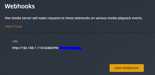

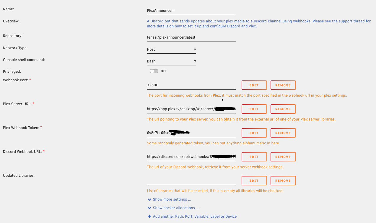

Ok I am at a loss.  I feel like I have everything set up correctly but not getting push notifications in Discord channels.  Here's what I got:
image.png.74d56334f955311b0d2d8cd03b07020c.pngimage.png.51f2957b130aa93d1667a501731c7aeb.pngimage.png.c9fd060af4a23e537195e6c88973a0a8.png So I think I have my Plex settings right.  Here's my docker settings:
And of course the Discord Webhook URL matches the "copy webhook URL" from discord.

And in the process, I think I figured out the issue.  In Plex Settings, I added:
I think this needs to read :32500 and not :32400.  I just need to test it.
Edited by Hawkins12
Oh yes, didn't see... You are absolutely right, that's the issue!
