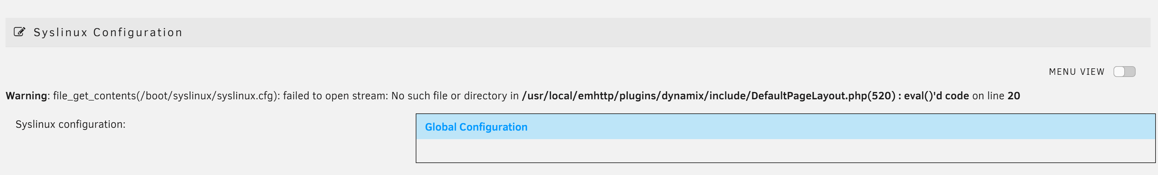

BTW accessing my Unraid from the network the flash drive looks empty. No surprise it asks for a missing key.

This is what shows if I click on the Flash drive in the Main page.

Yes, flash drive dropped, it either a flash or USB controller problem.

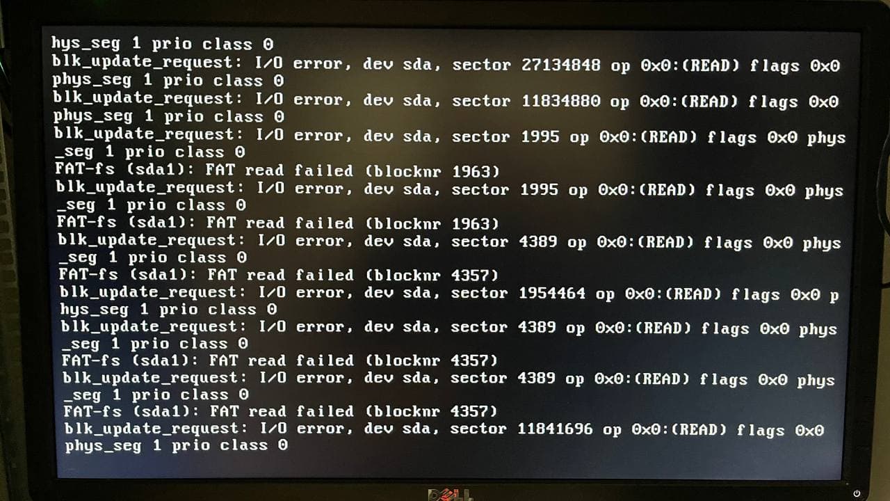

I have an issue that looks similar.
Also not sure if it is a coincidence but this happend lately:
I updated my BIOS Version and went to unraid 6.9.2 and had the issue that my system only kept up for some hours (between 3 and 12 hours). A tried several BIOS Settings regarding power settings, because i thought i missed something when i made the BIOS update. I had to reboot the server every time.
One time all my docker container were also not accessible.
I deleted the docker image and reinstalled them, then they worked fine again, but the freezes didn't stop.
Maybe it is a coincidence but my config.php of nextcloud seems empty but it is still working properly (as long as the server is up and running...).
I try now to get it back from one of my appdata backups, but still wondering why nextcloud is still working...
- Edit: I tried to edit the folder "config" instead of the "config.php" in the folder config, so this is not an error ;)
Now i was able to see on the connected monitor some errors on different blocknrs:
"FAT-fs (sda1): FAT read failed"
"blk_update_request:I/O error, dev sda, sector .... op 0x0:(READ) flags 0x0 phys_seg 1 prio class 0"
See attached screenshot.
I got an actual backup of the flash drive but i am not sure if it is about to fail.
Edited by Harlequin42
Those messages definitely indicate that the system is having problems reading from the flash drive.   I would suggest that at the very least try plugging it into a Windows/Mac system and let that check the drive.
Sometimes simply rewriting its contents can help.  Maybe even just downloading the zip file from the unRaid site and extracting all the bz* type files overwriting the ones on the flash drive might be sufficient.
If the flash drive is about to fail do you have a backup of it?   In particular the ‘config’ folder and its settings as that contains all the user specific settings and the licence file.
