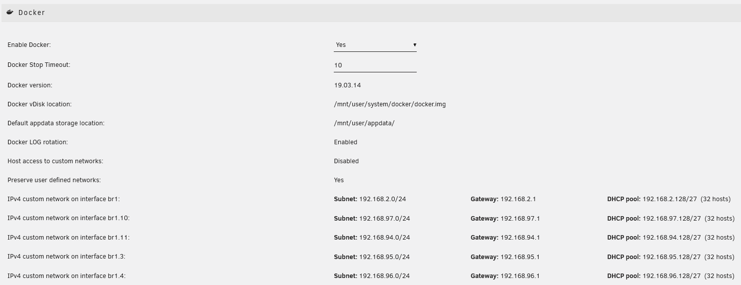

I am trying to assign a Unifi Controller docker container to an external network so it can manage our Access Points. The NIC is attached to the external network and was able to receive an IP address via DHCP. The interface (br2, 172.17.0.0/24) is enabled in the Docker settings page.

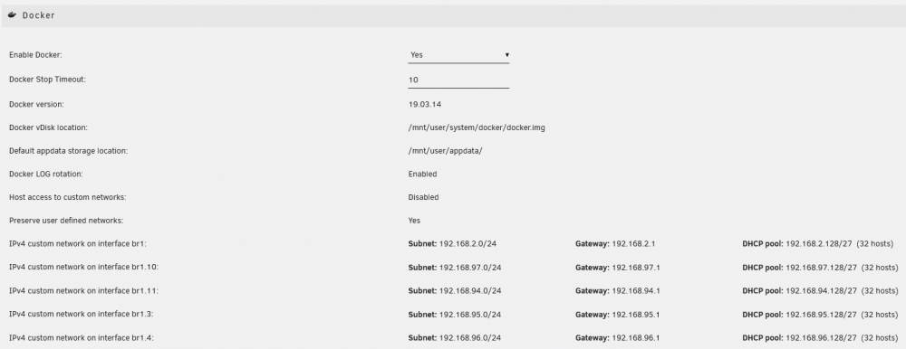

Unfortunately, I've seen two issues: At boot-time I see an error message that says "br2 not found" and br2 isn't available in the Docker settings for Docker images:
I'm at a loss here. What do I need to do to enable br2 on my Docker images?
br2 is the network I'm trying to attach the docker container to. This would be subnet 172.17.0.0/24.

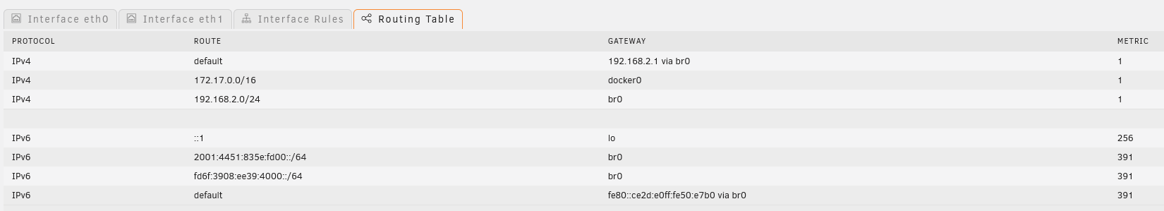

I currently have no docker containers attached to that bridge (since it's not an option). I assume that the 172.17.0.0/16 route connected to "docker0" is illegitimate so I tried to delete it - to no avail; the delete button asks me to confirm but never actually removes the route. I suspect this might help point towards a solution.
EDIT: I deleted the 172.7.0.0/16 route using the command line: ip route del 172.17.0.0/16
The route was removed from the table but it hasn't helped me apply br2 to a docker container.

You're screen shots indicate the a bad config:
* br2 is 172.17.0.0/24 (which is a subset of 172.17.0.0/16
* you have 3 default gateways (which will invariably confuse the OS as to which interface to use to talk to the world)
I suggest you try renumbering br2 to some other sensible IP range 172.20.0.0/24 or the 192.168.x.0/24 if its a possibility
and make sure the default routes are really what you want (most of the time it isn't), and it can be resolved by either specifying no gateway on the other interfaces.
