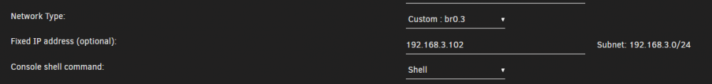

2 hours ago, zero_koop said:
or the Nextcloud IP address static
Assigning static IP addresses to docker involves making the appropriate network selection in the docker container.
I set up a VLAN in my router and unRAID specifically for docker containers to which I wanted to assign a static IP address.  It shows up as Custom:br0.3 in the Network selection in the container.
If you have your eth0 bridged in Network settings, you should also have a Custom:br0 that will allows the same.
I followed the same rules here as with static address and the router DHCP and I did not allow the VLAN in unRAID to assign DHCP addresses.  I wanted to manually assign them and so I made sure they were not in the router DHCP range as the router DHCP and VLAN DHCP have no concept of communicating with each other and need to be in separate ranges to avoid any possible conflicts.
Edited by Hoopster
