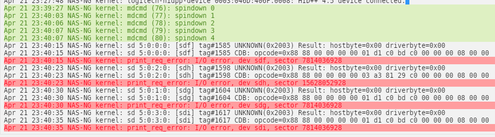

Marc_G2 Posted April 22, 2021 Author Share Posted April 22, 2021 So these errors are a more concerning. Why am I getting drive errors right after they all spin down? The server is in maintenance mode at the moment, so does that have something to do with it? Quote Link to comment
JorgeB Posted April 22, 2021 Share Posted April 22, 2021 6 minutes ago, Marc_G2 said: The server is in maintenance mode at the moment, so does that have something to do with it? No, and those errors after spin down are not that uncommon, and not a real problem, sometimes changing the disks APM level or disabling it helps. 1 Quote Link to comment
