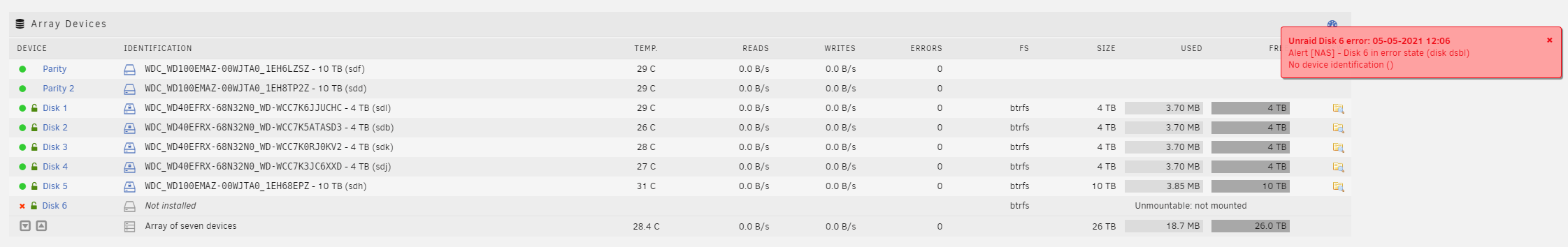

Shouldn't the disk be emulated and the data immediately accessible?

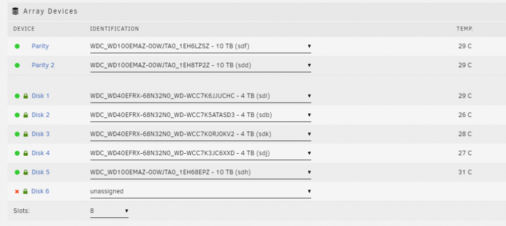

Thanks for the fast reply. Okay the data is very important for me - im just going to get a new 10TB drive and i hope that it does lower the risk of losing anything by simplifying the process. (My backup is on year old because the rsync to an offsite server seems to have failed since a long time - my bad, my issue but lets hope i can recover the drive)
So i just put the new drive in and start the array?

Assign it to that slot and start the array.

According to the screenshot you added after those replies, the emulated disk is unmountable, which means filesystem corruption that will need repairing, possibly with some data loss.

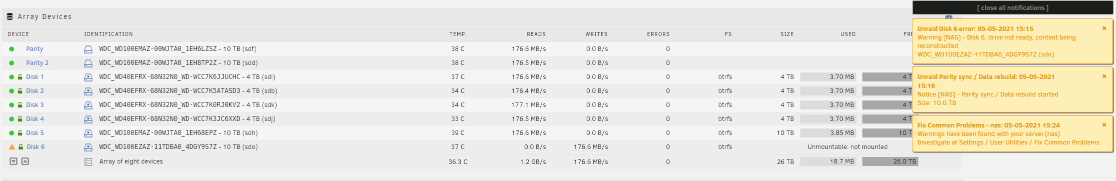

The rebuild is now running. How can i repair an encrypted BTRFS filesystem?

No valid filesystem is being detected, so there's serious damage to the superblock which may make recovery difficult, all your other disks are empty, was that the only disk with data?

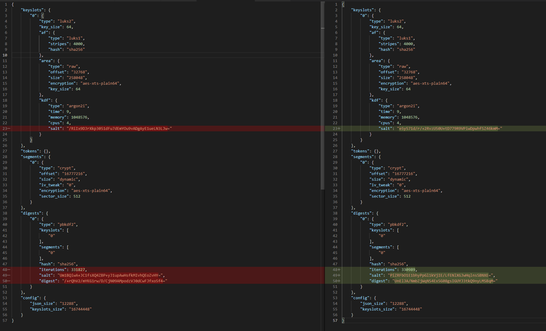

Now the ironic part: Yes, you can copy the header - kind of. The important values are marked here. I am comparing two valid drives. So unless unraid stores a backup of the highlighted values or the rebuild succeeds i'm definitely out of options. By getting myself locked out of the disk. I bet the data on the disk is still fine.
The part i don't understand is why the header got destroyed.
