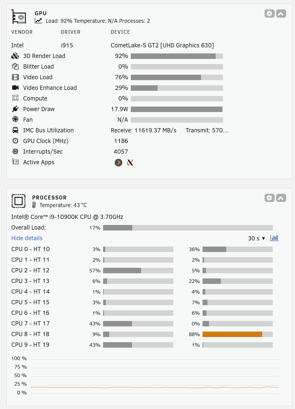

Apologies I know I've commented on a few different driver posts. So I have experimented with NVIDIA and now I'm trying out IGPU driver. https://forums.unraid.net/topic/98978-plugin-nvidia-driver/page/207/

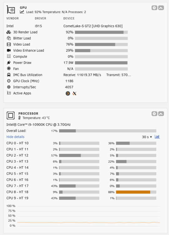

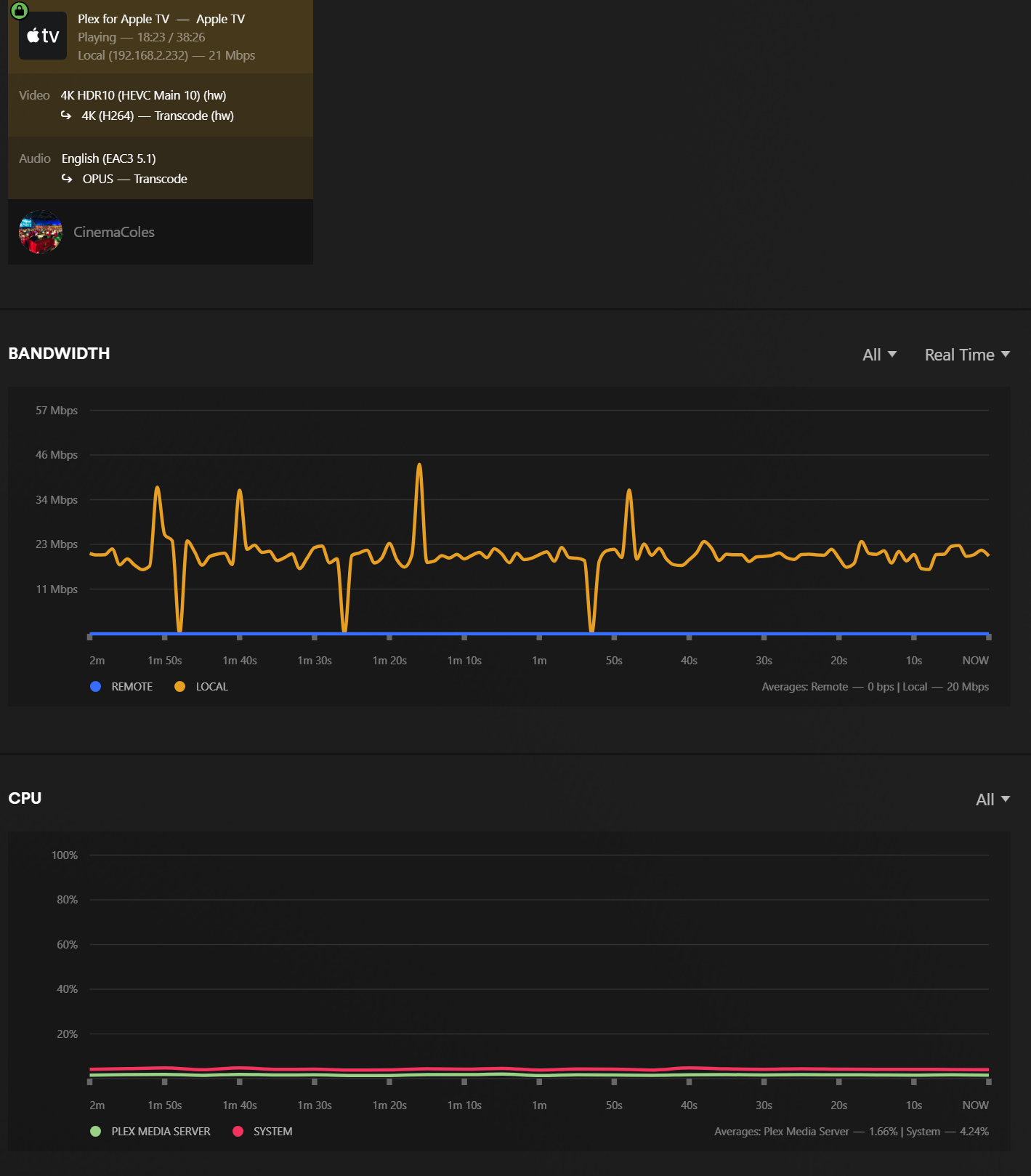

This is a screenshot from a DOCKER container using IGPU:
So still OPUS transcoding audio and yes you were right there are hard encoded subtitles. IGPU is working significantly less hard than the CPU with the NVIDIA old GT750ti GPU (in docker).

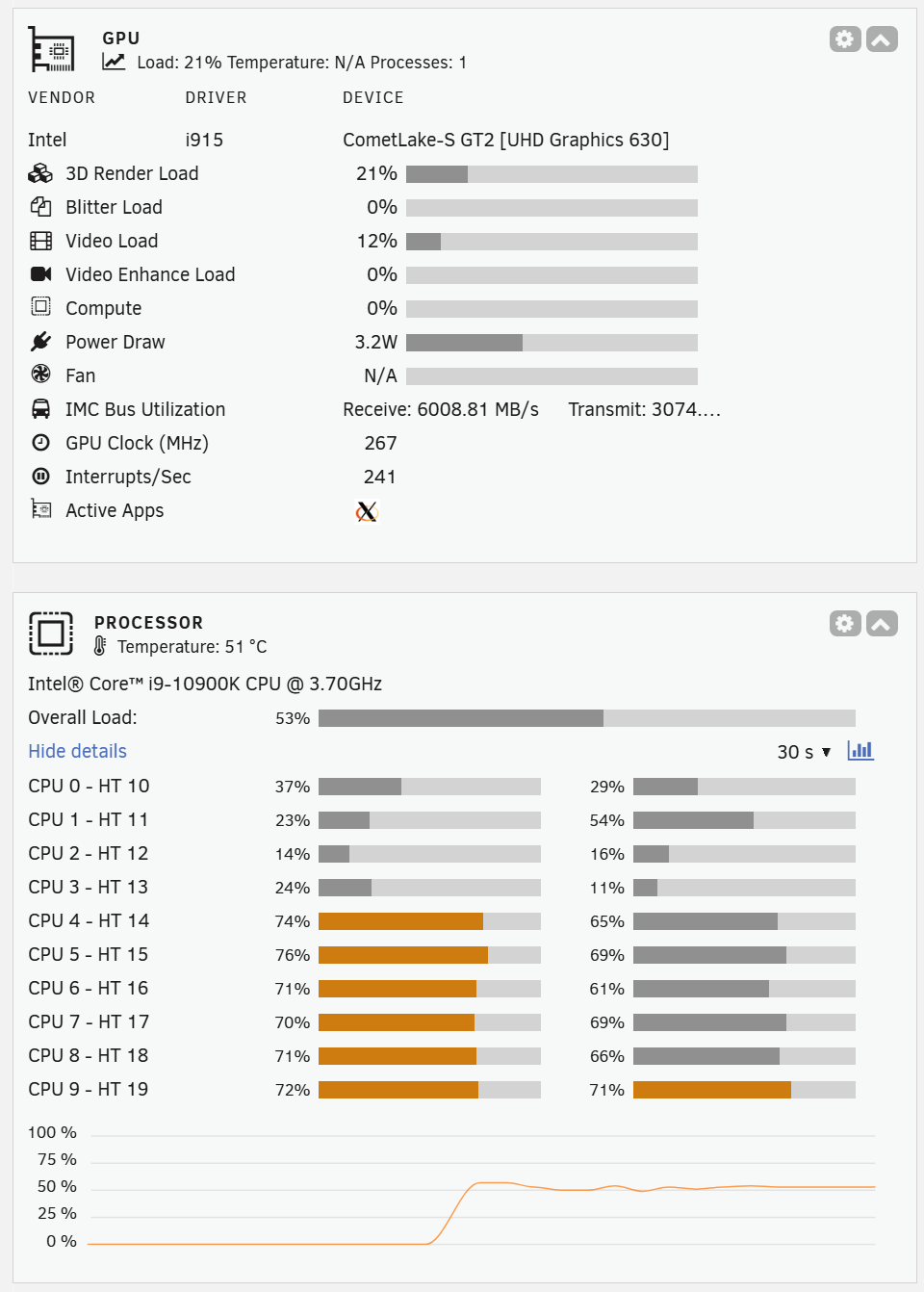

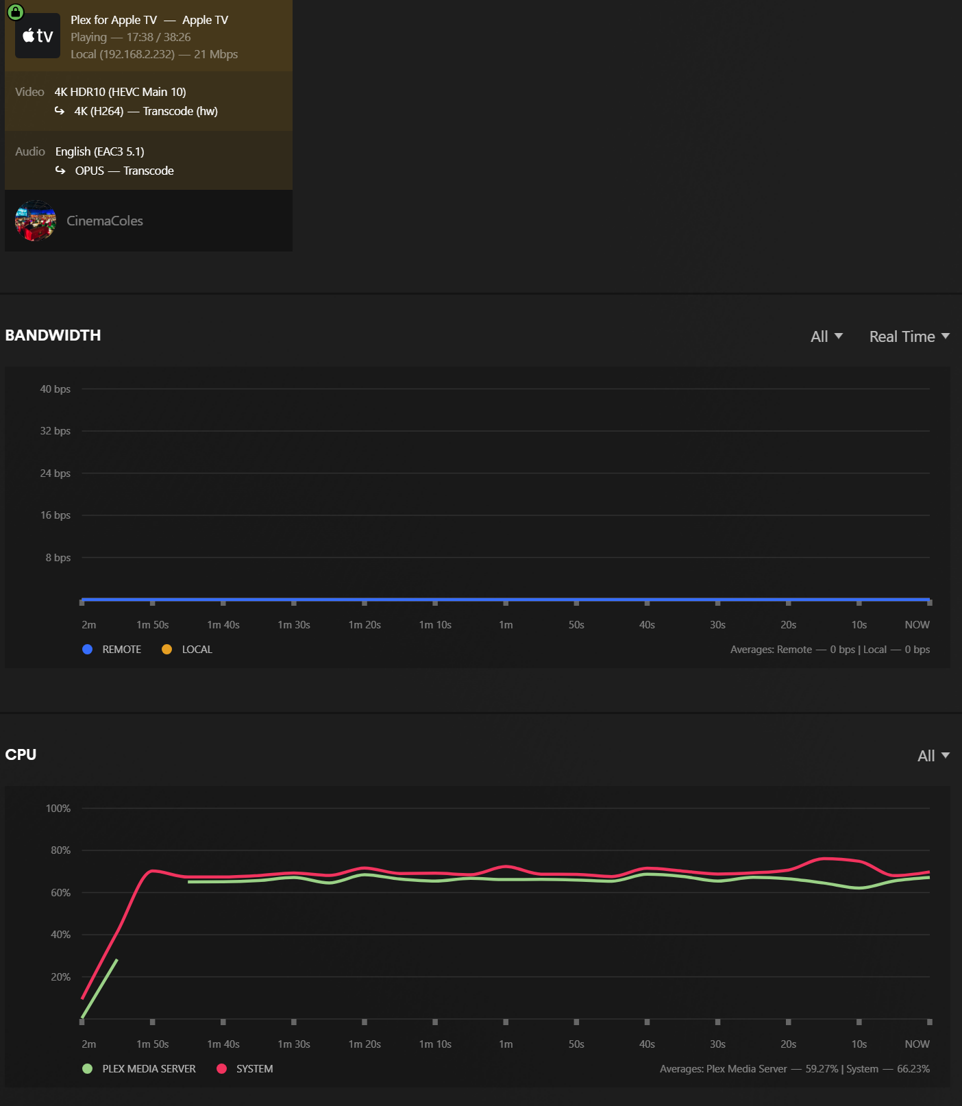

So I am also testing environments, and below is a Win11 VM (unlike the docker above):
You can see that the VM the GPU is working less hard and the CPU is working harder than the docker.
Because you are now transcoding to 21Mbps, this is another transcode, you can't compare 4K Dolby Vision with 4K transcoding and different bitrates.
Yes and no, this is a virtualized environment and I don't know what resources you've assigned to the VM and also GVT-g is not the same as the if you where using the iGPU directly.
These are not equal comparisons, also you test Linux against Windows and these two systems work way differently, I don't even know what Plex is using on Windows and if they are using something else than a modified version from FFMPEG.
However, what is your goal here with these tests?
I really don't get the purpose here, sorry for asking but I don't see anything wrong.

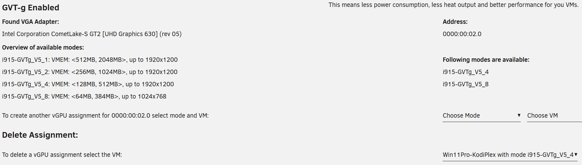

23 minutes ago, SmokeyColes said:
So I ended the VM, and reapplied the assignment.
You have to edit the VM XML manually and remove the mediated devices.
