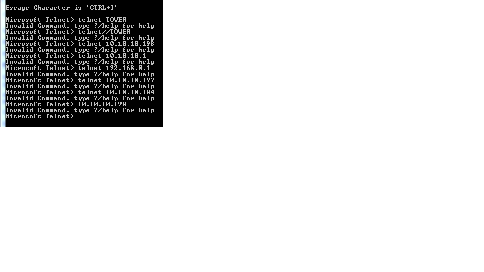

I turned on Telnet Client and in the box I typed this ( tail -f /var/log/syslog ) and it is saying invalid command.
you need to telnet into the server first by typing
telnet IP_ADDRESS_OF_SERVER
then type the command I gave earlier.
I am typing telnet and ip address. Here are the IP addresses in my router and I used them all.
Try using putty. Google putty. Or does anyone know Microsoft telnet?
Errr .... if you're at the telnet prompt, you don't need to type 'telnet', rather you should use 'open <address>'.
You use 'telnet <address>' if you're at the O/S prompt, eg C:\> telnet tower.
Geeze, if you type the ?/help as suggested you might get some info on how to use it...
Peter
I have not used telnet built into Microsoft Windows... I have always used putty.  From my quick searching it appears telnet is disabled by default on Windows 7 so has to be enabled.
You can use the Windows telnet or you can download and try using putty.
If you can load the unRAID webGUI you can grab the IP address of the server from the "Settings" page.
from there use putty to telnet to the IP address and then with the tail command I gave earlier.
