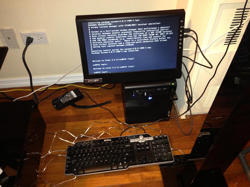

Nifty lil machine.
The monitor I have is the GeChic 2501. It has all sorts of cool features.
GeChic On-Lap 2501M 15.6” LCD Monitor with built-in battery. It supports HDMI, MHL and VGA output.
http://www.newegg.com/Product/Product.aspx?Item=9SIA0V10H35673
Since my new apartment is much smaller then the old one, I have to get creative about how many monitors and how long they will be connected. This puppy is battery and/or usb powered with a VGA adapter MHL and HDMI adapter.
I'm using a DELL Bluetooth keyboard until everything is stable and I no longer need to access the console.
