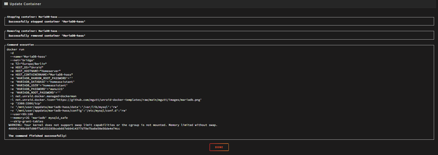

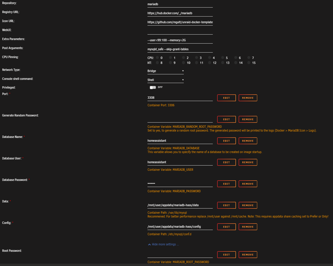

i put this like u told in the post arguements:
press apply and the docker isnt starting
the log told me:
