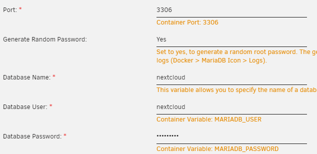

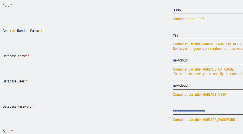

These are the settings I used to create the MariaDB container:

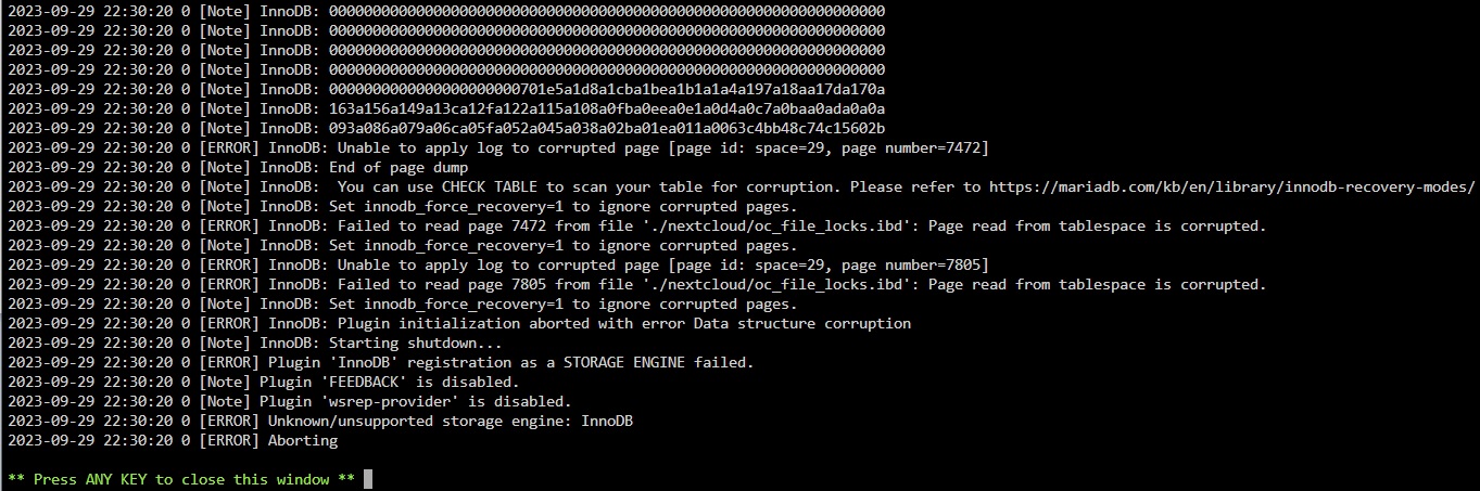

After a recent update it would seem that I'm having trouble with "InnoDB."
Any thoughts on the following? So far I've tried downgrading all the way back to 10.11.3 and I still seem to get the same error.  I've tired a few things but still seems to be in a loop.
Update, I ended up rebuilding everything from scratch.  I tried to recover in steps but I was unsuccessful.
Seems that between the issues noted with the database then re-establishing the link to the database itself within the individuals applications there were too many lingering issues.
