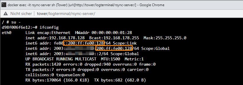

But I found a solution for this!
We enable the advanced view and pass the "--mac-address 00:00:00:00:01:28" as extra parameter:
While in the fixed IP address field we only set the IPv4:
Again, additional IPv6 are added based on the mac-address and our container is permanently reachable through the suffix "200:ff:fe00:128", even if we need to delete the docker.img!

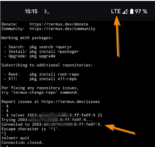

I tested it with an rsync-server container and made it public through port 22 (never forward this port, this is only for testing!) in my router and it works flawlessly:
Thanks @Omri for the inspiration!
