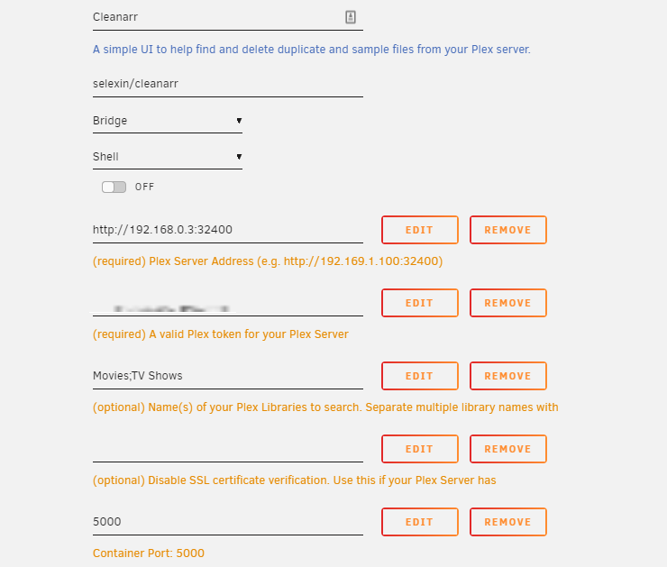

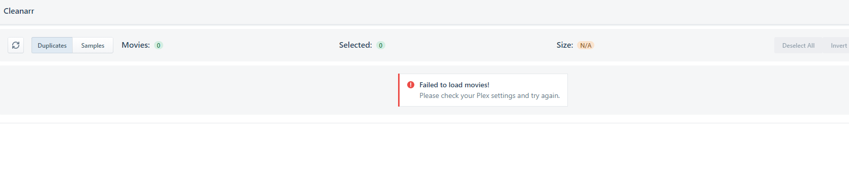

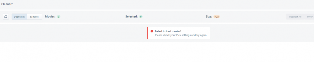

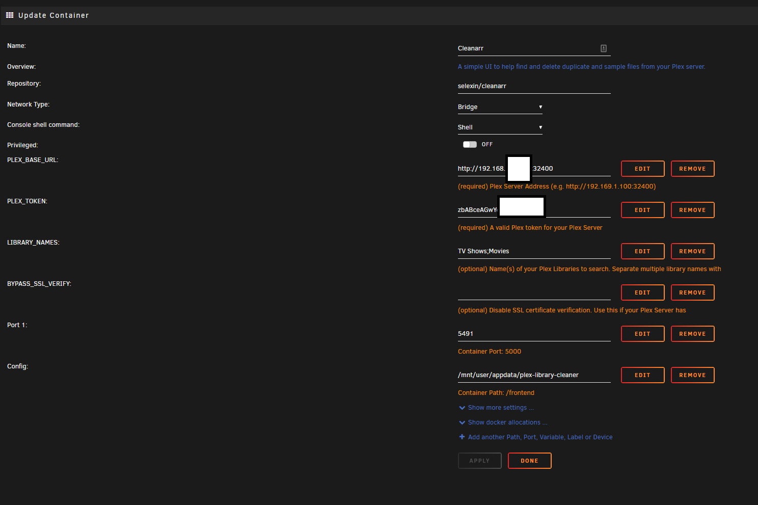

Looking for some clear understanding of what I am putting in wrong. I am unable to get Cleanarr to load movies (see error below) no matter what settings I put in
These are my settings at the moment or which I have tried having just Movies under Libraries and 1 under ByPass SSL. I also pulled my token from my Plex of which I have used before.
Any ideas of how I can troubleshoot this? Not much in the way documentation just yet for this to review.
Take out the "TV Shows"
If you read my posts here and a few others, it seems like spaces (or something else) is funky and won't work. I have the exact same 2 libraries I want to scan, but TV Shows doesn't work - even by itself. Movies by itself works fine though

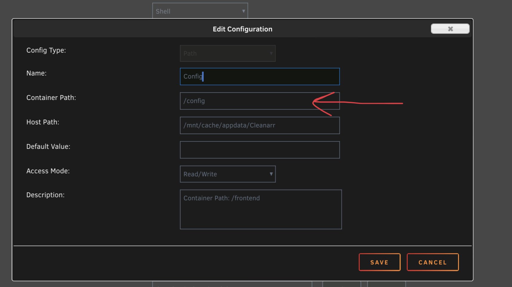

EDIT: Seems the latest build changed the config file path from /frontend to /config, update your docker container path and it will work.
This error has popped up. I changed my appdata path from /mnt/user/appdata to /mnt/cache/appdata to bring it line with my other containers and this error appeared. I switched the config path back to the original but the error persists. I also deleted the container and xml from CA and reset up the container from scratch but the same error persists.

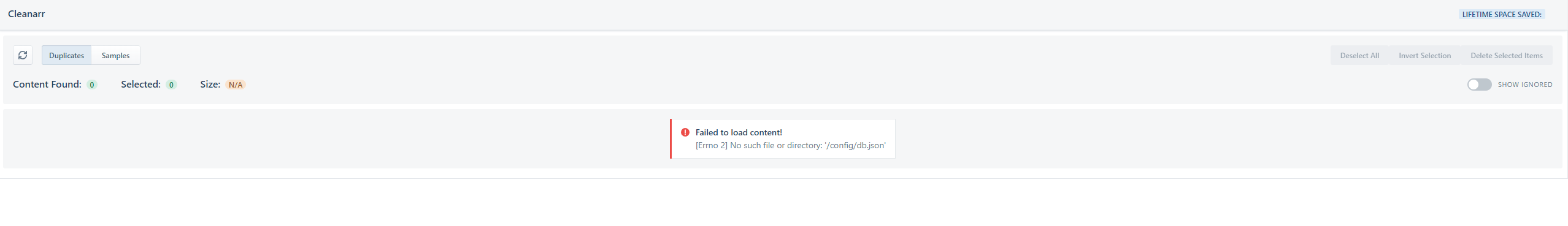

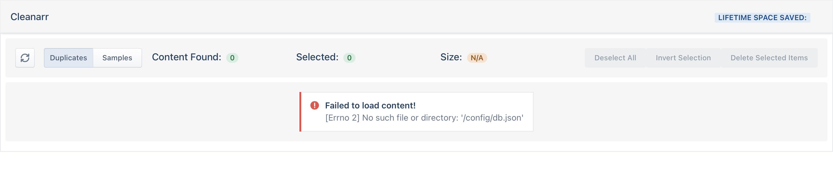

I was able to use Cleanarr without issues for several weeks. Opened it up today and all i see not is " Failed to load content! [Errno 2] No such file or directory: '/config/db.json'"
I have tried to remove and reinstall, moved it to another Unriad server in my rack and got the same. When I open the Plex-Cleanarr folder it is empty. What changed or what am I missing here?

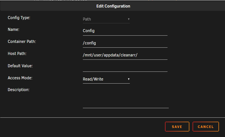

There was a change to the configuration for the docker they are now using /config instead of /frontend
you need to click the edit button as per the below:
And then rename /frontend to /config
It should work after that
tried above edit and didnt work in firefox strangely enough but did work in Edge

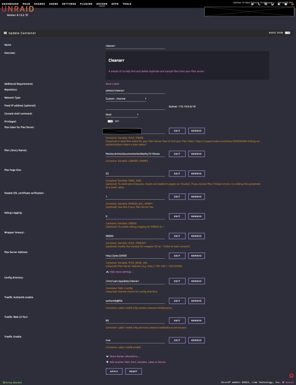

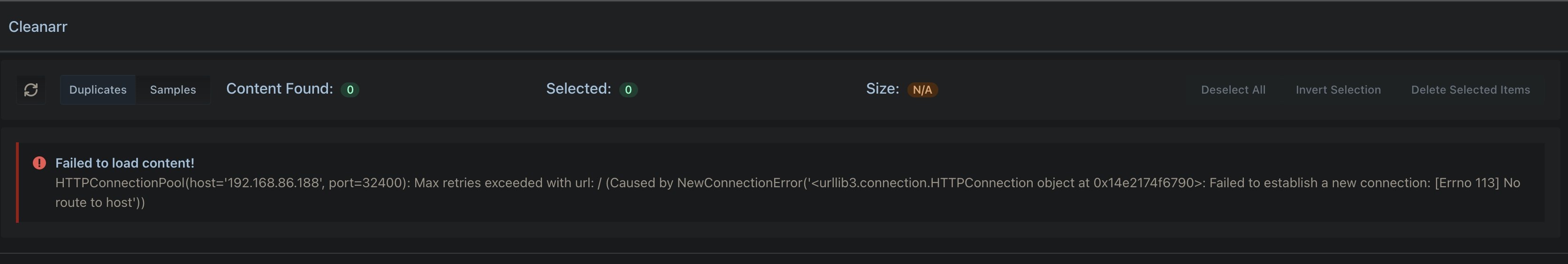

I can not get this to work at all. It will load the webgui with no issues but I get
I have tried everything mentioned in this forum topic and nothing works.
Ok so I changed the network type from my custom docker network to br0 and now it shows My plex server name in the upper right corner of the webgui but im still getting the same Failed to load content! error.
Edit for misspellings.
