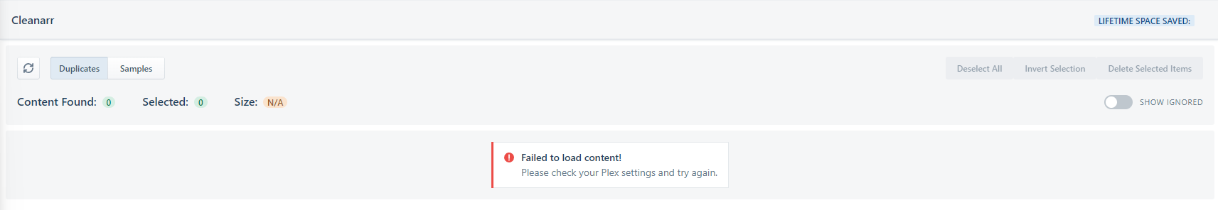

I just tried installing it and I just can't get it working. I also tried both the /config trick and changing the network¨settings to a dedicated IP and I keep getting
Failed to load content!
Please check your Plex settings and try again.

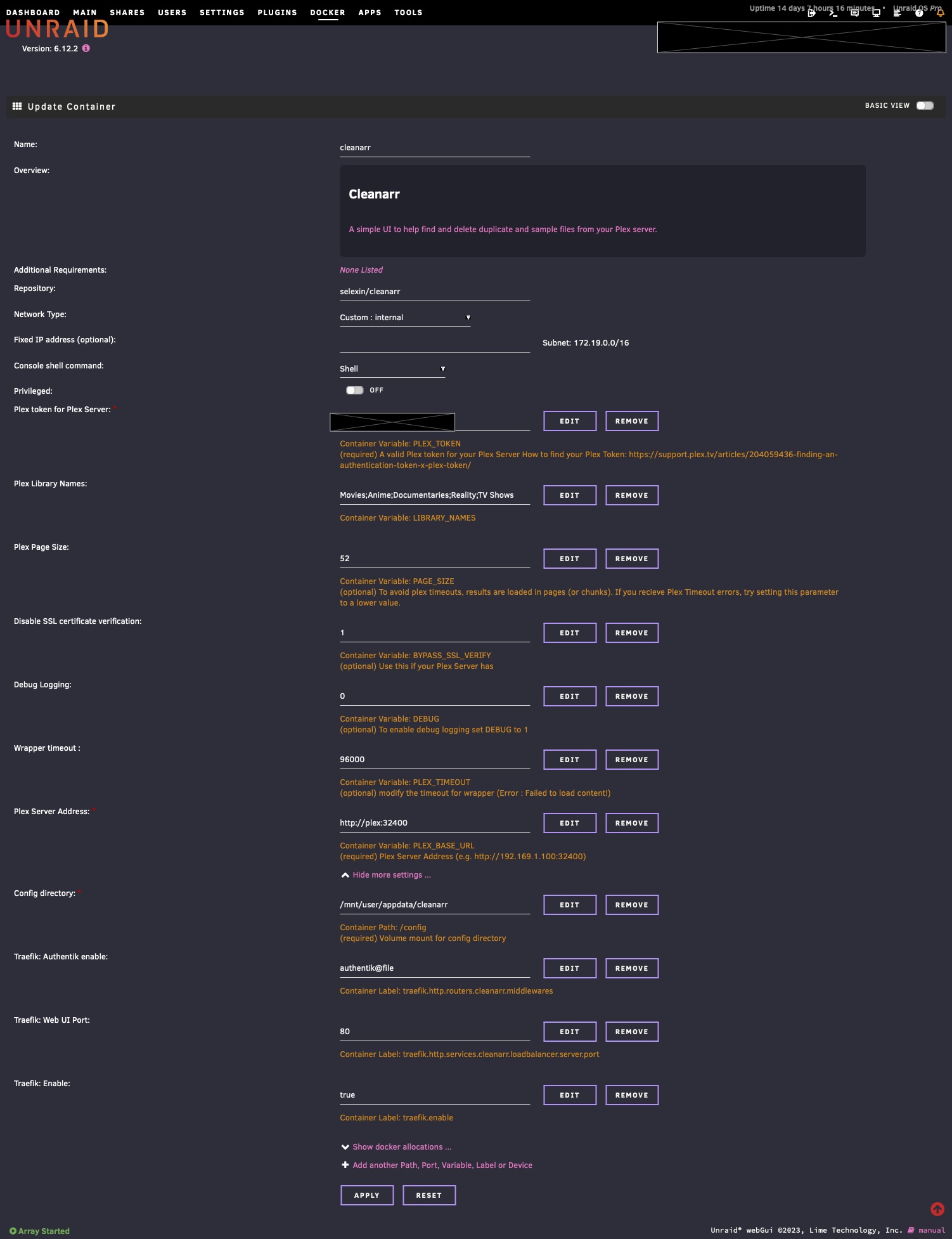

Here are my settings @eagle470, I hope they help you out.  Some things to note...
  • I access the app via a FQDN, eg https://cleanarr.mydomain.com that is served up using Traefik.  Because of this, I don't expose a port to my LAN, only to the internal docker network.  You may need to expose a port to your LAN to be able to access it.
  • I also use an SSO authentication server, Authentik, that ties in with Traefik, so you may not need my last three "Traefik" settings
  • My Plex server's docker container is called "plex", so I address it on the internal docker network as http://plex:32400 .  The only downside for doing this is clicking on the Plex server name in the top-right of the page doesn't work for me, but I can live with that.
  • If you're getting "Error : Failed to load content!", change the setting for the wrapper timeout (PLEX_TIMEOUT)
  • If you're getting Plex Timeout errors, then look at the Plex Page Size (PAGE_SIZE) setting

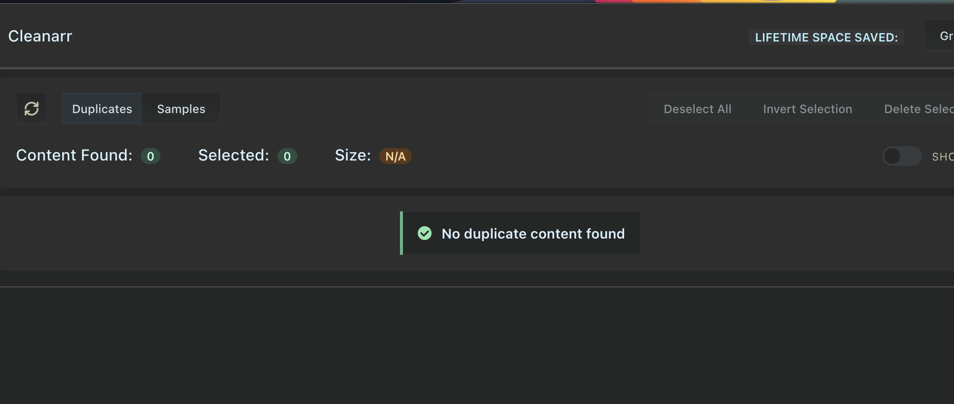

I've got it connected to my server but it says no Duplicates found, which is certainly not correct. There seems to be no logging or error recording anywhere. has anyone figured out how to make it... go?

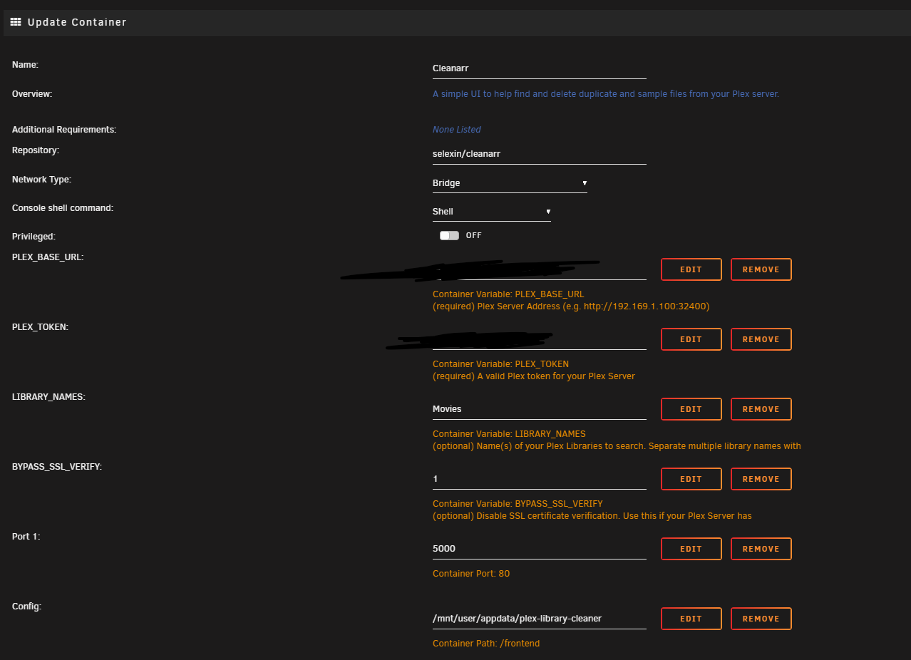

  • 2 months later...
I'm was having the same issue as many others, I changed the path in unraid from frontend to config - and still nothing.
Then I deleted the entire app..  and during INSTALL of the application, i had to change the "frontend" to "config"  - you cannot change it after the fact!!
Hope this helps someone else!
