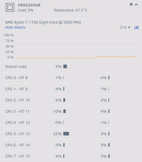

August 17, 20215 yr For low power part, in general you will got some low TDP CPU, but I also won't agree, because this just waste $$ and limit system in rather lowend result. Intel CPU have power control feature, you can set the power usage in full power i.e. 28s then limit to 65w, so the concept likely a time limit turbo mode. The only need is you found a mobo BIOS support this. My desktop was ITX with 9700K, it will run in 28s Turbo ( > 200w ) then limit to 65w, average power usage was 60w. My 7x24 Unraid ITX build was AMD Ryzen 1700, nothing power control, but keep in low CPU usage, average power usage was 50w. ( stock cooler + one 10GNIC + two 3.5 disk + one 2.5 SSD ) And both system also quiet enough. Edited August 17, 20215 yr by Vr2Io

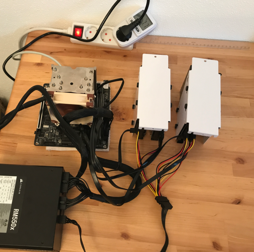

August 19, 20215 yr 9 minutes ago, bdee1 said: Thanks for this! I do prefer to buy new parts if possible. But it if fits the bill I could always look at eBay. one question though - it looks like both of the boards you recommended are microATX, but the case I have (fractal Node 304) is MiniITX. Any recommendations for similar boards in the miniITX form factor? The attach photo should be C246N-WU2, a ITX mobo.
