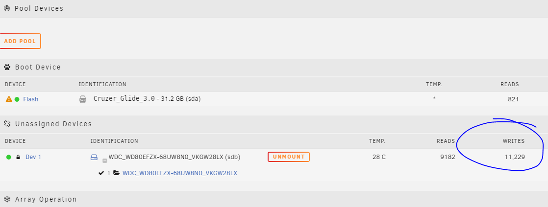

11 hours ago, Alex.vision said:
Did these writes potentially invalidate the parity
Any writes will make parity out of sync, UD supports read only mode, this will keep parity in sync, but it's not possible to use if the disk needs a filesystem check first like in this case.
That was what I was afraid of, oh well guess some data loss is better than all data lost. I did try to run old disk4 in the test server but the drive is not detected by the OS for more than a few seconds. I can see the drive on the Main page, but within 10-30 seconds the drive disappears completely from the main page. Im guessing that drive is failing a lot more than it was.

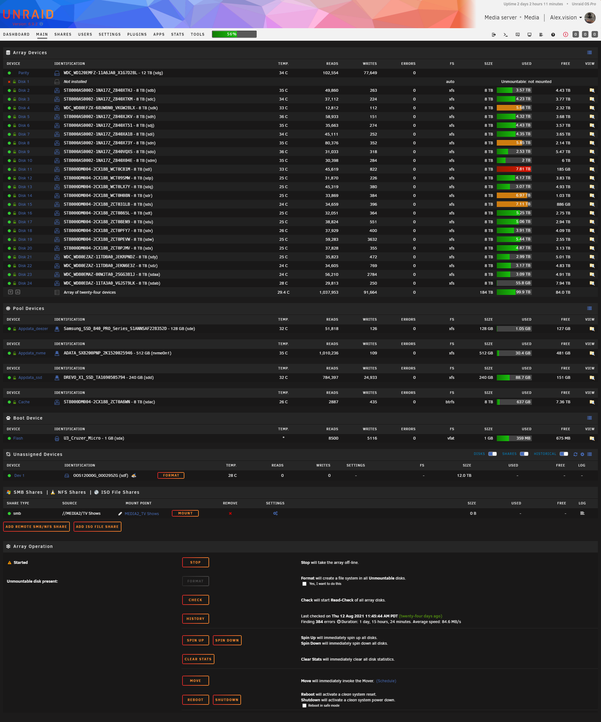

I followed the steps listed above, the array does start and if I hover over the red "x" for disk1, it says "Device is missing (Disabled), Contents Emulated".
Where it shows the drives size, file system and the folder icon to view the drives content, it shows as Unmountable: not mounted. So it looks like I will need to do some file system repair.
Attached are the requested files from the previous post.
alex.vision media-diagnostics-20210905-2226.zip

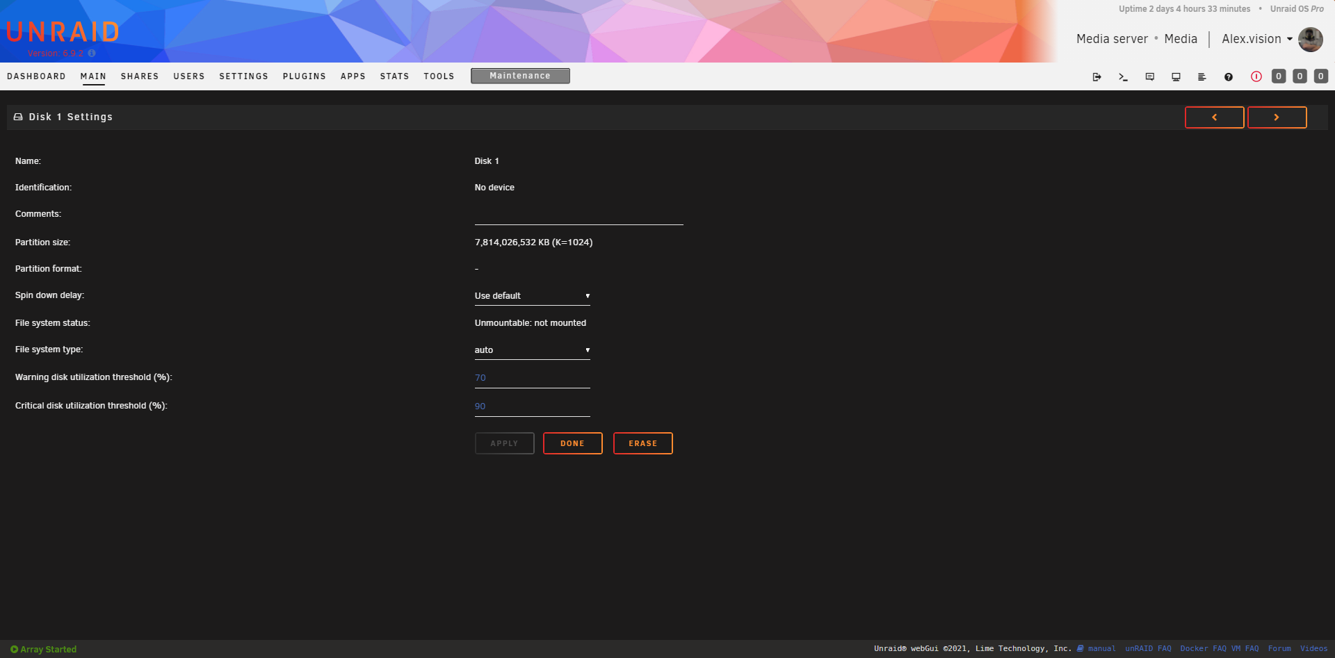

Im not seeing the Check Filesystem Status option in the GUI, everything after the basic disk information is blank.
1058646584_Alex.vision-Media-CheckFilesystemStatus.thumb.png.9cbd3c21506a8e25801277884a7a0716.png
Click on the disk and set the filesystem to xfs.
Should I set it to xfs - encrypted as that is what all my other disks are, or does that not matter for this emulated fs?
If it is encrypted yes.
Setting the disk's filesystem to xfs-encrypted, made no difference.  I was unable to click apply after making the change.
I tried to click done, but the option box reset to Auto as soon as I refreshed the page.
Any other options?
That's strange, it should work, but you can always run xfs_repair manually after starting the array in maintenance mode:

Once I start the array and verify the disks emulated contents, I assume I should stop the array and add the replacement disk and have it rebuild disk1.
Assuming you mean to assign the replacement to the disk1 slot and not add it to a new slot, yes.
Yes, that is what I meant, thanks. When I get off the ferry I will log into my server and make the change. I will post the results from that.
