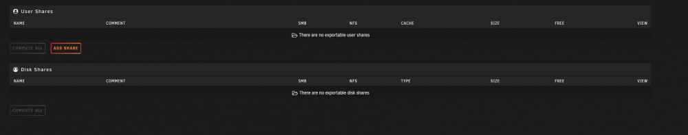

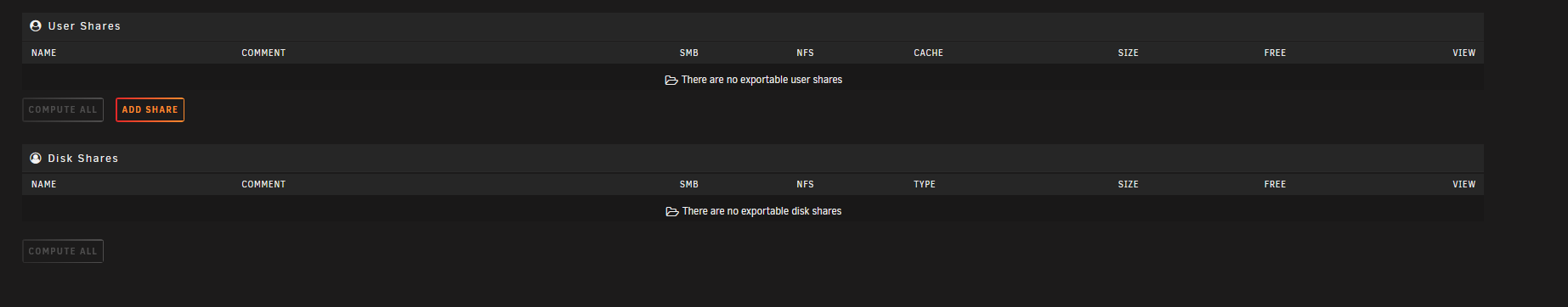

I think I've narrowed it down, I've wiped and re-installed my flashdrive back to 6.9.3. I've rebuilt all my docker containers (I also use the vm/docker folders plugin) when on 6.9.3. Then, I upgrade (causing shares's settings to disable). I then re-enable the shares. All shares, disks and folders go missing.
Trying from a fresh install using the windows flash creation/installation tool, I install 6.10.0-rc1. This time, enabling the shares appears to work. Next, the docker container's show they are errored, and that the images are missing. I delete and re-download them. Once completed, after a short time, my shares appear to go missing... I'm also running parity re-build in the background since it's a new OS, and I happened to add two drives.

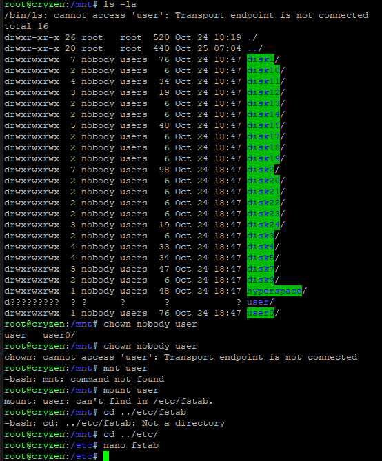

Edit: I just realized my "user" folder has gone missing... what could cause this?
cryzen-diagnostics-20211025-1004.zip
So, I'm guessing something happened to bzmodules or something? and the user mount is unknown now? IDK, I'm too n00b to figure anything else out, I'll wait for a senior.
