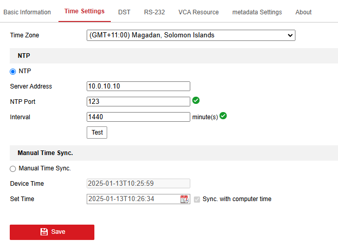

January 12, 20251 yr On 7/26/2023 at 12:34 PM, Batman said: Any ideas why my camera can't set itself from my server? They're both on the same subnet and I'm not aware of firewall rules that would block the connection. The camera already provides video to the server. Did you end up figuring this out? I have the same issue, although across VLAN's, but cannot make it work - tried both the servers domain name and IP Address.
