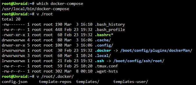

In unraid 7.2.4 the docker-compose file doesn't appear to be executable and chmod +x doesn't make it executable.
Any idea why?
Where is the compose file located? Why should it be executable?
I don't mean a yml file, I literally mean docker-compose the executable. it lives in '/root/.docker/cli-plugins' when it's not executable the docker compose command fails.
other than the docker-compose command failing and giving the usual that's not a docker command error if you use the web ui to try bring up a stack you get:
'Invalid Plugins:
compose failed to fetch metadata: fork/exec /root/.docker/cli-plugins/docker-compose: permission denied'
I don't know how your stuff got messed up but I don't think it's from this plugin, everything fine here.

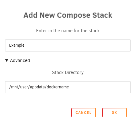

that depends. did you set teh stack setting at creation?
Example:
at creation your able to spefic the path where the .env envioirment file and docker-compose file exists.
if you already made the stack by editing the stack document the plugin tells you where the saved file is:
example immich
I set it to:
"/host/Dockers/immich/docker-compose.yml"
permsion should follow unriad docker safe permissions of chmod 777 and chown nobody:users. unless specfic docker permision are mention and applied.
IF YOU DONT set the advance specifed location I believe it defults to the unraid flash drive somewhere in the plugin directory found somewhere in /boot simlar when you save the stack UI lables of the docker-override for the stack that the plugin auto adds now. This is what sets the runnign dockers at the top to be and say dockerman, have the icon and ui web link if set.

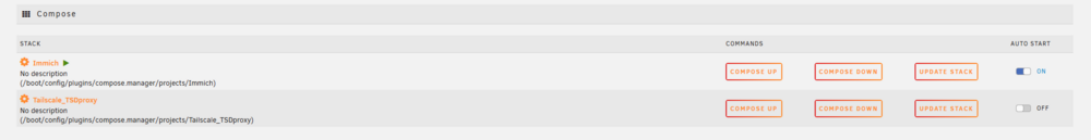

root@OMV:/boot/config/plugins/compose.manager/projects# ls
Immich/ Tailscale_TSDproxy/ version
root@OMV:/boot/config/plugins/compose.manager/projects# cd Immich/
root@OMV:/boot/config/plugins/compose.manager/projects/Immich# ls
autostart docker-compose.override.yml indirect name

4 minutes ago, dxch said:
hrm interesting, yea I think you're right. There must be a conflict here from something else I've tried to install in the past.
Thanks I'll clean it up.
Yep worked it out, I attempted to setup WebODM via the .sh file provided on the projects github which attempts to install docker-compose as a docker plugin. I realised that wasn't going to work on unraid so moved on to setting up this plugin to run WebODM via compose but I didn't realise it had created that directory/file.
Now that I've deleted the extraneous file all is well.
Thanks for the screenshot of your .docker directory @Kilrah this is what I needed to get this working.
The good thing with Unraid is for stuff like this you can just reboot and it'll be all cleaned up :D
