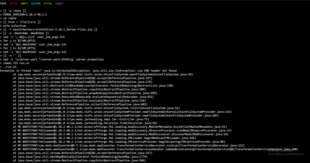

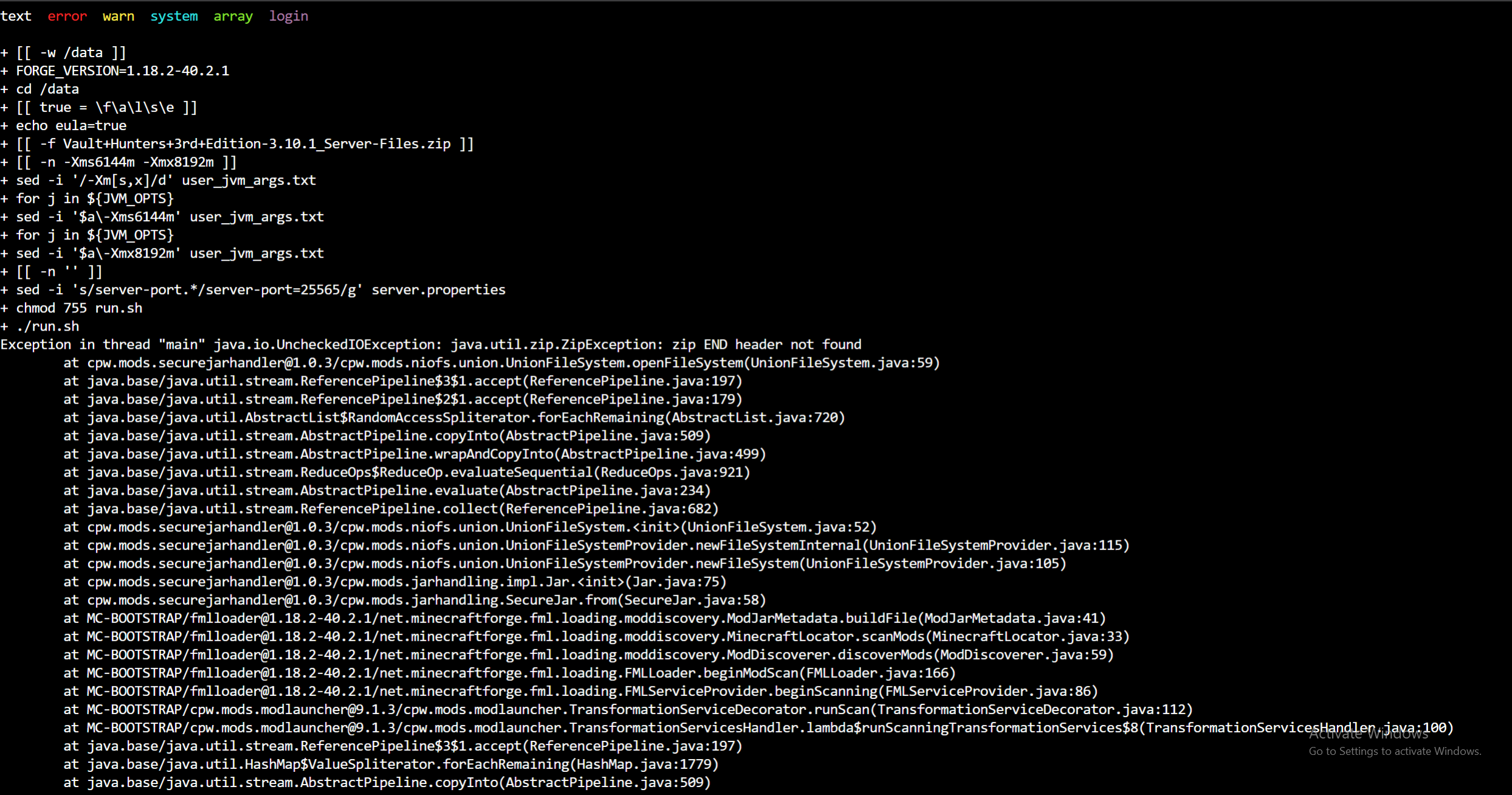

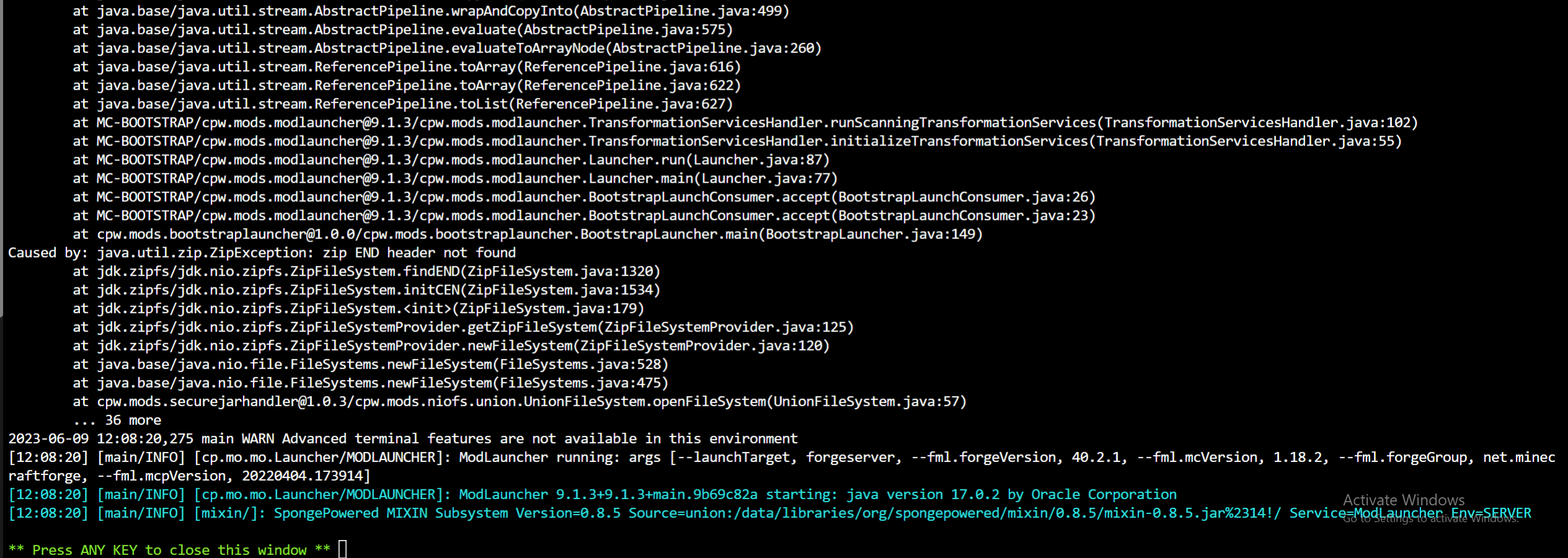

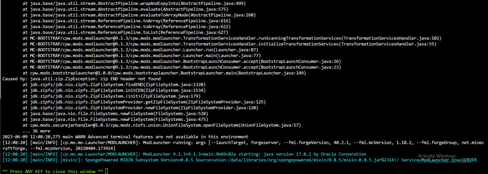

I let the docker for VaultHunters3rdEdition update and it does not turn on any more, the last version it was working with was Update 10.0.0 what ever the latest one did broke my docker.
I don't understand what went wrong and updating the version back to 10.0.0 did not fix it
Looks like it failed to download and install properly.  Just delete the `Vault+Hunters+3rd+Edition-3.10.1_Server-Files.zip` file from your /mnt/user/appdata/vaulthunters3 directory and start the container again.  It will download and attempt to re-install.
